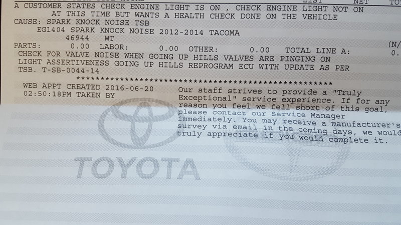

    They tried saying it was the "Taco Tic". I told them it's not that, even a non car guy knows the taco tic. The master tech is taking it out for another test drive. It's been sitting in the garage on the side for 2.5 hours not being touched or looked at. WTF???

    What does your noise sound like?
    My truck sounds like a goddamn 19th century Singer sewing machine. I have a tick, a clack, and a low end knock 100% of the time and it all gets worse when it's cold. North Hills told me it was all normal three times while my truck was under warranty. That was 30k+ miles ago.

    I never told them that the CEL was on but the master tech finally pinpointed the problem with this noise. I still get the oil pump noise in colder temps. I told them to check to see if it needed to be refreshed a year and a half ago, they never did. This technique checked it this time after I suggested it again. The noise sounded similar to what you're description is on yours.

    So there was a tsb on the knocking?!

    Yep, he reflashed the computer. I think they heard me talking to other customers saying to go to another dealer and that I was going to call corporate.
    I told them about it 1.5 year ago when this noise started. The tech didn't do anything, said he didn't hear it back then.

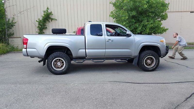

    So I did a thing today and installed my OME Lift kit on my 2016 SR 4x4 5 speed! Thanks to@ramonortiz55 group buy, had to wait 2 months for it but it was well worth the wait. Here is the list of parts cause I'm sure people will ask what I'm running! And a big thanks to @MidnightRebel07 for spending most of the day helping me installing it. I owe you big time!!!!!!
    Just on the 5 mile ride home from work I can tell that the ride is so much better than the stock suspension!!!
    Lift numbers center of hub to bottom of fender:
    Stock suspension:
    Front: 21"
    Rear: 22"
    OME Lift suspension:
    Drivers Front: 23.75"
    Passenger front: 24.00"
    Drivers rear: 24.75"
    Passenger rear: 25.00"
    Tire size 265 75 16 Goodyear Wrangler Duratracs Load Range C
    OME Suspension Kit
    887 coil springs
    Nitrocharger struts and rear shocks
    Dakar Leaf springs
    OME differential drop kit
    OME 5mm taco lean spacer
    Low Range Off-Road 2" extended stainless steel brake lines (These are a must if you are installing dakar leafs cause you need the extra length to just install the leafs :rofl:)
    Light racing upper control arms from @HeadStrong Off-Road
    @Wheeler's Off-Road sway bar relocation brackets
    @Wheeler's Off-Road stock upper control arm bolts
    [​IMG][​IMG][​IMG]
