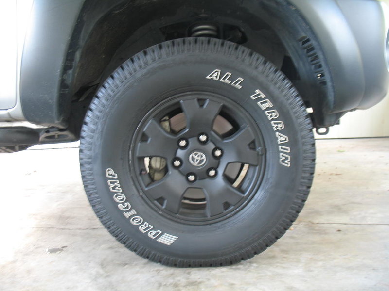

    I like the black badges. How'd u do it

    Taped off around the badges with painters tape and newspaper. Then sprayed a light coat of plasti-dip. Then 2 more normal coats. Let dry 30 minutes after 1st coat. Then 10 minutes in between the next two coats. After fully dry, peel off excess plasti-dip with tooth pic. If any gets on the paint of the car, use goof off to remove. If you don't have any, scrub hard with a wet washcloth.

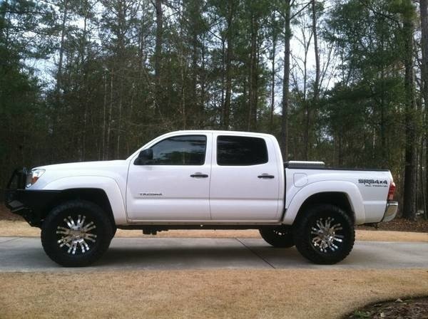

    Thanks for the run down on the badges. This is my build and I want to black out all the chrome. image.jpg
    Would the same thing work on the toolbox and rear bumper

    Great looking truck. I would plasti-dip the rear bumper as well. But for the toolbox, I would hit it with a coat of rustoleum primer and then rustoleum bed-line it. My brother did this for his toolbox and it looks sweet. The wear and tear that a toolbox receives might be a little to much for plati-dip to handle.
