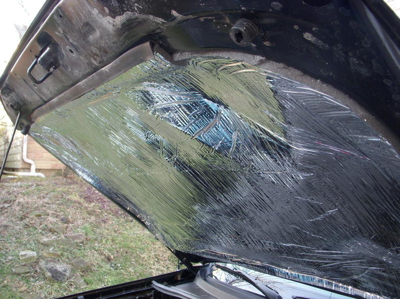

    So, I purchased a thermo-acoustic hood liner from parts-express.com, in an attempt to muffle the notorious 'tacoma tick' that i hear from 1,500 - 2,500 rpm when accelerating up a grade.
    http://www.parts-express.com/pe/showdetl.cfm?Partnumber=268-280

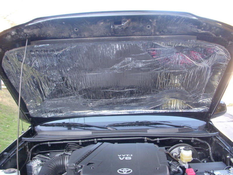

    The install was pretty straightforward, consisting of 1) cleaning the underside of the hood, 2) lining up the hood liner, so as not to cover the drain holes, 3) getting someone to help with holding the liner up and applying it, 4) starting at the bottom (closest to the windshield) and working your way up, adhering the liner to the underside of the hood, and finally, 5) trimming any excess liner.
    Attached are pics of the finished install.
    I have to say, the truck is a lot quieter at idle. I do still hear the "tick" under acceleration, but it's a lot less noticeable, making it easier to live with on a day-to-day basis.
    Tip: Use a straightedge or other flat guide for trimming the top of the liner where it meets the weatherstripping at the front of the hood. I did it without a guide, and it came out looking pretty bad. Fortunately, I added another strip from what was left over to cover it up, and it looks a little better. (The strip is what is seen in the second pic.)

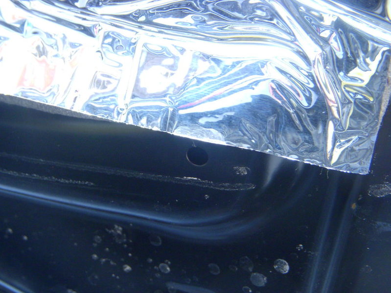

    I took a pic of the drain hole at the lower right hand (driver's side) of the hood that I took care not to cover. There are three or four of these on the hood.
    Finally, I covered up the windshield washer hose. Some of you may want to cut this out and route it around the liner.

    I got the idea from another taco owner who has been using this product for a while and liked the results. I don't think it's going to make a difference with engine temp -- if anything, it'll get up to operating temperature faster, which could actually be better for the engine. Right now, it runs at exactly the same temp as before. I'll have to wait and see if there's any difference when it's really hot out this summer.
    I don't hear anything noticeable coming through the firewall. I took a look at my '97 taco, and saw that the hood was lined with insulation from the factory as well. I think that Toyota, for some reason, just stopped doing this with their hoods. Anyway, I'm happy with it.
