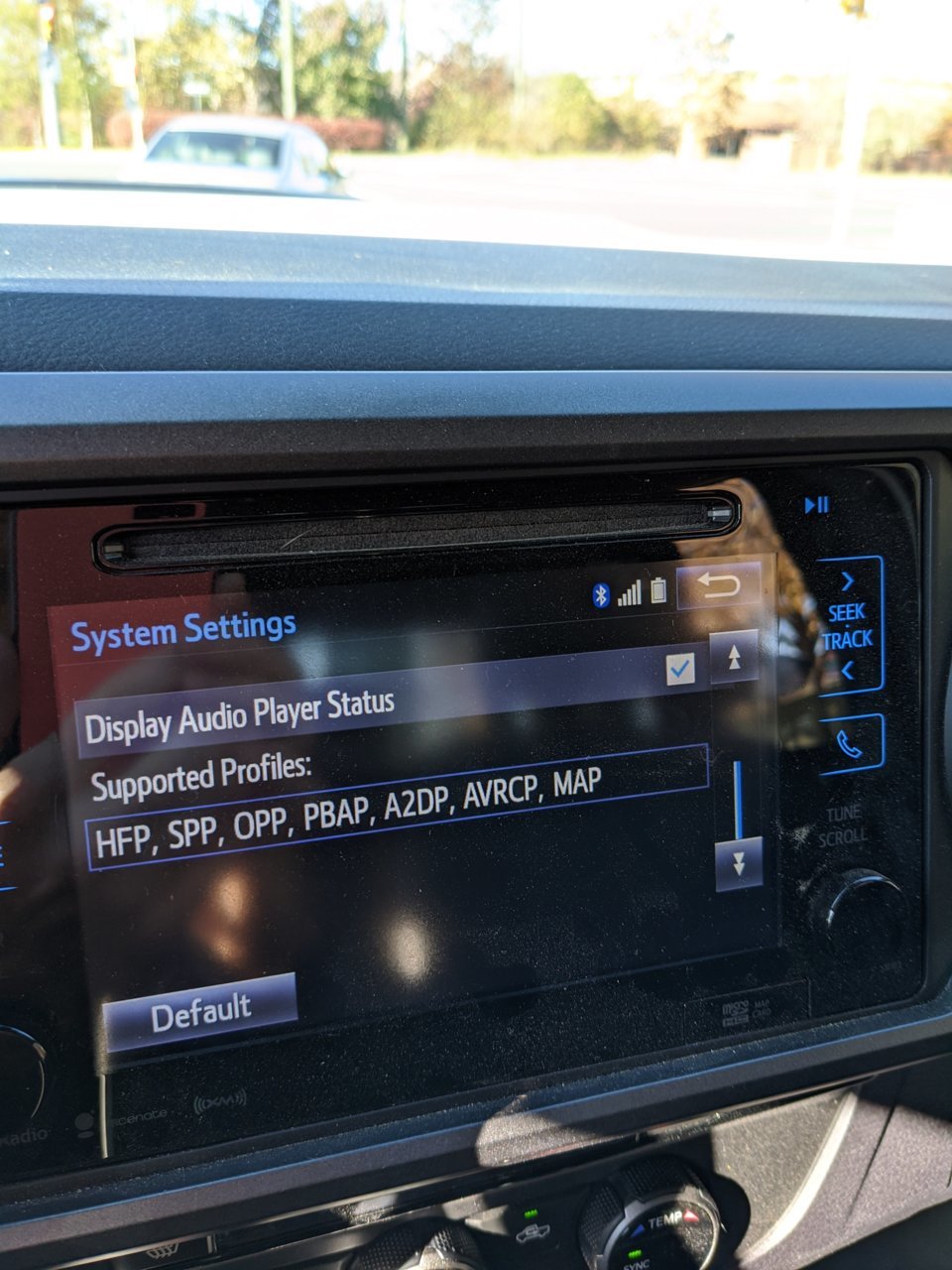

    Anyone have a pixel 4 and a 3rd gen?
    I've noticed that the reception almost always says "no signal" on the radio while having good reception. Resetting the radio sometimes fixes it. I didn't have this problem with a pixel 2.
    Anyone have a pixel 4? Are you having this problem or not?
    I think this type of data is sent on Bluetooth HFP
