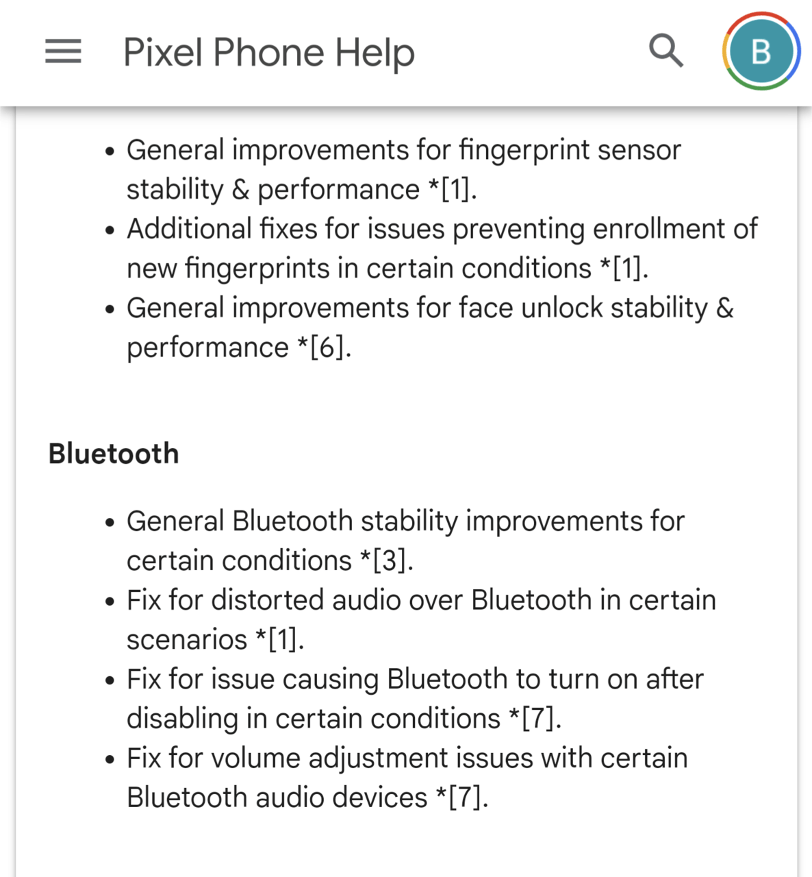

    Cool_Calm_B
    Cool_Calm_B [OP] Well-Known Member
    Aug 20, 2020
    #338286
    62
    Bryan
    Anchorage Alaska
    2017 Inferno Tacoma TRD OR
    Looks like the update is rumored to come out in the next few days. According to Google, it addressing some issue with Bluetooth but we'll see if that's the fix for Toyotas ↓↓↓
