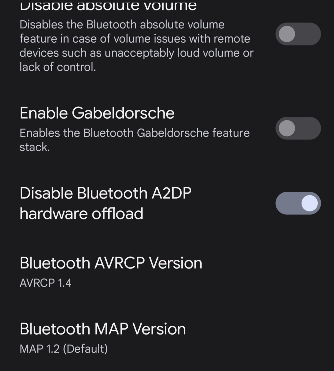

    2014 Tacoma with Entune paired with Pixel 6 Pro (on November firmware) and calls dropped like crazy. I tried a bunch of stuff and changing AVR CP version to 1.4 is what ultimately solved my problem. I tried a couple of other things suggested on reddit, and someone even sent me the latest Entune firmware, but ultimately after trial and error I tracked it down to AVR CP version 1.5 and higher causing problems, but version 1.4 worked. Interestingly enough, my Pixel 3a was set to AVR CP version 1.5 and didn't have any problems

    Just went into developer mode and switched it down to 1.4 so we'll see if that works. I tried what @Willdesign78 suggested about driving modes but unfortunately my call still drop off the Bluetooth after changing those settings.

    I saw on a reddit post that enabling Gabeldorsche in the development settings might be able to correct the issue but at this point, I'm not holding my breath. Hope someone has done the update and seen more success than me.

    Enabling Gabeldorsche only works until the next phone restart, then it goes back to the default disabled state. It's a newer implementation of the Bluetooth stack on Android

    I have been trying everything to fix the problem (well, I haven't replaced my radio), but I've gone through a dozen options like A2DP, Gabeldorsche, AVRCP, etc.

    I have had this maddening issue ever since upgrading to the Pixel 6 Pro. I had a Pixel 2 XL before and had zero issues. I have tried every troubleshooting option in this thread, and nothing worked, EXCEPT for leaving my screen on during calls. If you're still having the issue, I recommend trying that. I'm not sure if these Developer Options help, but I have these settings changed from default as well.
