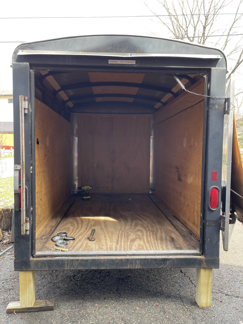

    Here is what I'm starting from:10359EEF-133B-445C-BB25-4EDA2F8ABF1C.jpgFB8A18CB-AA82-4997-9A12-FB2B9375401B.jpg

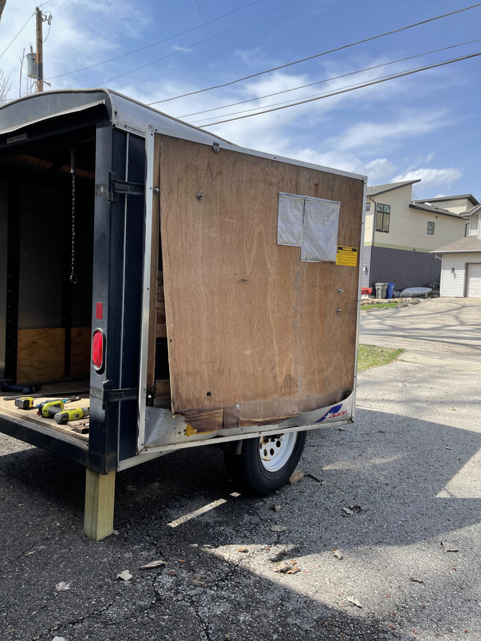

    The back door was damaged when a semi backed into it, so making a new one is job one.1B49E803-76B4-4D39-ACEC-7981D51A7E45.jpg

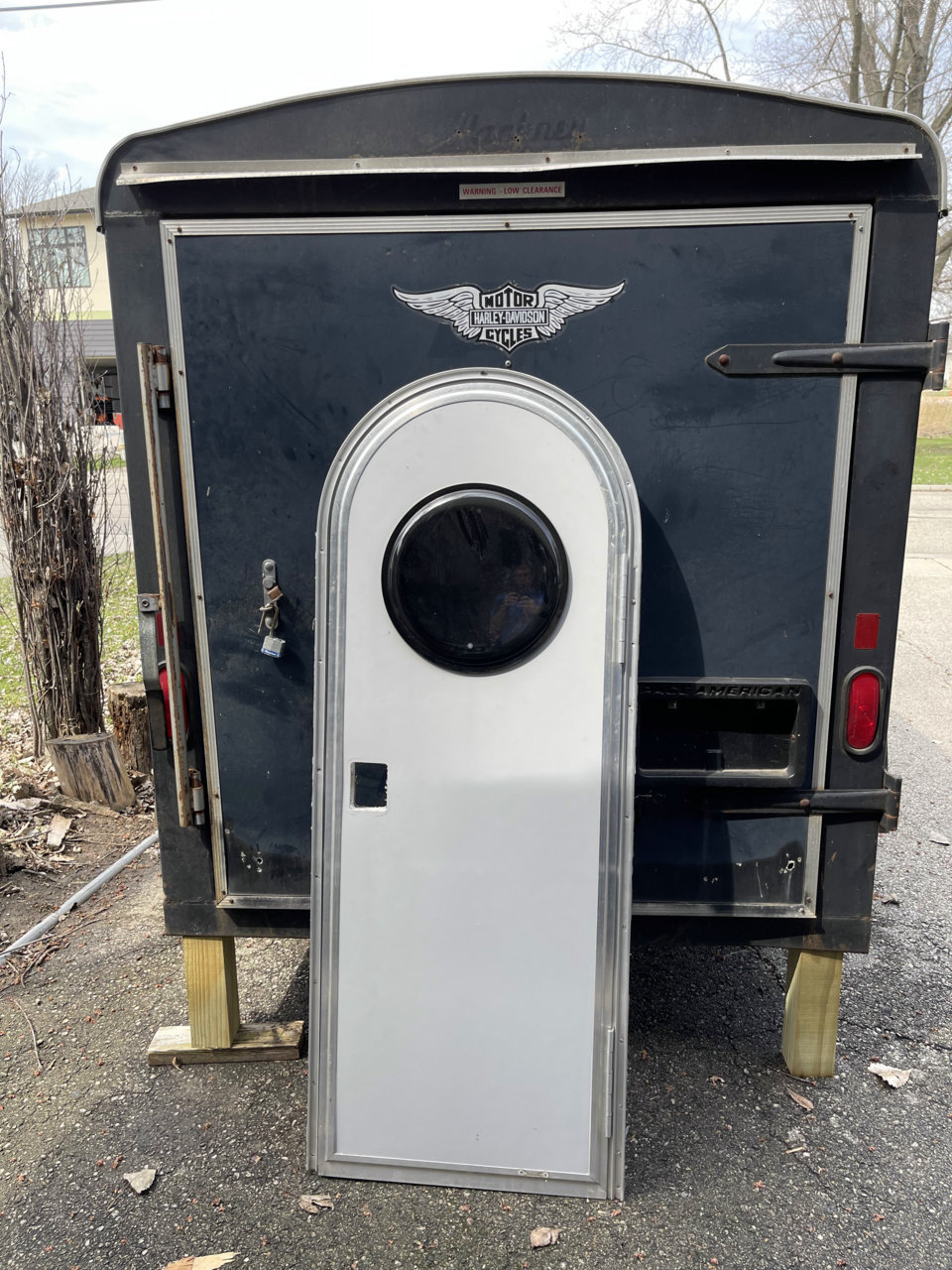

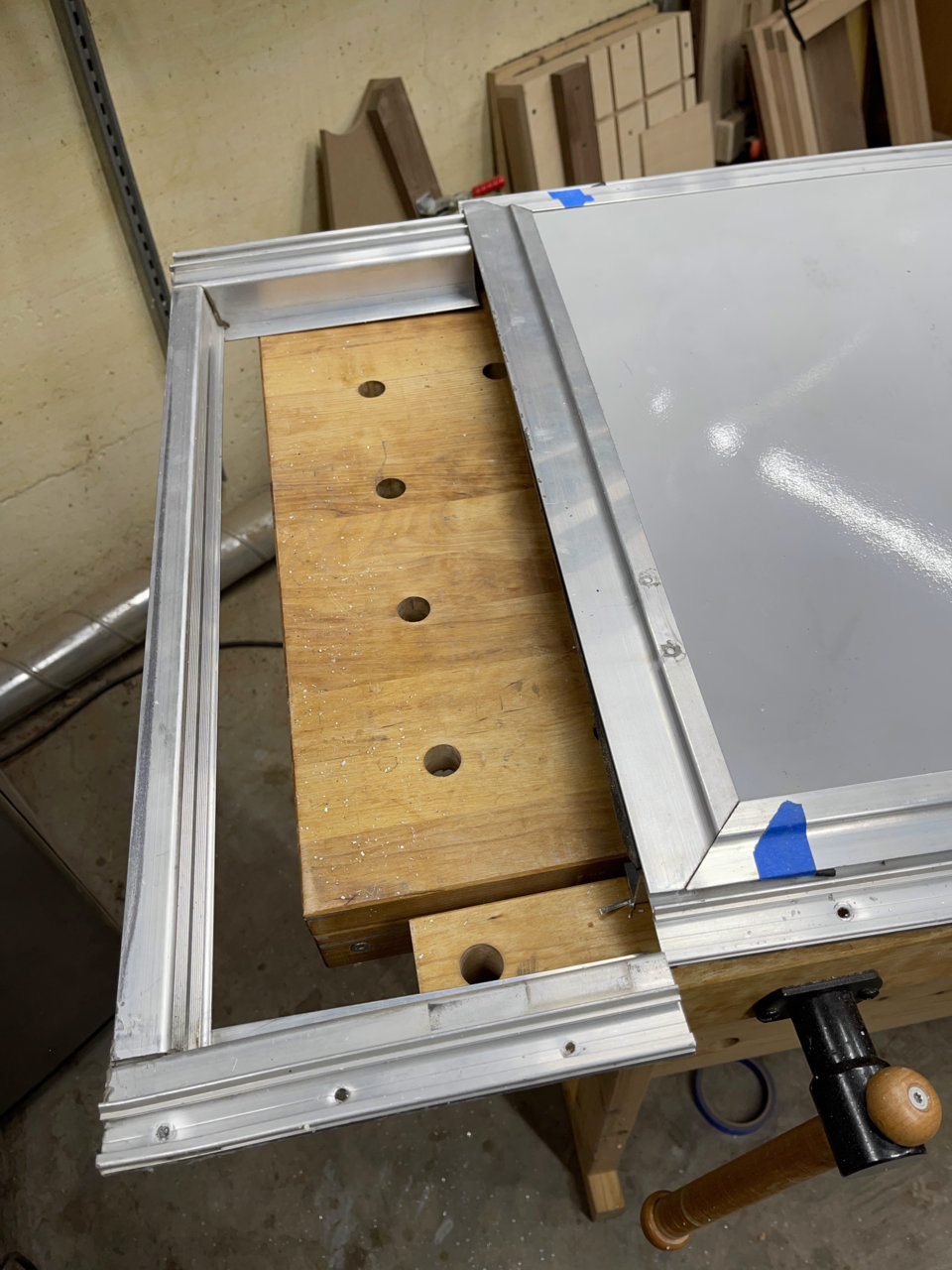

    I found a deal on a used camper door, and since I'm making a new rear door, it seemed easiest and best to just put in into the rear door, that way I have the option of opening the large door to move in larger items, or just used the camper door for normal use, that will reduce the amount of mosquitos getting in.

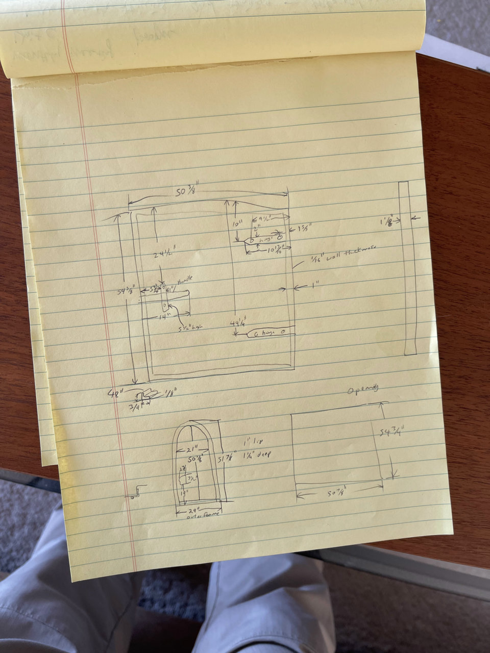

    I needed to shorten the camper door to fit:
    And yeah, I did do a bit of planning....

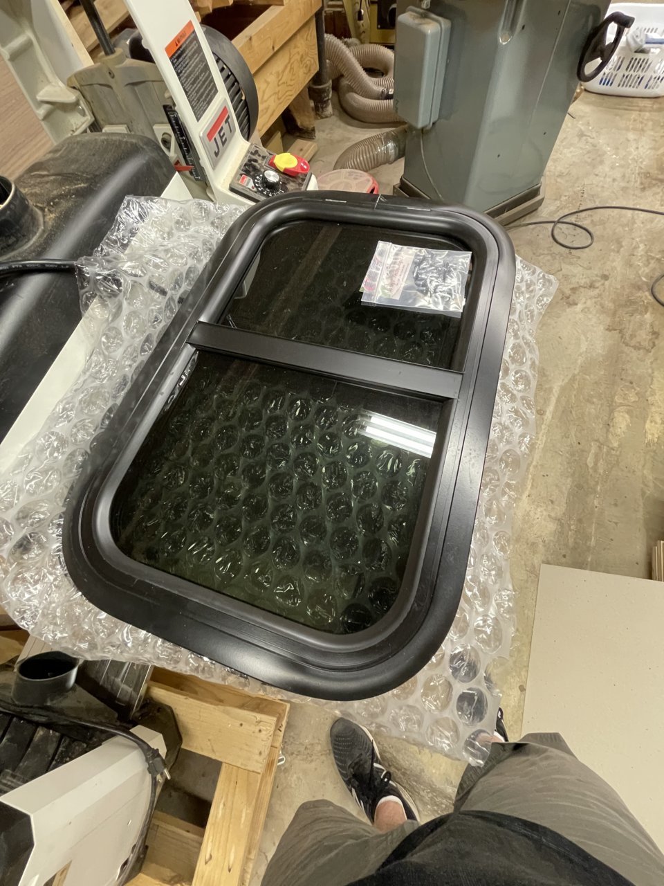

    Oh, I already have the windows! I just need to install them. I have a 14”x22” for each side. Being tinted with black frames helps keep it low key.

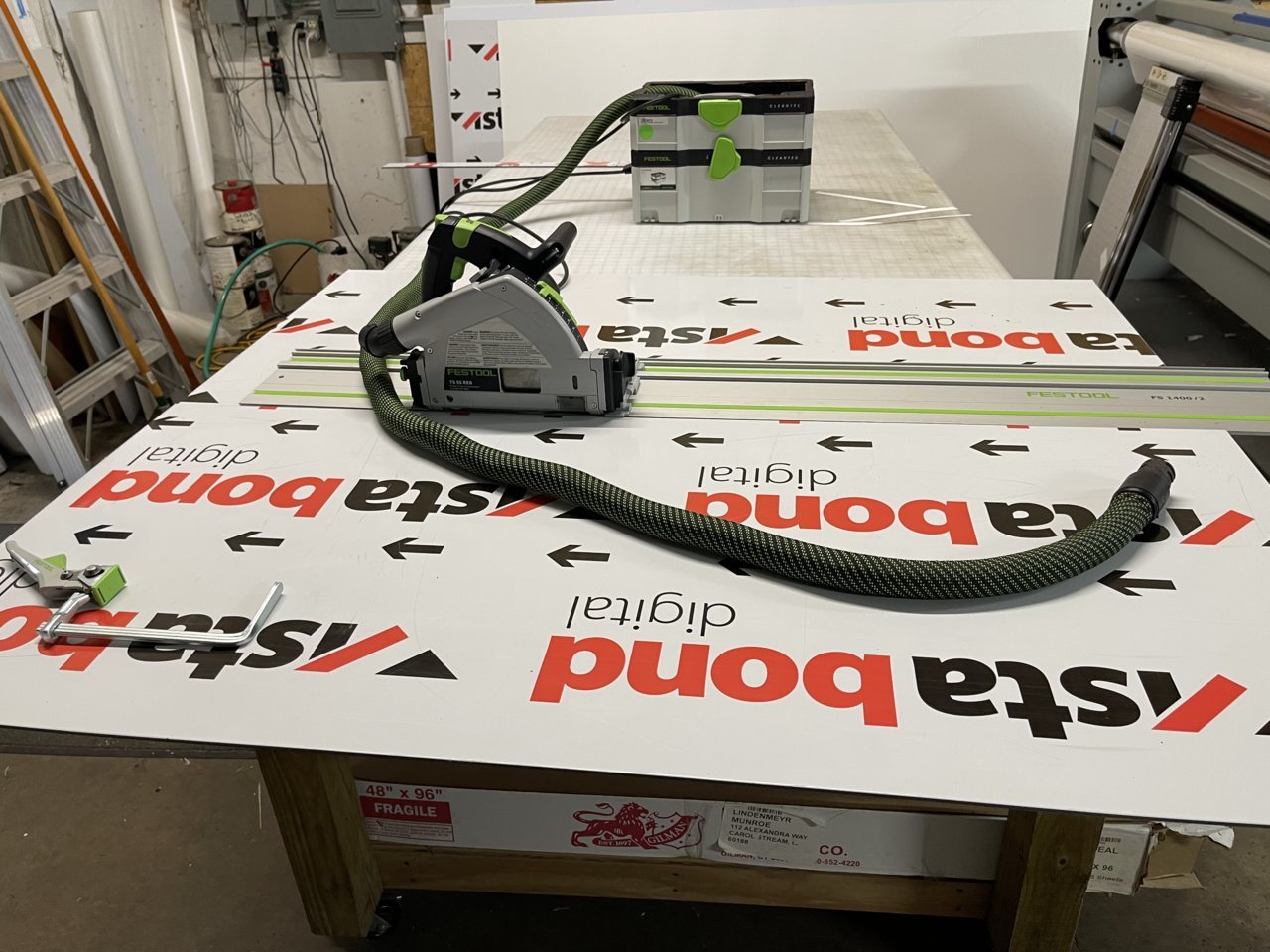

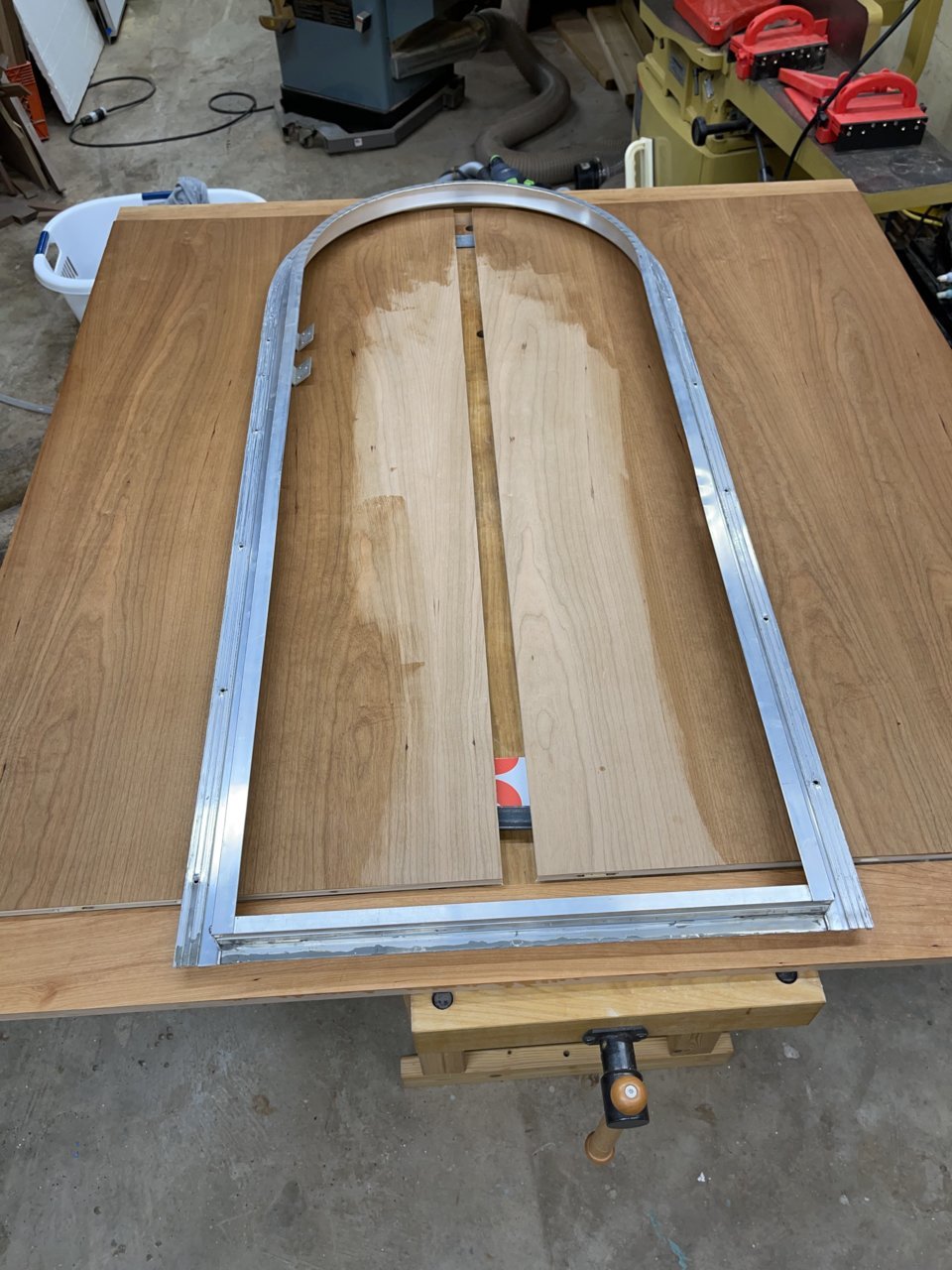

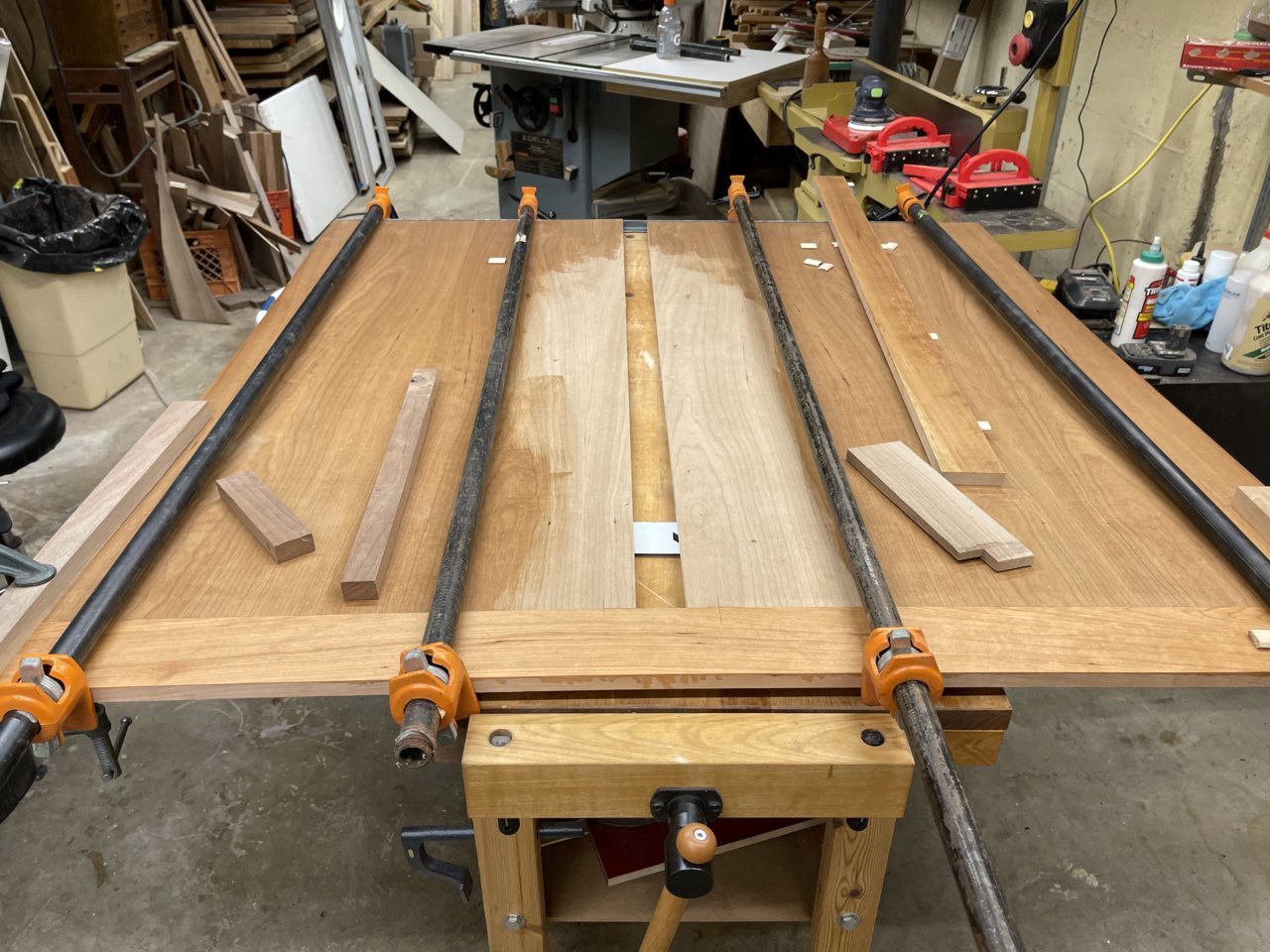

    Getting ready to trim out the outer skin for the new back door.

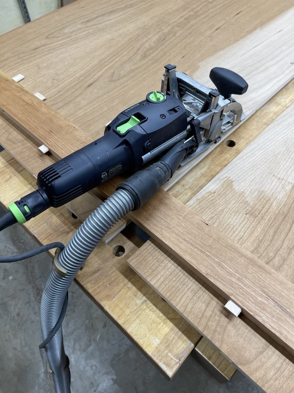

    The inner skin of the new back door has the first coat of varnish, dominos cut and is ready to glue up.
