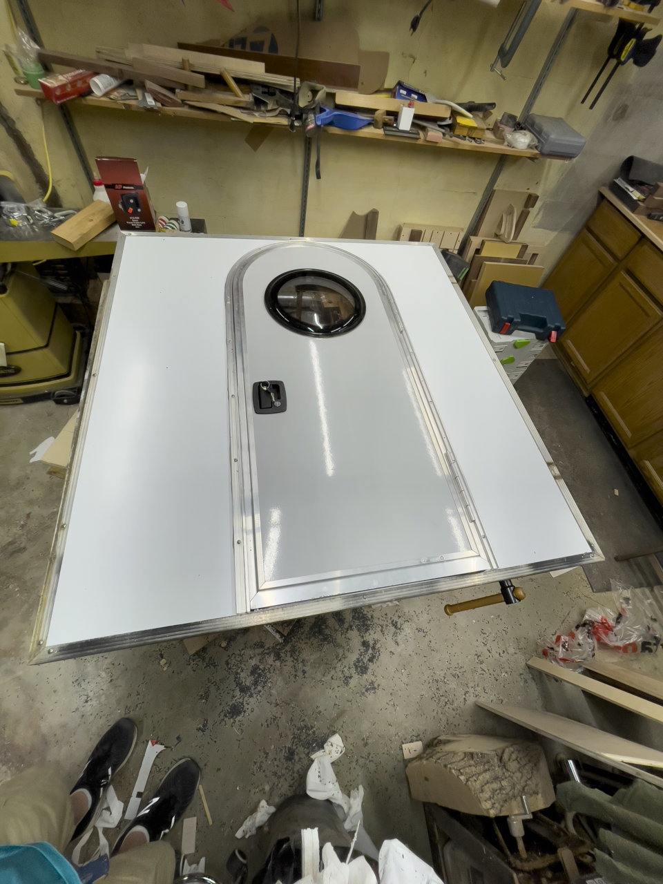

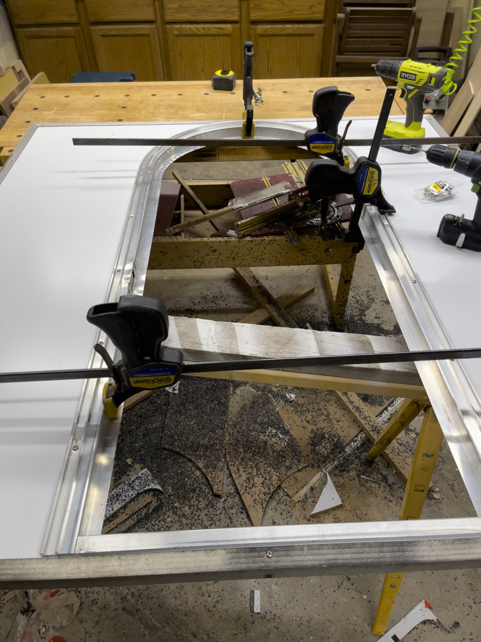

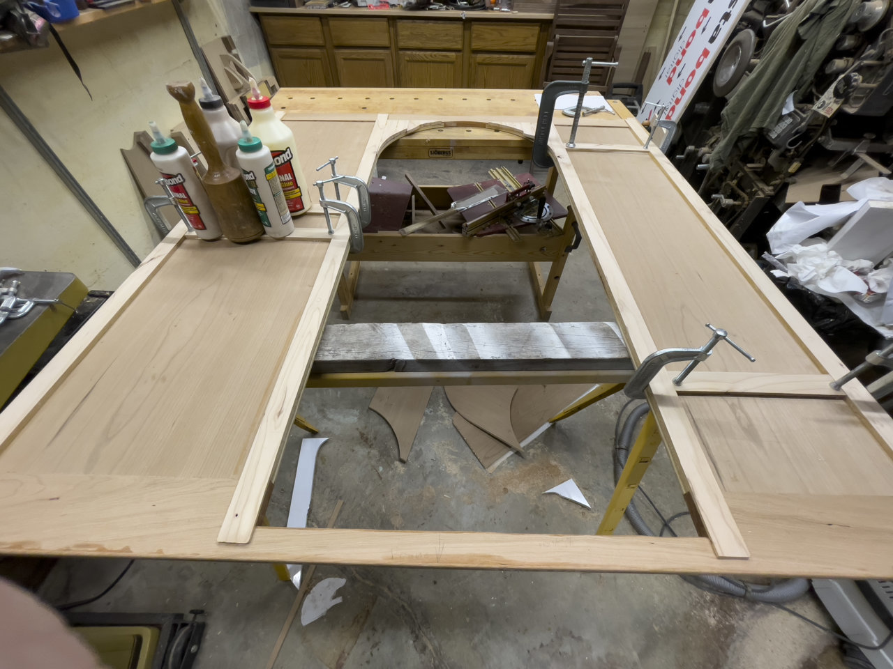

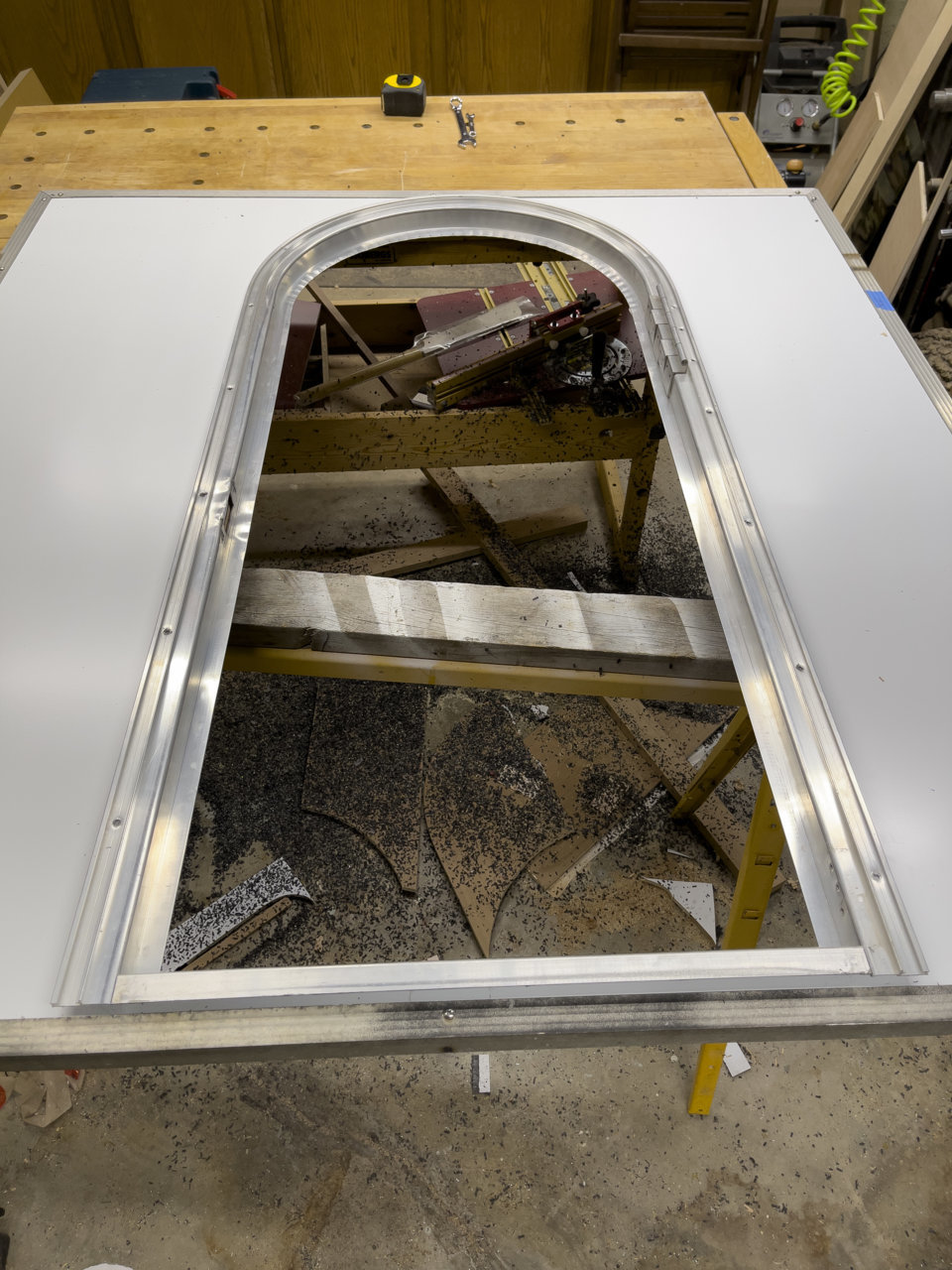

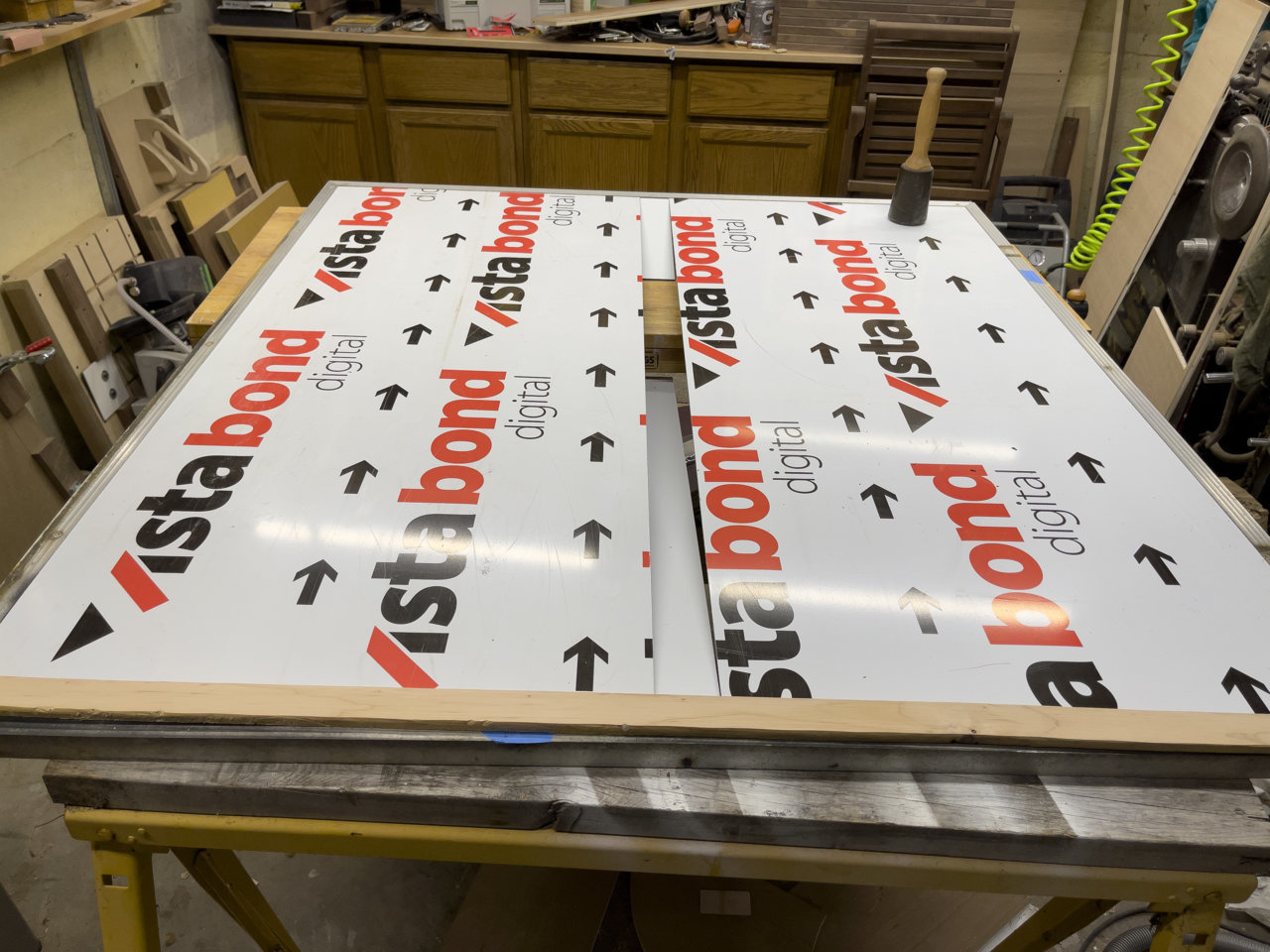

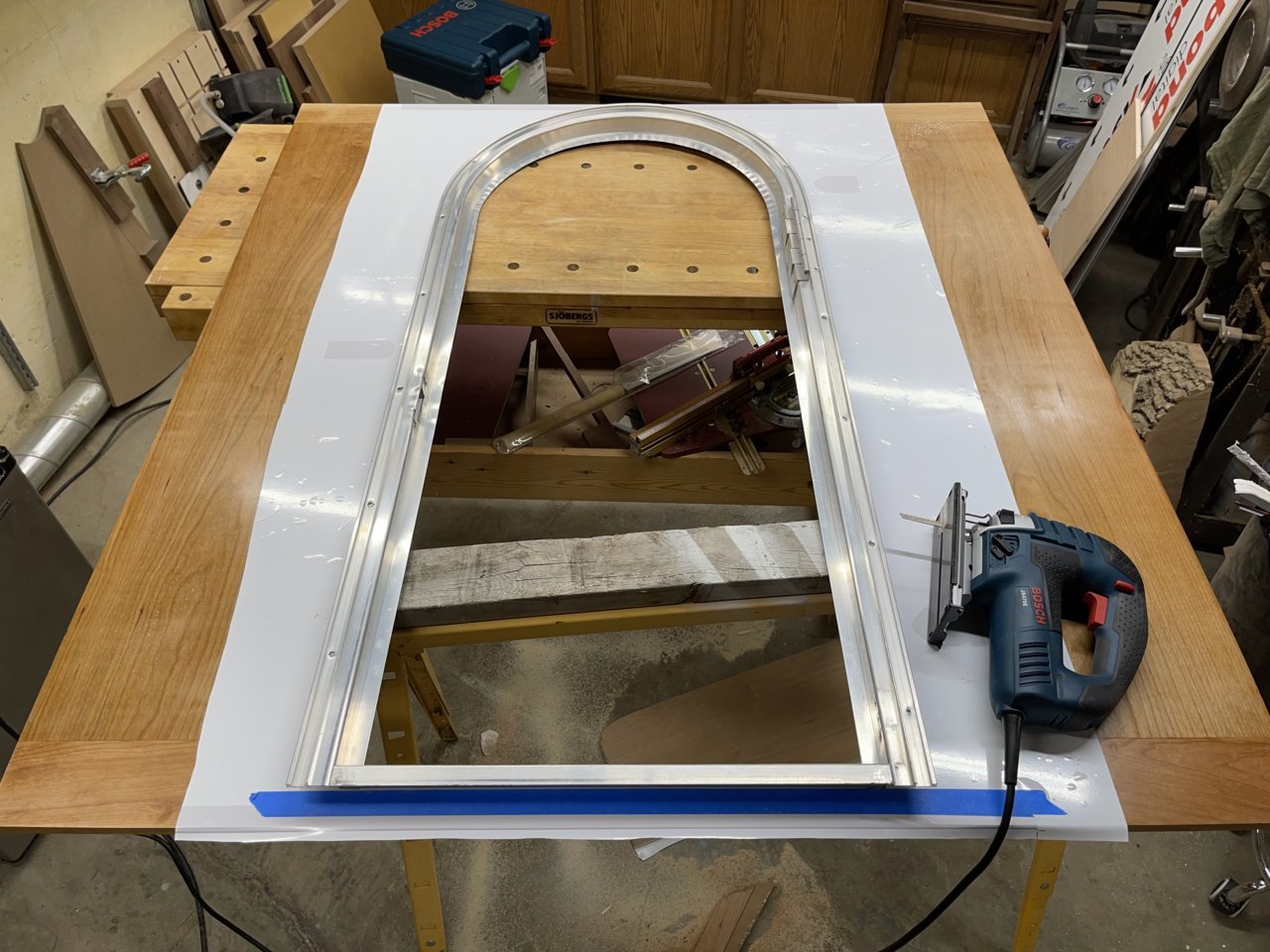

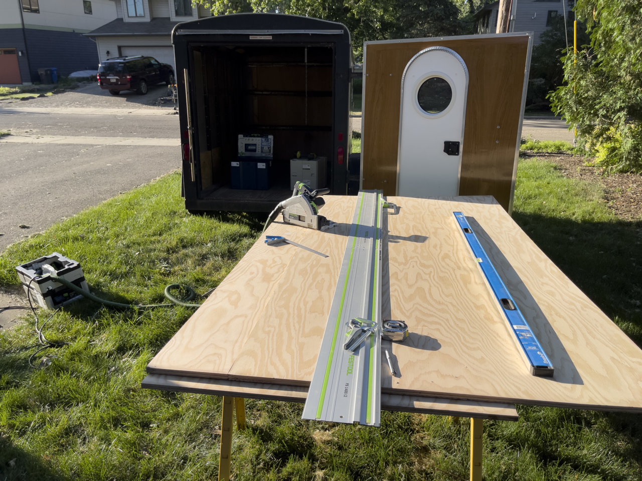

    Things have been going a bit slow with an upcoming vacation, but I am making progress on the back door, and the door being inset into it.
    Now that I have it this far, progress should happen much faster!
    29DC1D23-818F-4B24-864B-1BC3F23900FE.jpg C45FE531-62EE-455E-86D4-9306E9A86137.jpg

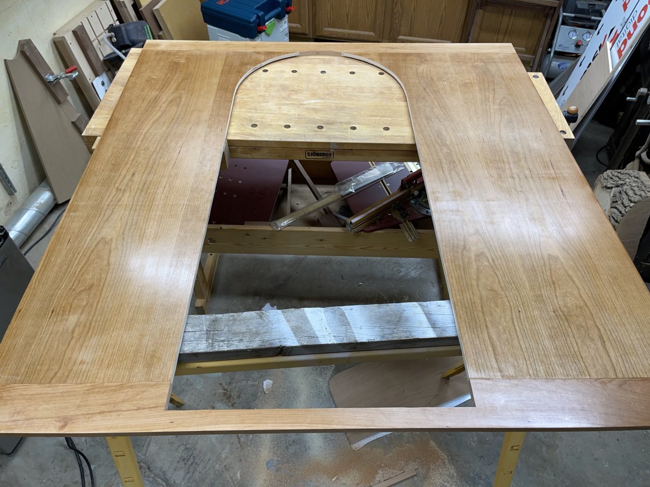

    With a major burst of energy this weekend, I finally finished the rear door replacement with the inset camper door. Now to install it, hopefully tonight.

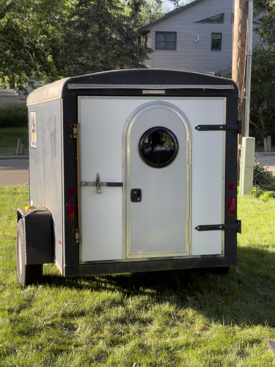

  10. Jun 20, 2022 at 6:01 PM
    #30
    Pixeltim
    Pixeltim [OP] Misunderstood member
    Jun 23, 2020
    #332368
    7,612
    77 square miles surrounded by reality.
    '15 Black DCLB SR5
    Tires, Softopper, fully armored, winch, many pinstripes.

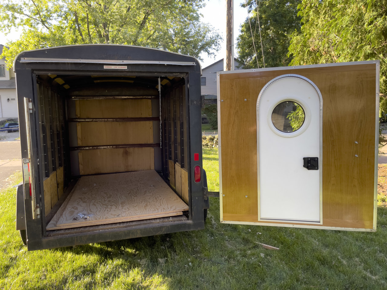

    Success! It fits perfectly!

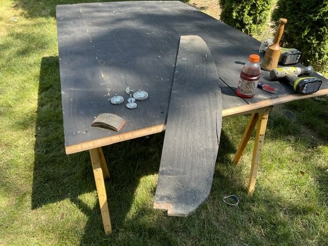

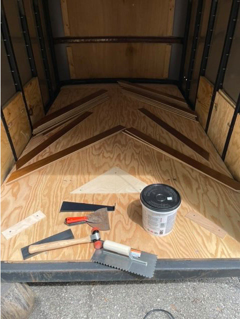

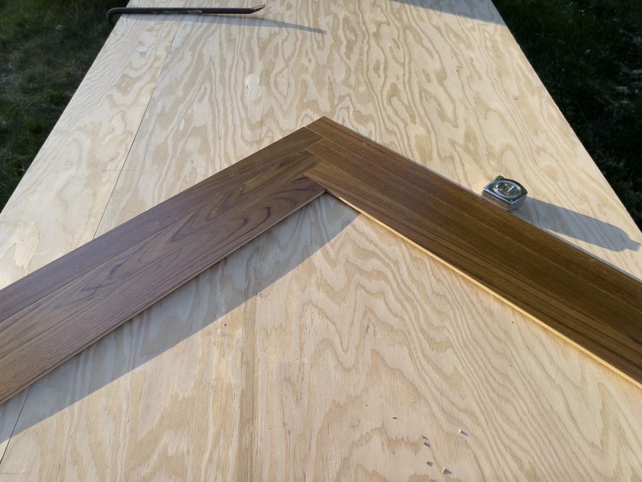

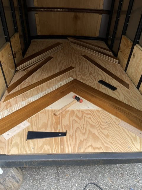

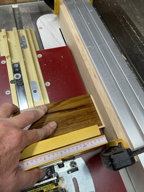

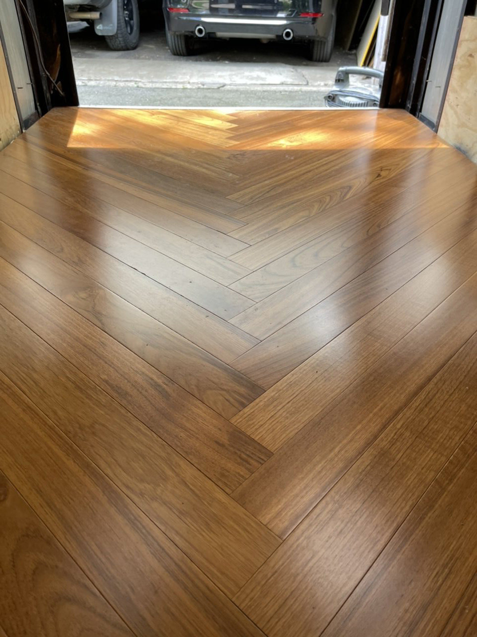

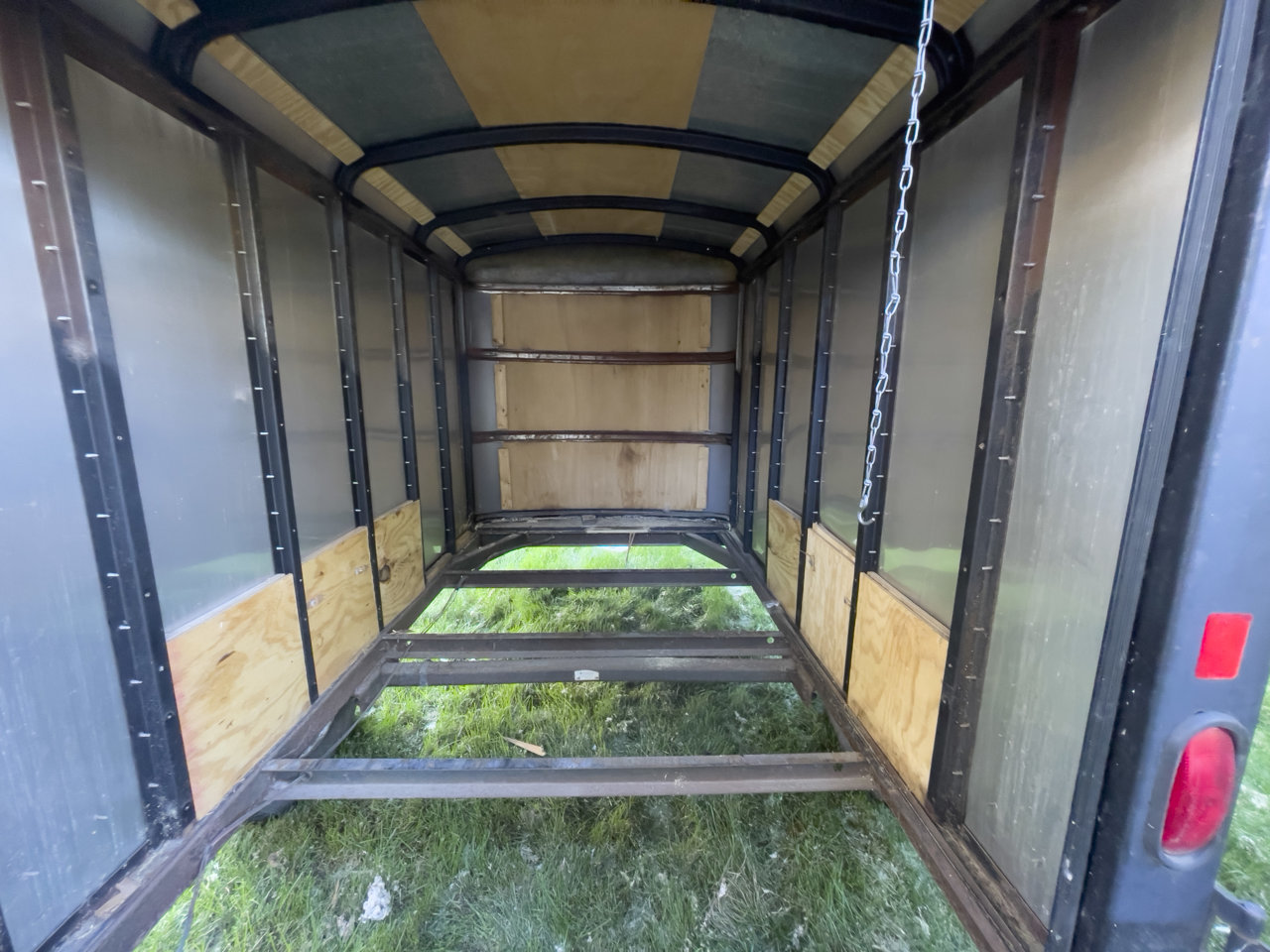

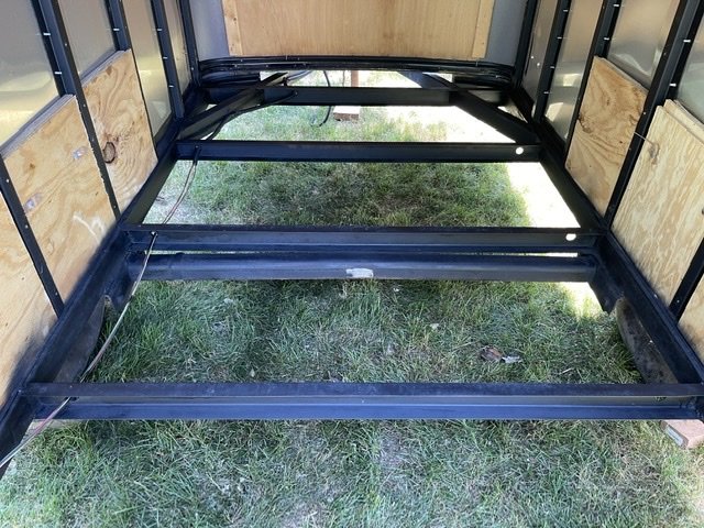

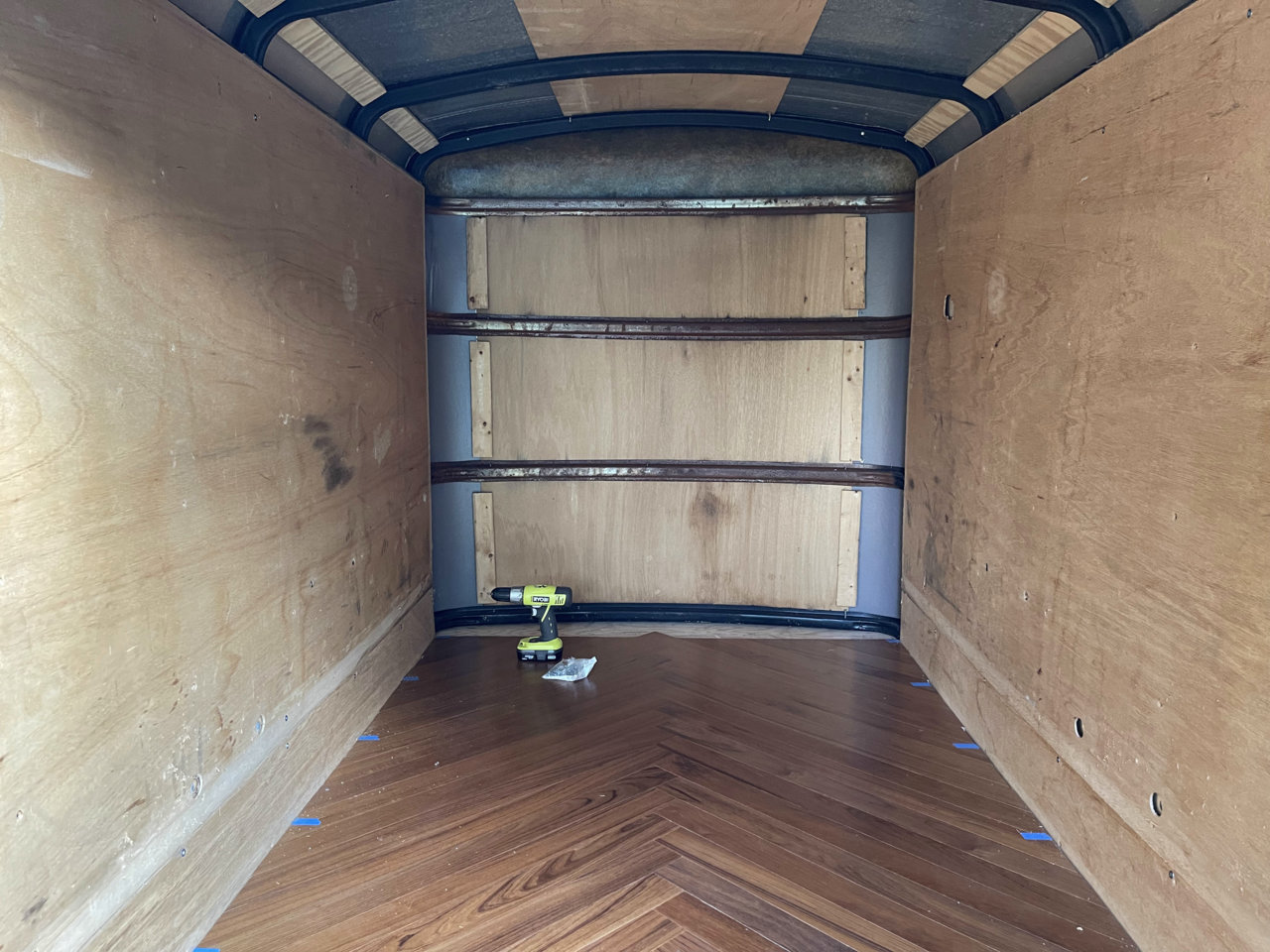

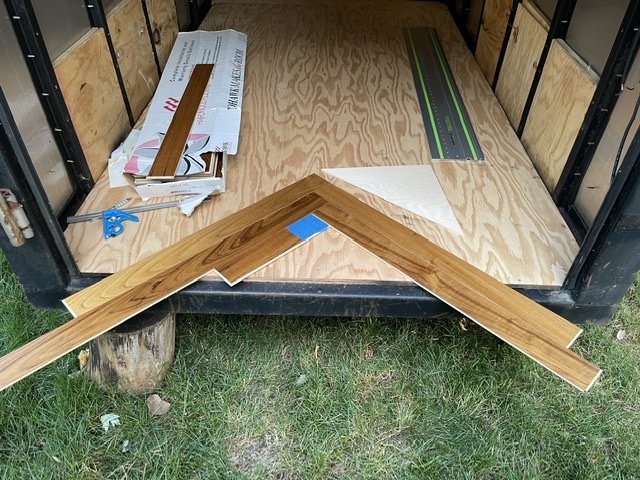

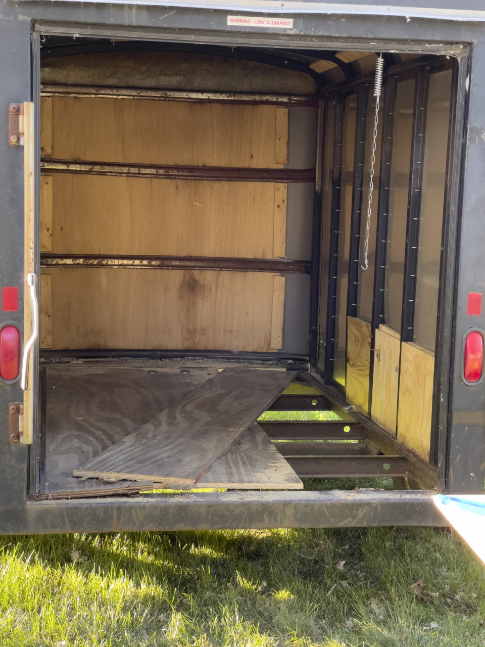

    Friday afternoon Trailer building:
    Tore out the old rotting plywood, cut and dominoed the replacement wood, then played around with the teak hardwood flooring I found for a steal at the Habitat ReStore!

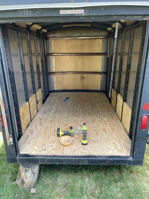

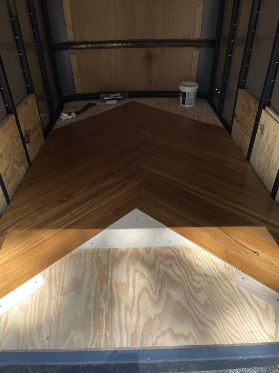

    Flooring is done and I didn’t muck it all up!
    I sprayed the frame with rust oleum rust converter after taking wire wheels to it.
    Then sprayed undercoating to the bottom of the flooring plywood.
    Installed the plywood.

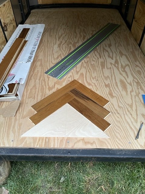

    Fast forward a week while I cut new tongues in half the flooring to be able to do the herringbone (sorta) pattern.
    Then messed around to get the right placement for the starter row.
    Then off to the races!

    3" lift? A.R.E cap 285/70/17 moto metal 955 17x9
    That's flooring why did you put it on the wall?

    Just wanted to be a bit quirky :)

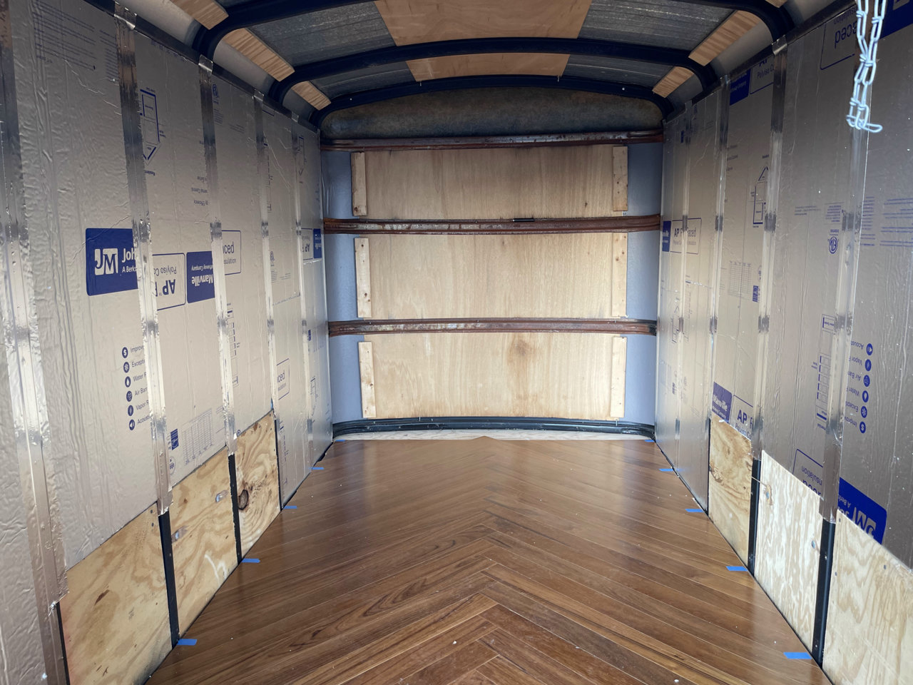

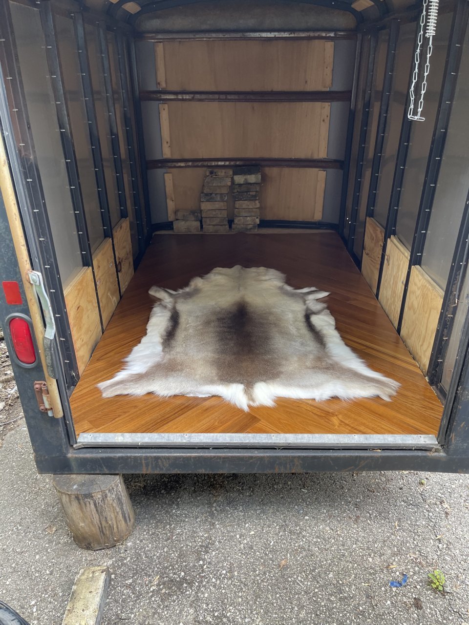

    Kept filling in the rows...
    Until it was completely done!
    Then a quick test fit of the rug I picked up while on vacation.
    Next stop? Insulation, Wall panelling and Windows!

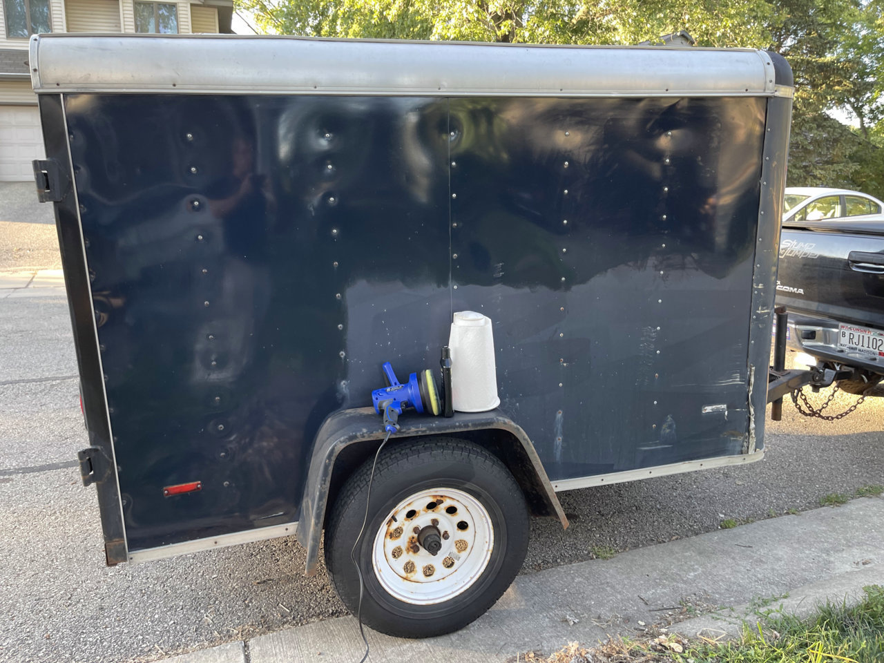

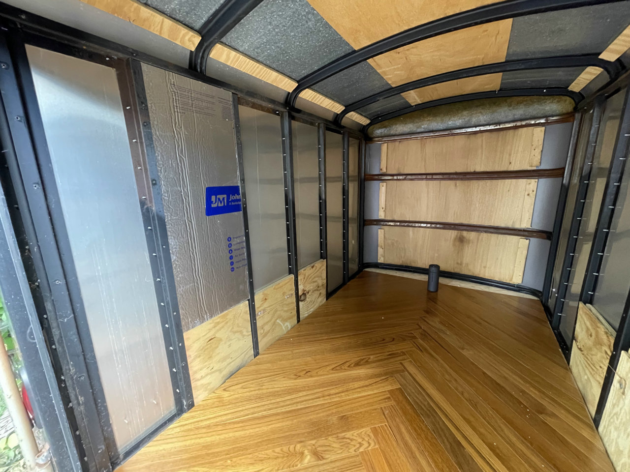

    This weekend I thought I'd polish it up to see if the finish was acceptable.
    It will never be a show piece, but at least it won't be too embarrassing!
    Then it was insulation time. That went far faster than I had expected.
    Now to install the windows!
    Once the windows are in, it'll be ready for a test run.
    If it's just too hot, then the fan is next.
    Then it's time to finish the front and ceiling too.

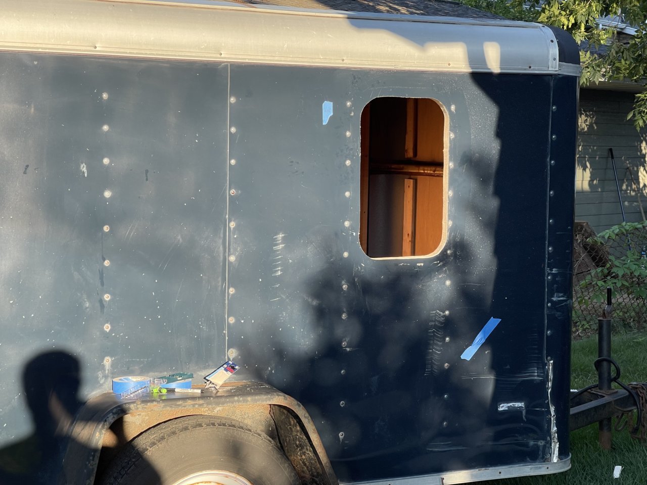

  20. Aug 1, 2022 at 7:55 PM
    #40
    Pixeltim
    Jun 23, 2020
    #332368
    7,612
    '15 Black DCLB SR5

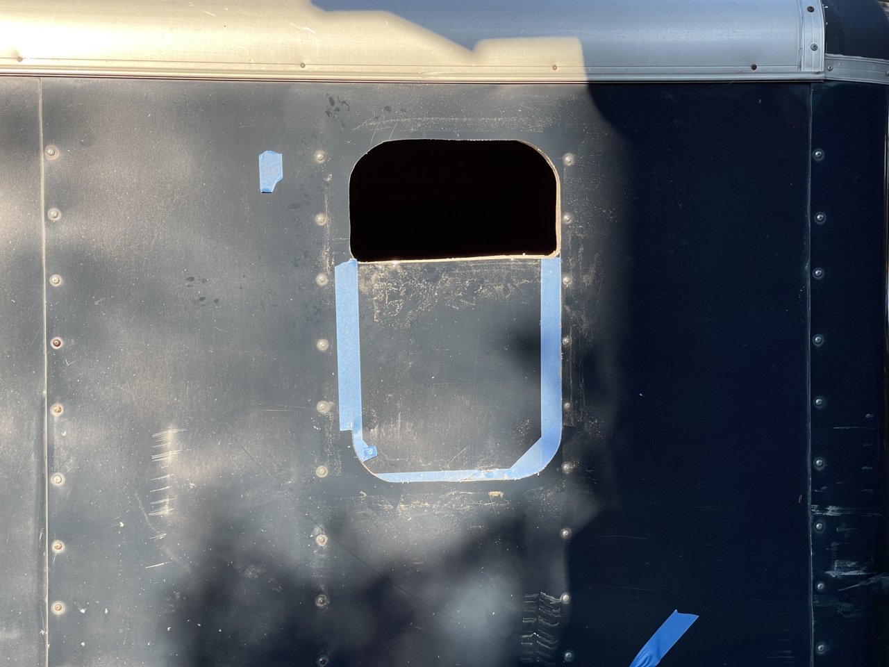

    F55B0666-4432-40FC-A7E7-27A79E4DF06D.jpg 8BEB6356-25C8-4512-8DE6-1AAE6BC63318.jpg I was able to install one window tonight. Fun times!
