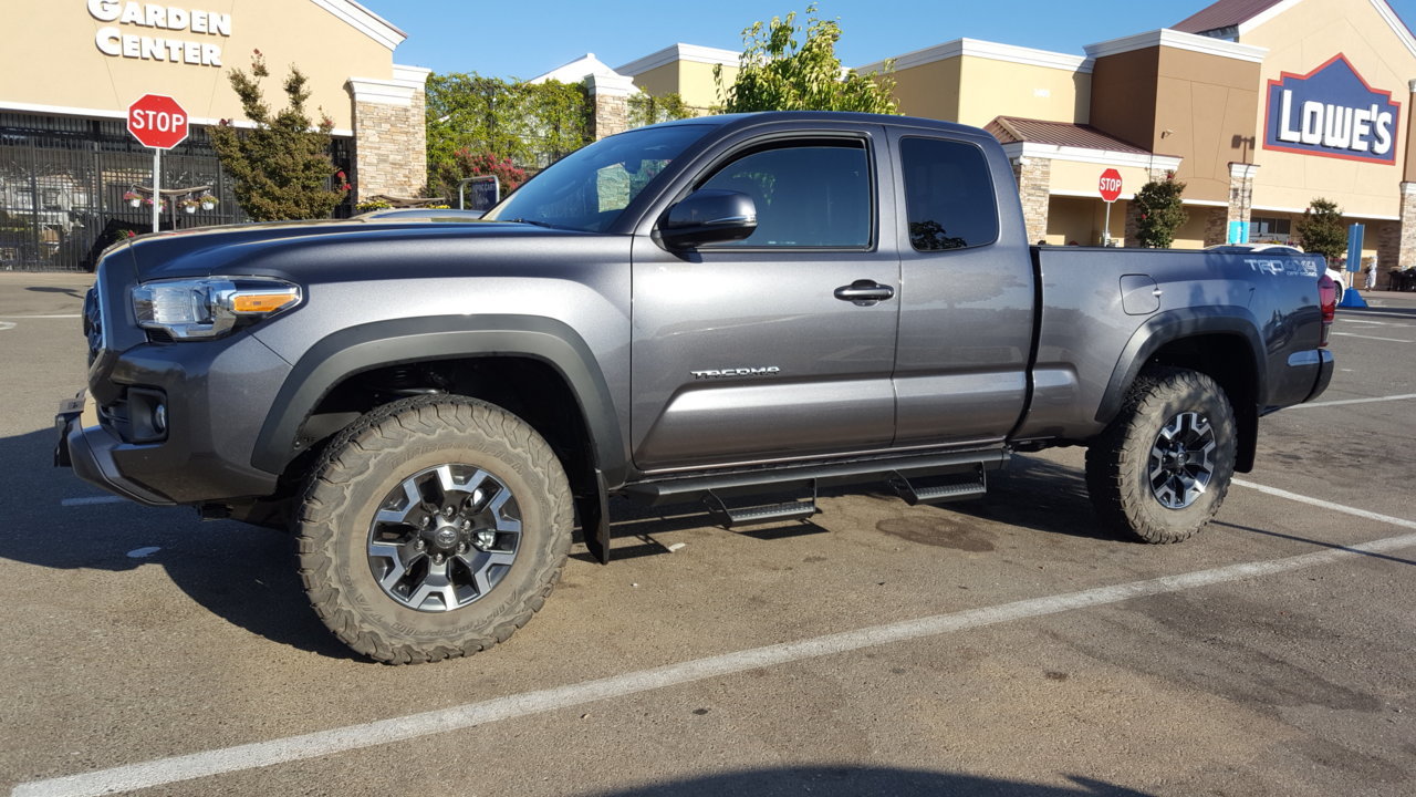

  6. Sep 7, 2019 at 11:00 PM
    entomologist
    entomologist [OP] Member
    Sep 7, 2019
    #304617
    17
    2019 Magnetic Gray Tacoma TRD Off-Road Access Cab

    Got a Les Schwab to do the swap and it looks great!
    Any advice on speedometer adjustments? The new tires don't result in too much of a speed reading error but occasionally the shift points seem to mess up.
