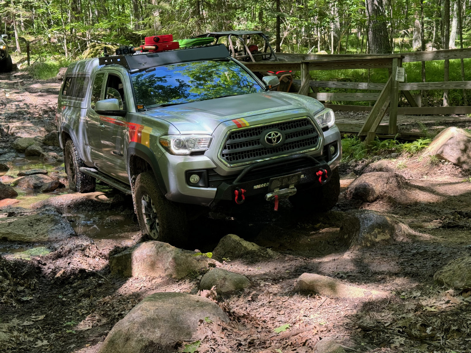

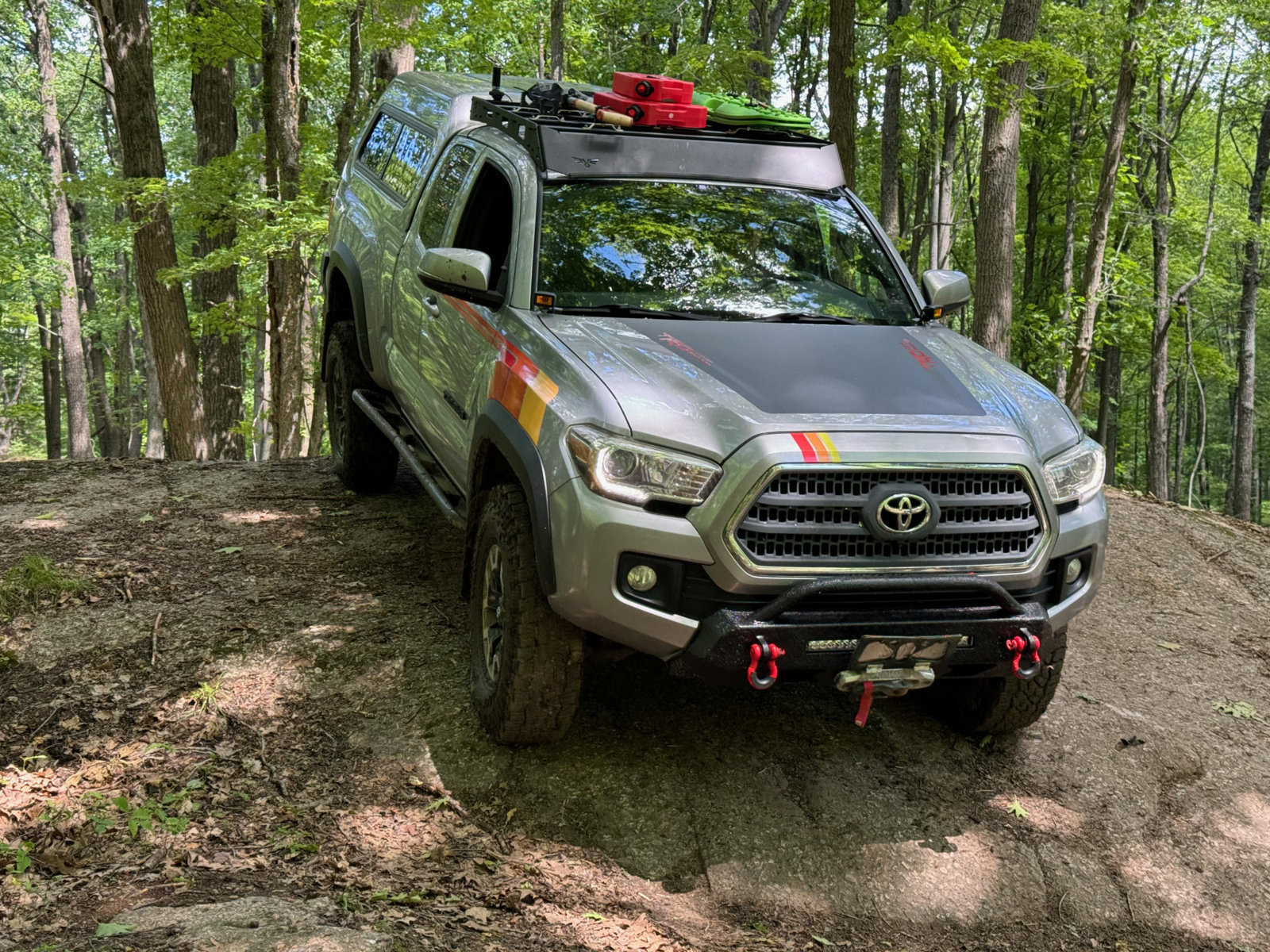

    OldSchlPunk
    OldSchlPunk A legend in my own mind!
    Feb 13, 2022
    #390091
    5,588
    Rich
    East Central Wisco
    '17 OffRoad Silver Sky Metallic
    Small lift, slightly oversized tires, well...
    Previous tires were general Grabber ATx in 265/75/16. Really liking them. Quiet, good road manners wet or dry, balanced well. When offroad the other weekend, they were up to the task:
    Didn't find any deep, deep mud, but what we found was easily handled. Now, to find some sandy trails...
