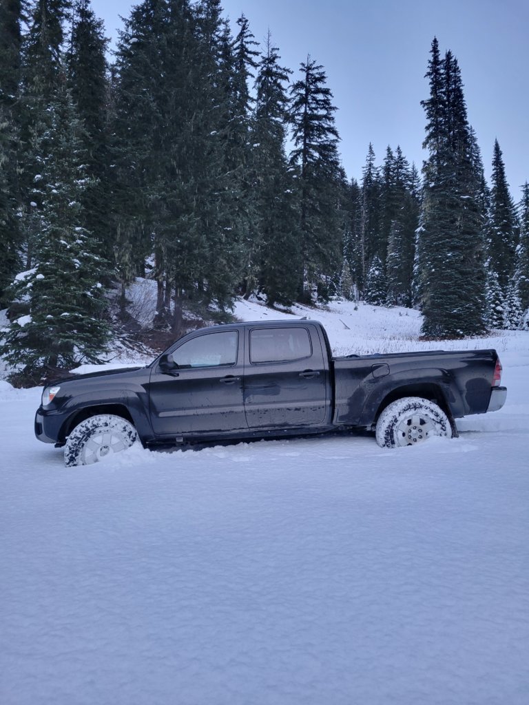

    I have 255/80 Toyo AT3s (e load) and while I don't hate them, they are pretty heavy for anything daily driven. I drive around in 4th (auto transmission) most of time. On the freeway at 65 mph in 5th/OD engine rpms are around 1,800 which isn't the greatest. Really should be up over 2k rpm when cruising..
    I don't offroad much, mostly just snowy highways and forest service roads.
    Hands down, they perform the best in the snow of any tire I've had. Both compact snow and deeper stuff. You can air down into the low 20s or high teens no problem and they crawl like excavator tracks.
    In my opinion at 33s you really should be re-gearing to keep the drivetrain happy. But honestly I'll probably go back down to 32s before I do that.
