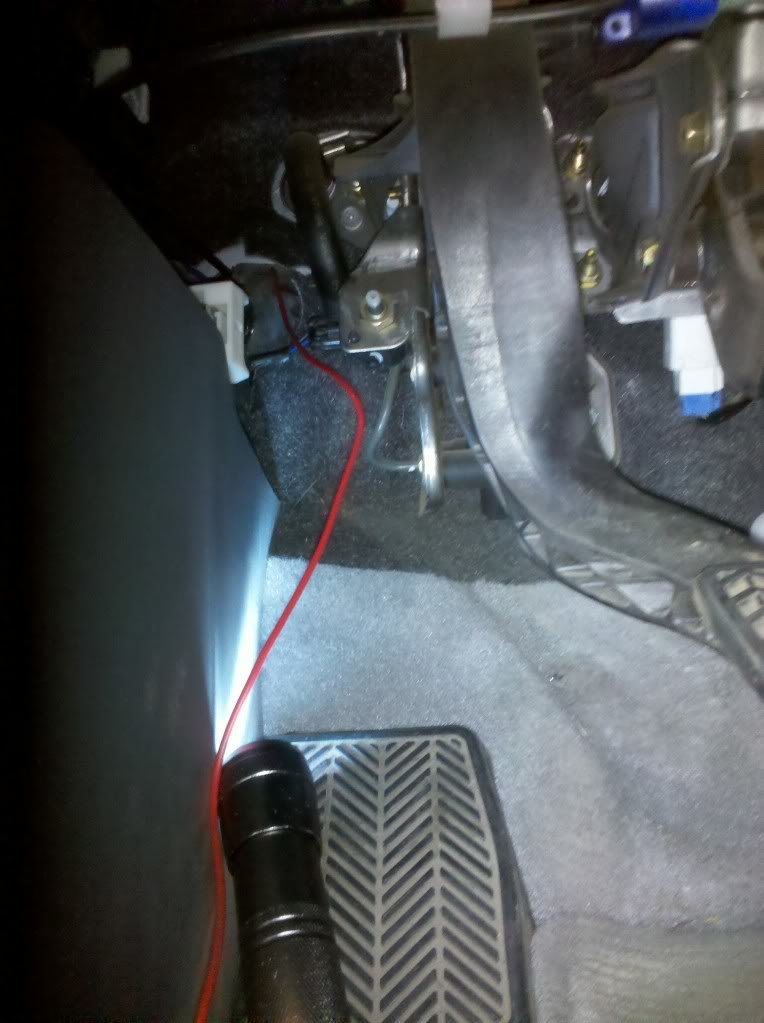

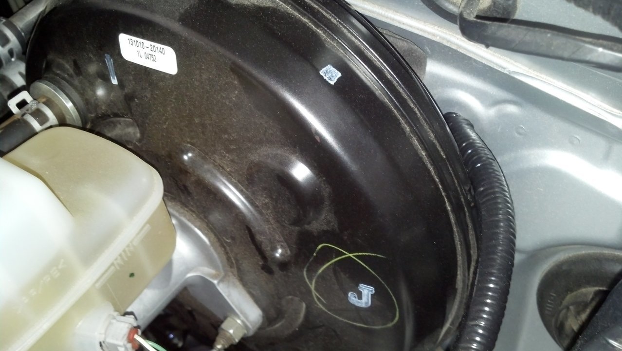

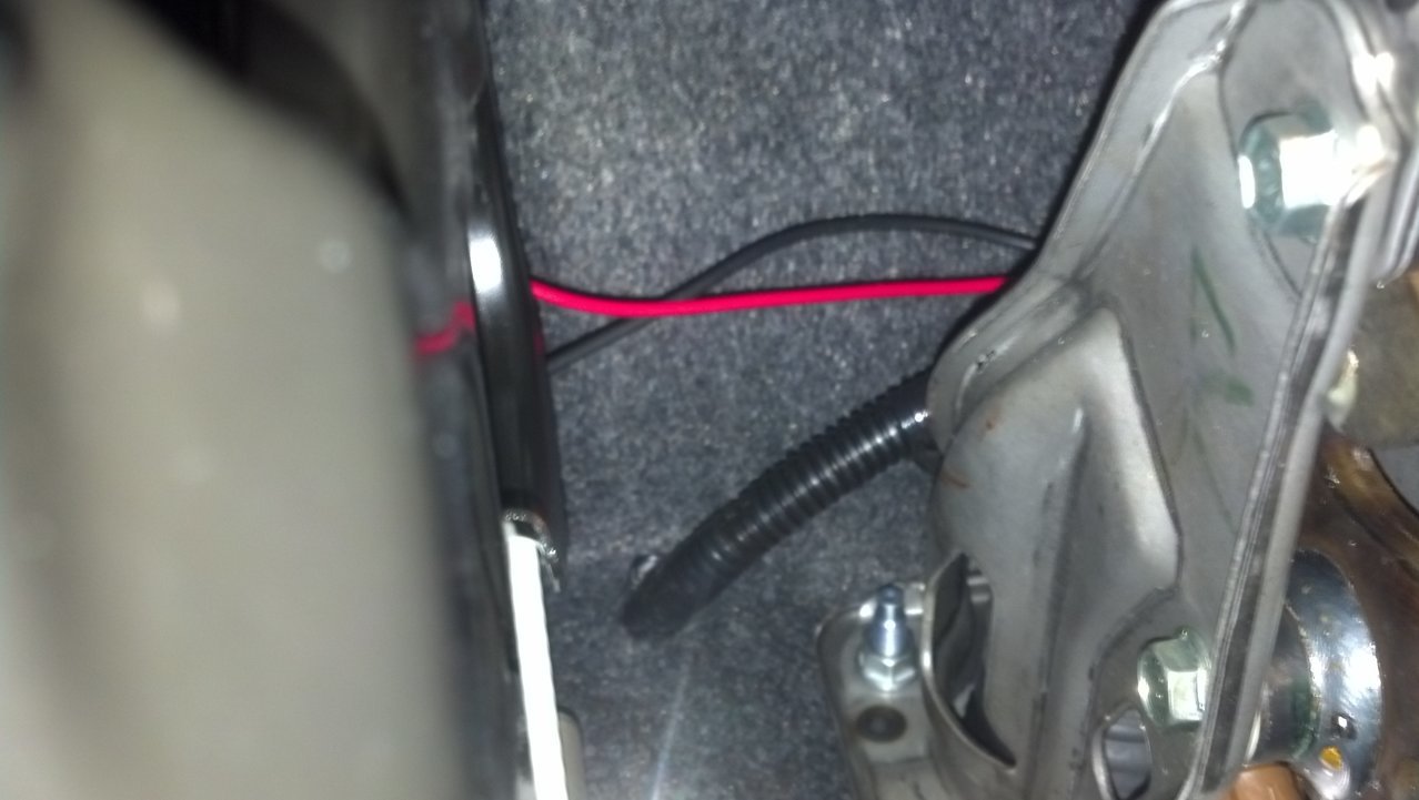

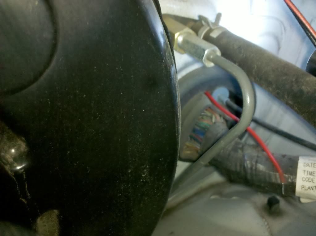

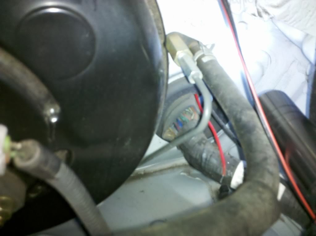

    I found a pretty easy way. I ran a bunch of wires for my LEDS and shit thru the opening in the boot on the firewall. I put a flashlight in the engine bay pointing at the hole then went inside and ran the wires thru where the light was coming thru. It's real easy.

    Heres my pics........kinda get the idea.
