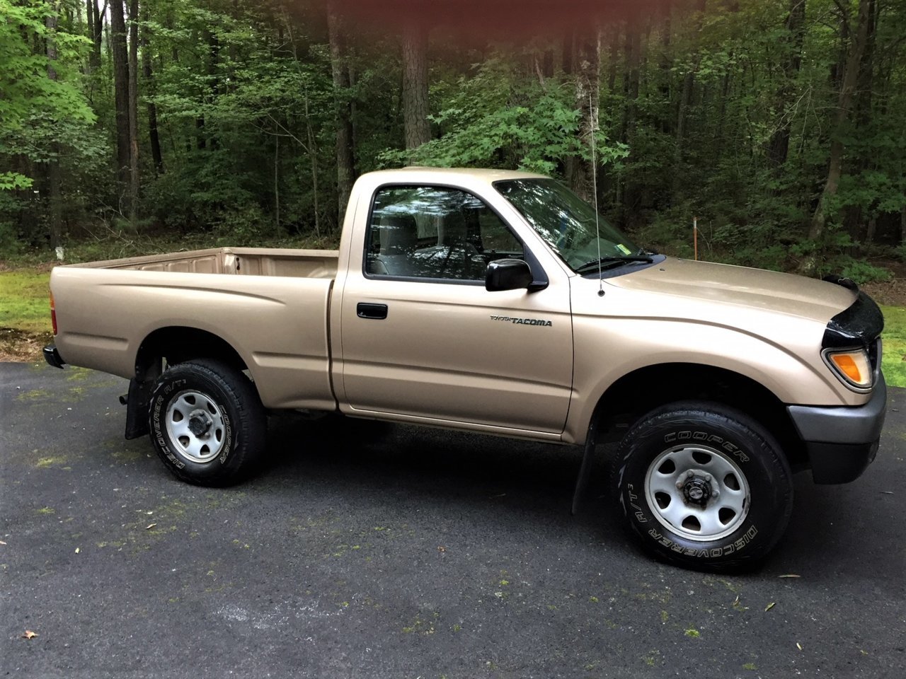

    I've got 414,000 trouble-free miles on my '96 and have never changed brake fluid, differentials, manual trans fluids. No issues or noise, everything fine. Have change my motor oil every 5,000 miles though.

    Perhaps, but it's quieter than my 2018 TRD Sport with 23,000 miles.
