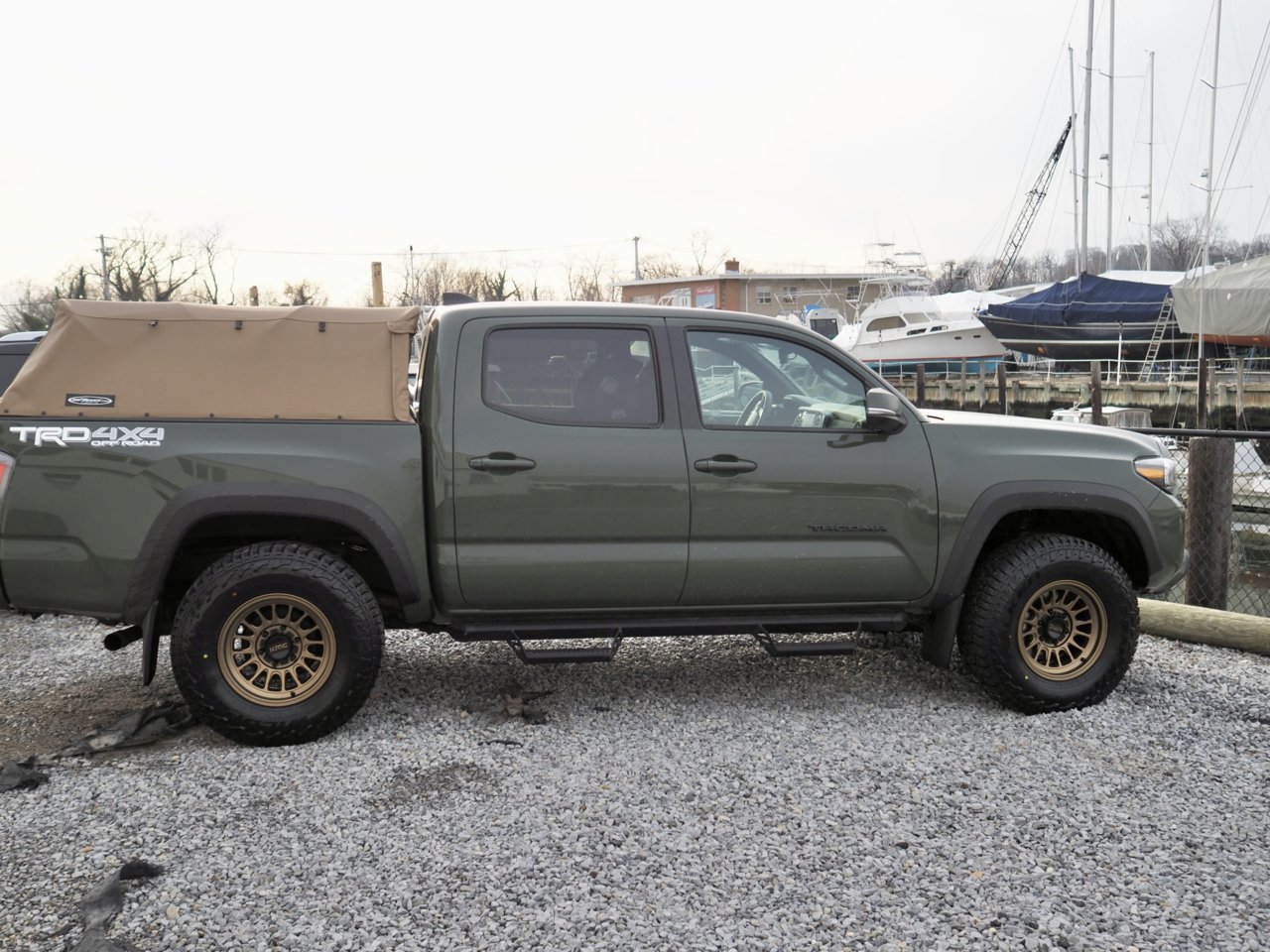

    2021 OR with stock suspension. Just put 265/75r16 Falken Wildpeak AT3Ws on KMC Impact OLs yesterday. They rubbed slightly on the mudguards pulling into driveways and uneven surfaces. It was a slight rub, but I already pulled off the mudguards. 88AF2847-3D02-4F2C-B779-7BB1A81CE6AC.jpg

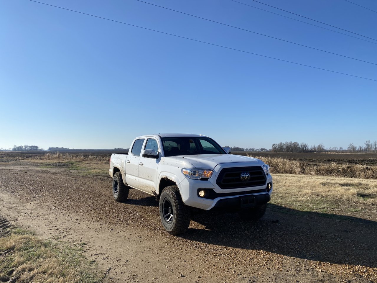

    Yep you'll be fine. Here's mine in 265/75r16 on zero offset Vision Turbine rims. Haven't detected any rubbing on/off road.
    Edit: also be aware you should get an alignment when changing wheel and tire specs like this, even if it seems like a minor change. I wonder if this is the issue for some of the people reporting minor rubbing with 265/75r16's on zero offset rims in this thread.

    I have 0 offset wheels, and now that I took off the mud flaps it doesn’t rub in normal driving. I did get a slight rub the other day while turning into a driveway at a decent speed. I say go for it. For me it seems to be rubbing on that little piece that sticks out from the back of the front wheel well.

    Gotcha, and thanks. I'm running 265/75/16 Goodyear Wrangler Ultraterrains on 16x8 Vision Turbine rims which are zero offset. No rubbing at all. I've seen so many threads on this concern about 265/75/16 rubbing but I haven't seen many actual individuals saying they have them and they rub, but I take you at your word you've seen people saying that. This size is considered and frequently posted as the largest size that doesn't rub on factory suspension, so I just took everyone's word on that and it was true in my case, as it seems to be with the vast majority of folks. I'd be willing to bet the majority if not all of the relatively few people saying this size rubs come down to these explanations:
    - They didn't get an alignment when they upsized tires from factory.
    - They have crazy negative offset wheels or are using wheel spacers that create a ridiculous turning arc on the front wheels.
    - They are wrong, and what they think is rubbing is some other noise.
    - The rubbing is only on the mudflaps, and they simply need a different brand/style of mudflap, or they need to modify their flaps a bit.
    -(Probably the least common) they actually have rubbing because they picked an unusually tall or wide tire among all the tires sold as 265/75/16s, because there is slight variance tire to tire. Fortunately you can find precise measurements for all the tires you'd ever consider and can simply avoid ones that seem unusually larger than average specs for the size.
    I know I've seen people offering these specific explanations for their rubbing 265/75/16s in some cases, and I'm sure they explain the rest at least in most cases. I definitely recommend this size if you keep stock suspension. I'm so happy I did from a looks and function perspective.
