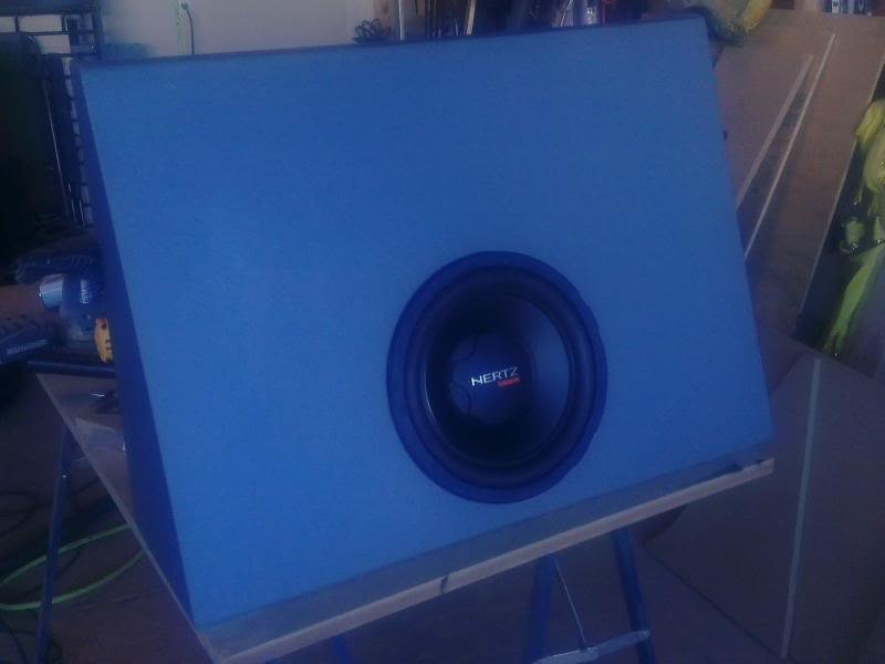

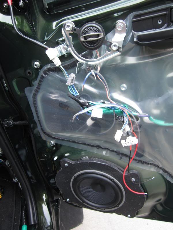

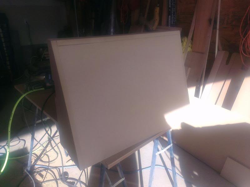

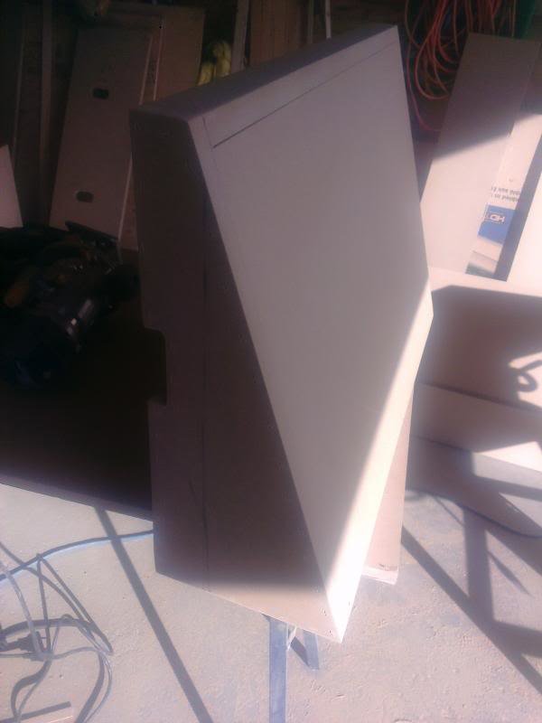

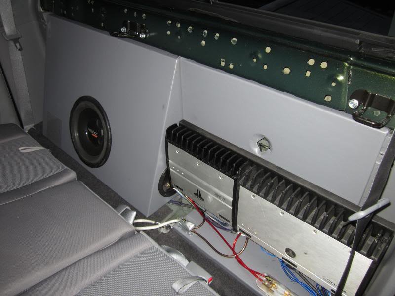

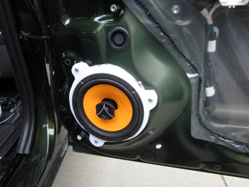

    I have the older Pioneer 5500, two JL Slash series amps, and all Hertz speakers in my truck. I custom built my own sub box and amp rack, since I was unimpressed with what was available and the prices.
    Made my own adapter rings out of cutting board material. Use the old speakers as your template.
