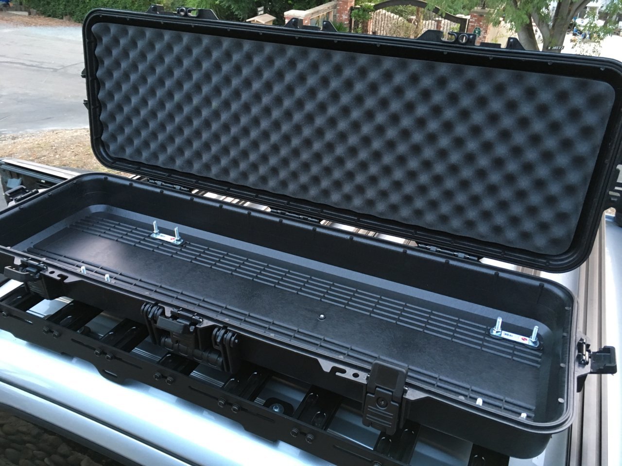

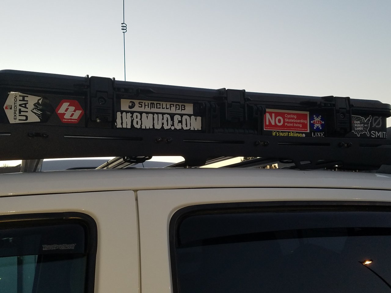

    My install guide:
    1. Buy qty(4) 2 inch u-bolts available at Lowes/HD for like 2 dollars each, 8 nylock nuts, and 16 metal fender washers and 16 rubber fender washers (I used 1.25in dia washers I think) that fit your u-bolt diameters pretty snug. All the nuts/washers should only cost a few bucks, and basically make a weather seal.
    2. Figure out which bars you want to wrap the u-bolts around and measure accordingly. I found it helps to have a long and skinny piece of cardboard to make what carpenters call a "story pole". Basically a template that is pre-measured and a lot easier to handle than a huge case. Mark all the hole spacings on that then transfer to the case.
    3. Mark the case with sharpie, etc and drill the 8 holes for the u-bolts.
    3a. (optional) Paint the u-bolts to get rid of the shine. Any black spray paint will do.
    4. Wrap u-bolts around the bars, then add a metal washer and a fender washer (in that order) to each stud.
    5. Place the case on the rack and put the studs through the holes in the case.
    6. Add the remaining rubber washers to the studs on the inside of the case, then the metal washers, then top off with the nylock nuts.
    7. Tighten down the nuts, throw your junk in, and admire your handy work over a beer!
    My extra 2 cents: In line with the truck, a 42 inch case spans 5 bars. I mounted the case to bars on 2 and 4 and it works really well with what I put in it. Part of me wishes I had done bars 1 and 4 or 5 though. Every once in a while on bumpy roads, the front of the case "flaps", and makes a bit of a rattle. Not really a bother, just me being picky. Putting the bolts at the end would fix the rattle.
    Also, I mounted the bolts in a square pattern in the center of the case instead of at the edges. The reason I did this is so that if I wanted to run the case width wise on the truck, the u-bolts are still usable. I just have to rotate the bolts 90 degrees.
    Pictures:
    In this pic you can see the u-bolts wrapped under the bars below the IH8MUD sticker and the No Cycling sticker:
    In this pic, you can see the u-bolt studs/nylocks:
