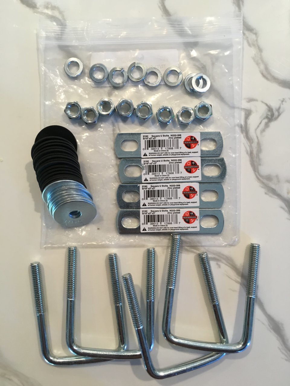

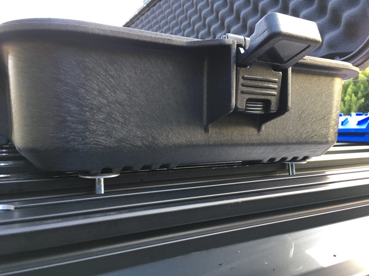

    I used (4) 2" U-Bolts that came with nuts and plates from Lowes. Drilled holes to match the locations of the cross bars. Got some splits nuts, washers and rubber washers (water proof the drilled holes) and bolted from inside. Depends on how OCD you are mounting positions are up to you. You can go front to back or side to side. Drilled hole locations so I can mount both ways.

    I like the interior boxes! My Plano leaks so I am curious if yours does too? If so, have you solves the issue?

    I live in SoCal so not much rain though it rained heavily twice this week. I checked and contents were dry. Don’t know what to tell ya I haven’t thought much about additional water proofing.

    Maybe your lid doesn’t line up with the body leaving gaps? Mine is flimsy but lines up fine. Maybe add weather stripping or 3m tape to fill the gaps.

    My Plano cases leak too. I finally gave up and drilled drain holes in the bottom; it’s not ideal but better than them staying full of water.
