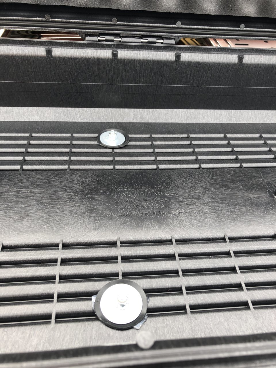

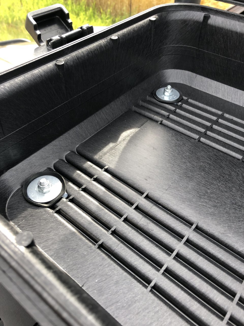

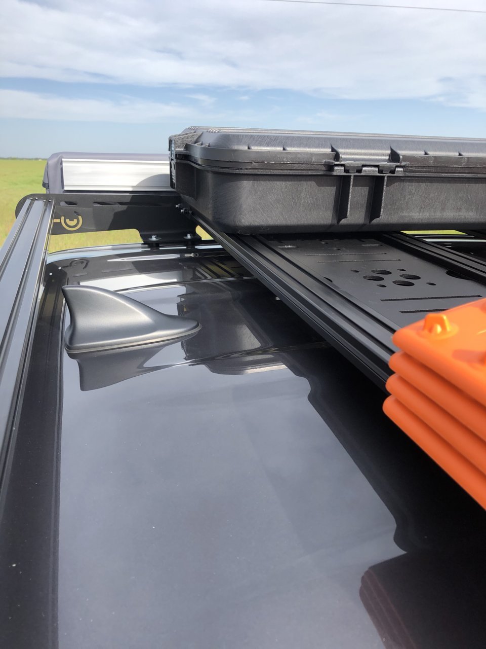

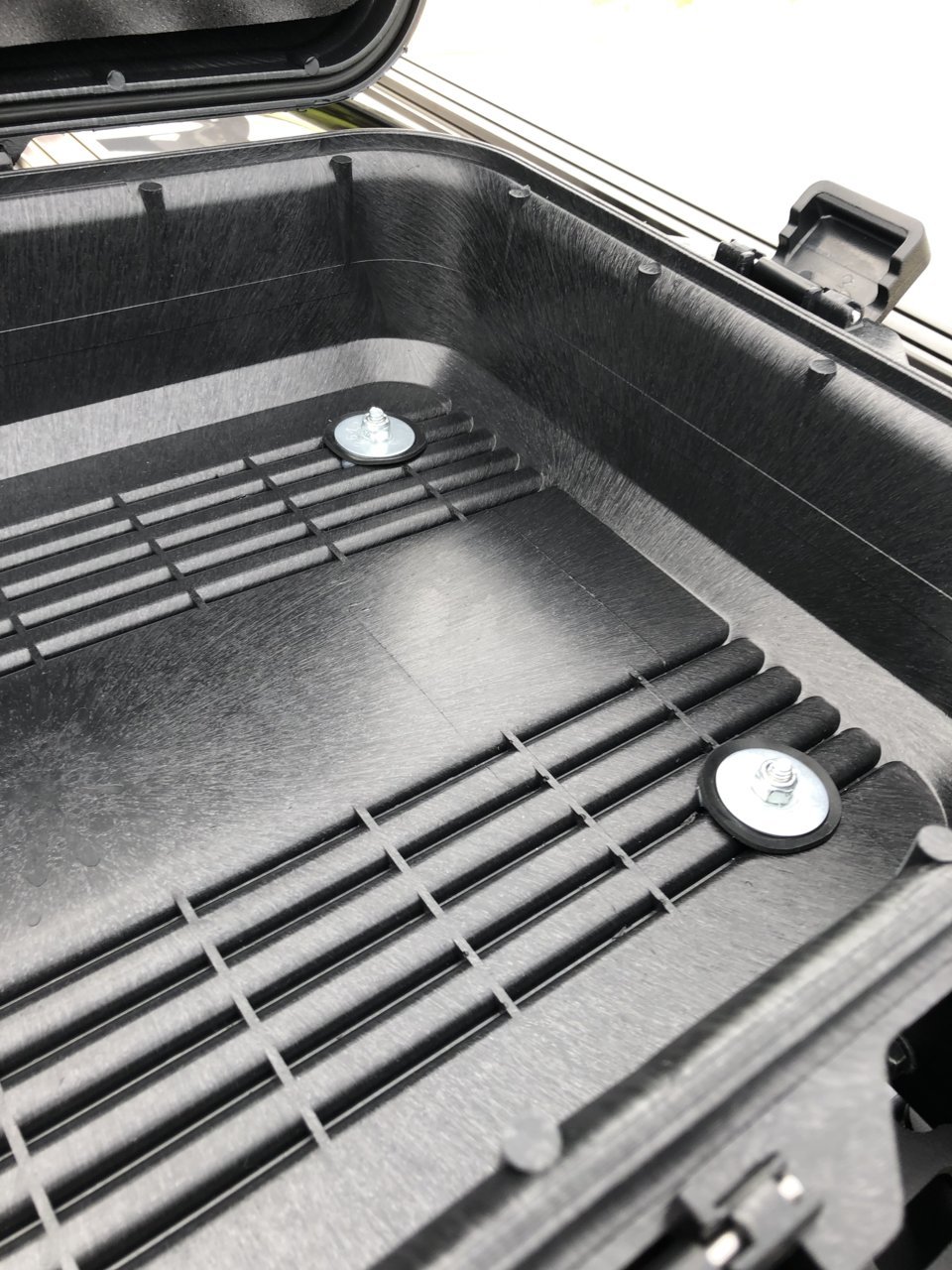

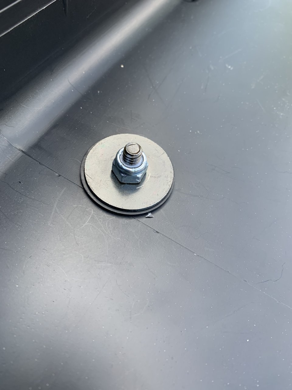

    Plano gun case mounted with 1" 1/4 carriage bolts, rubber and fender washers inside and out and then a nyloc nut to secure it all down. I put some silicone on the inside before the washers went on. Hope there won't be any leaks.

    They usually ingress water from where the halves meet, and not the bolt holes.

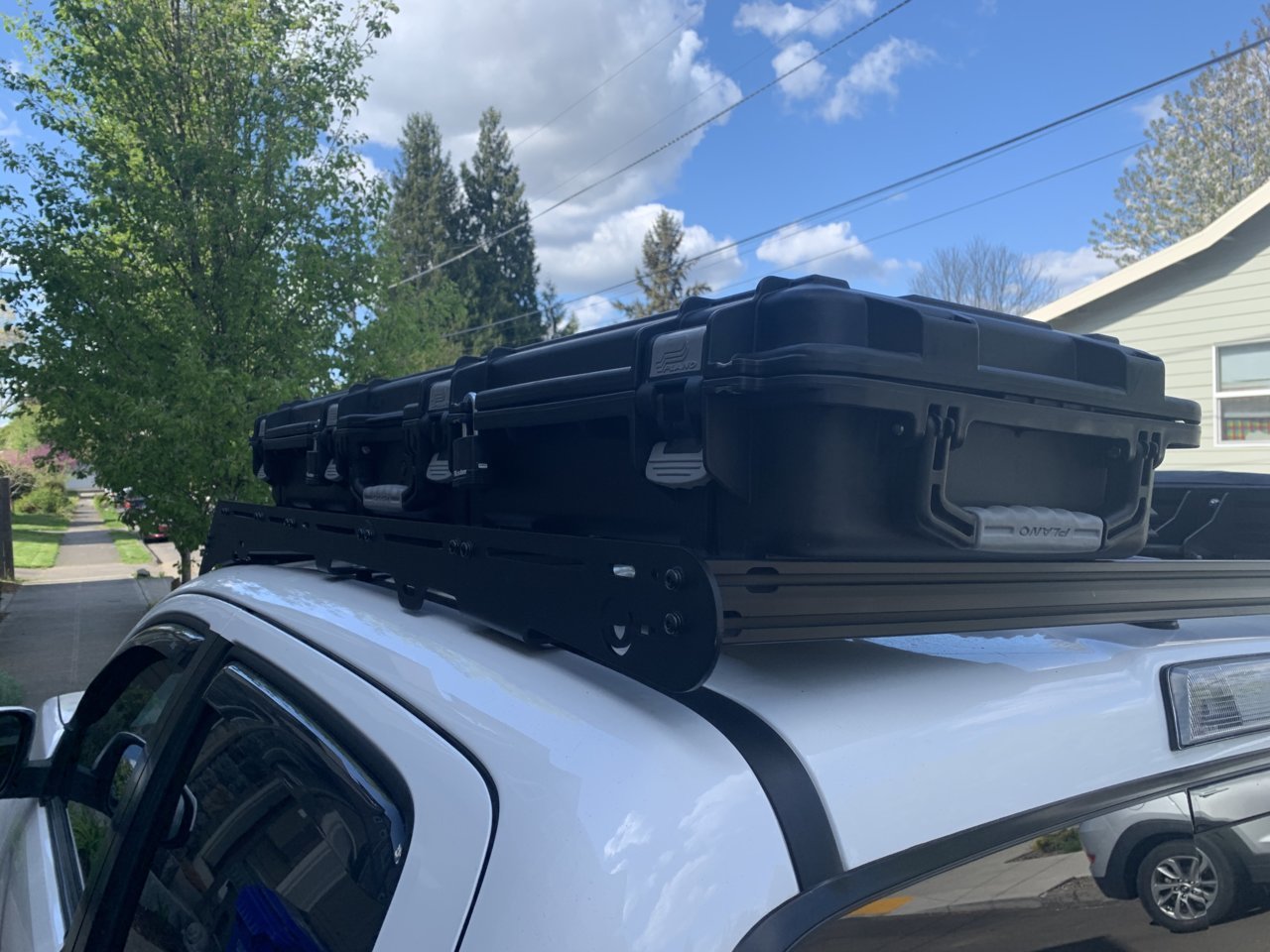

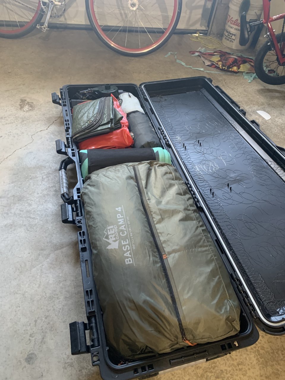

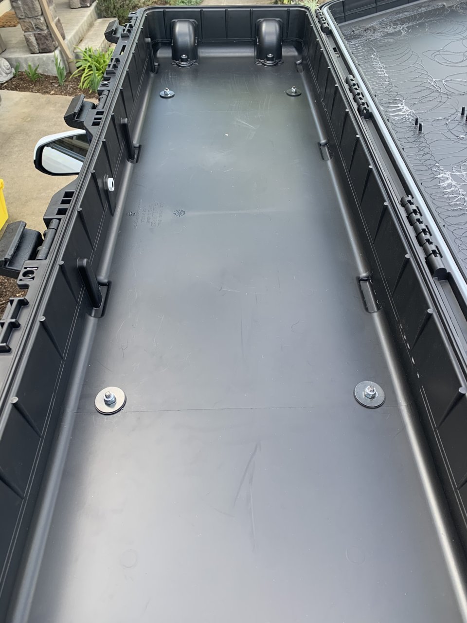

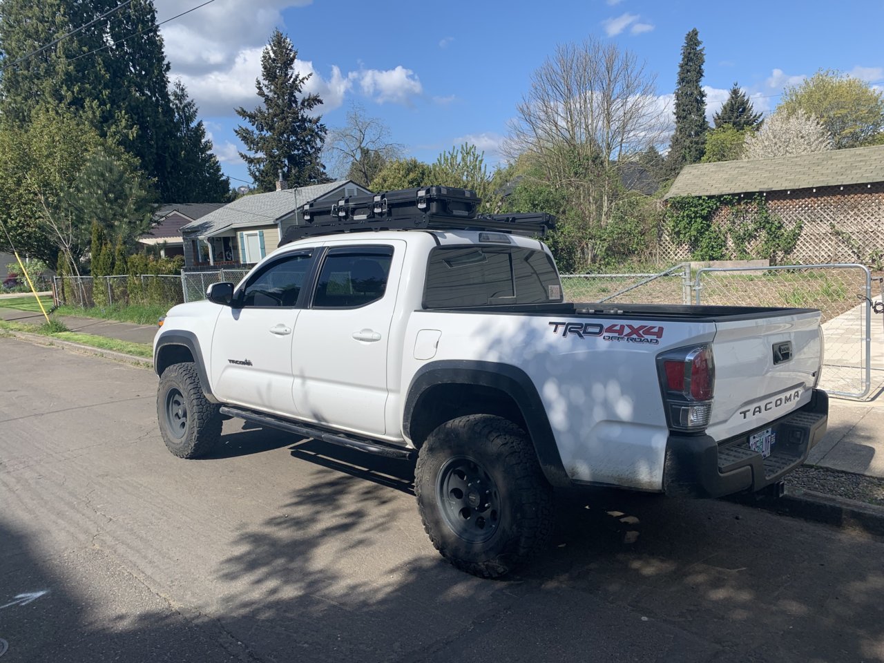

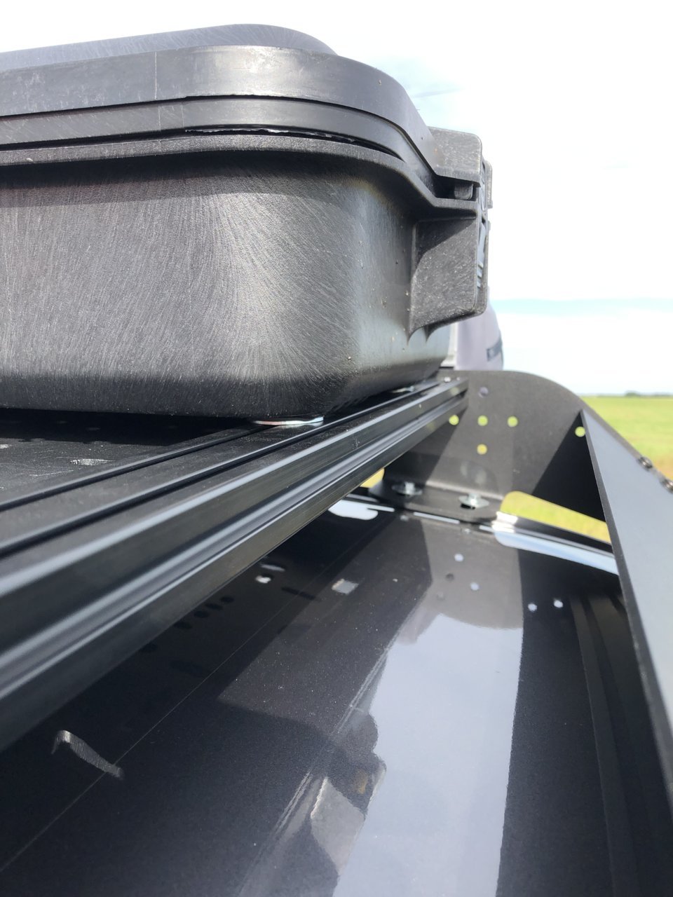

    just got a Plano field locker in the biggest size mounted up today. 57” in length. used 1/4” carriage bolts with rubber and metal washers on both sides and lock nuts with nylon inserts. i’m stoked. mounted up there super easy just had to move 1 cross bar over a tiny bit. since i don’t have a RTT yet, i’ll be using it to hold my tent and other sleeping gear. it all fits perfect! 9C4AAB38-A602-4740-9902-9ED13C0D0F8B.jpgC4A109C3-5966-4162-8848-DA74934F5E3A.jpg E0A40C5F-DE5A-49A6-A7E7-BD16702A5889.jpgFE8DC3DE-834B-43BE-A005-DA3076593A3A.jpg D7B00AF1-47BD-4BA5-9AA0-5255C157D7A8.jpgB24E610C-2A3C-4AAE-BB63-DEB9C71F840C.jpg EBF57013-233E-4699-B296-6E2D9A86D162.jpg

    How is wind noise with the gun case on the roof rails?
  19. Jun 4, 2022 at 3:01 PM
    #79
    Naveronski
    Naveronski Well-Known Member
    Sep 14, 2013
    #112501
    9,546
    Fort Worth
    2014 MGM DCSB TRD:OR
    Noticeable and annoying, I eventually removed mine. Recommend to sound deaden your roof.
    Also, my cases warped in the hot texas sun, and no longer sealed, so they’d fill up with water when it rained.
