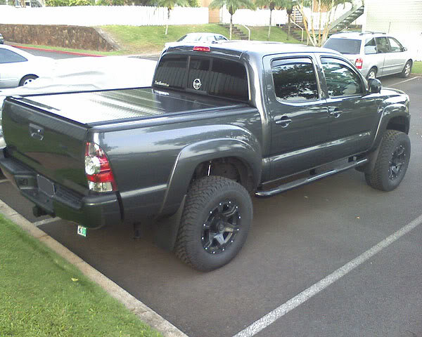

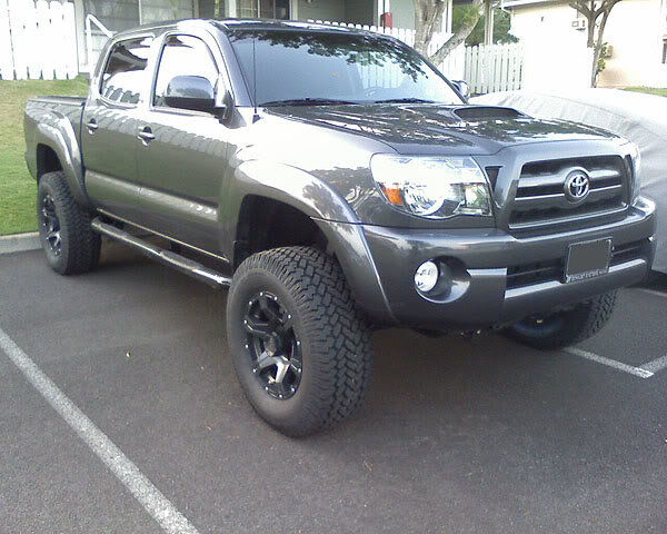

    Been awhile but here's some pics:
    tacolift1_a3f933e3ecdb66b21190428c951cb1d20c6dd52a.jpgtacolift2_00f2d8934920562543f70040ff9d50c2e361ce6d.jpg
