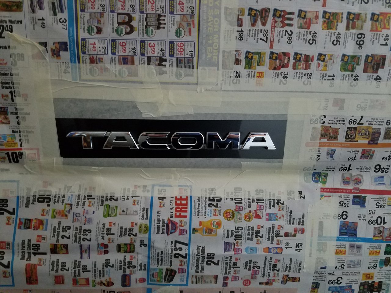

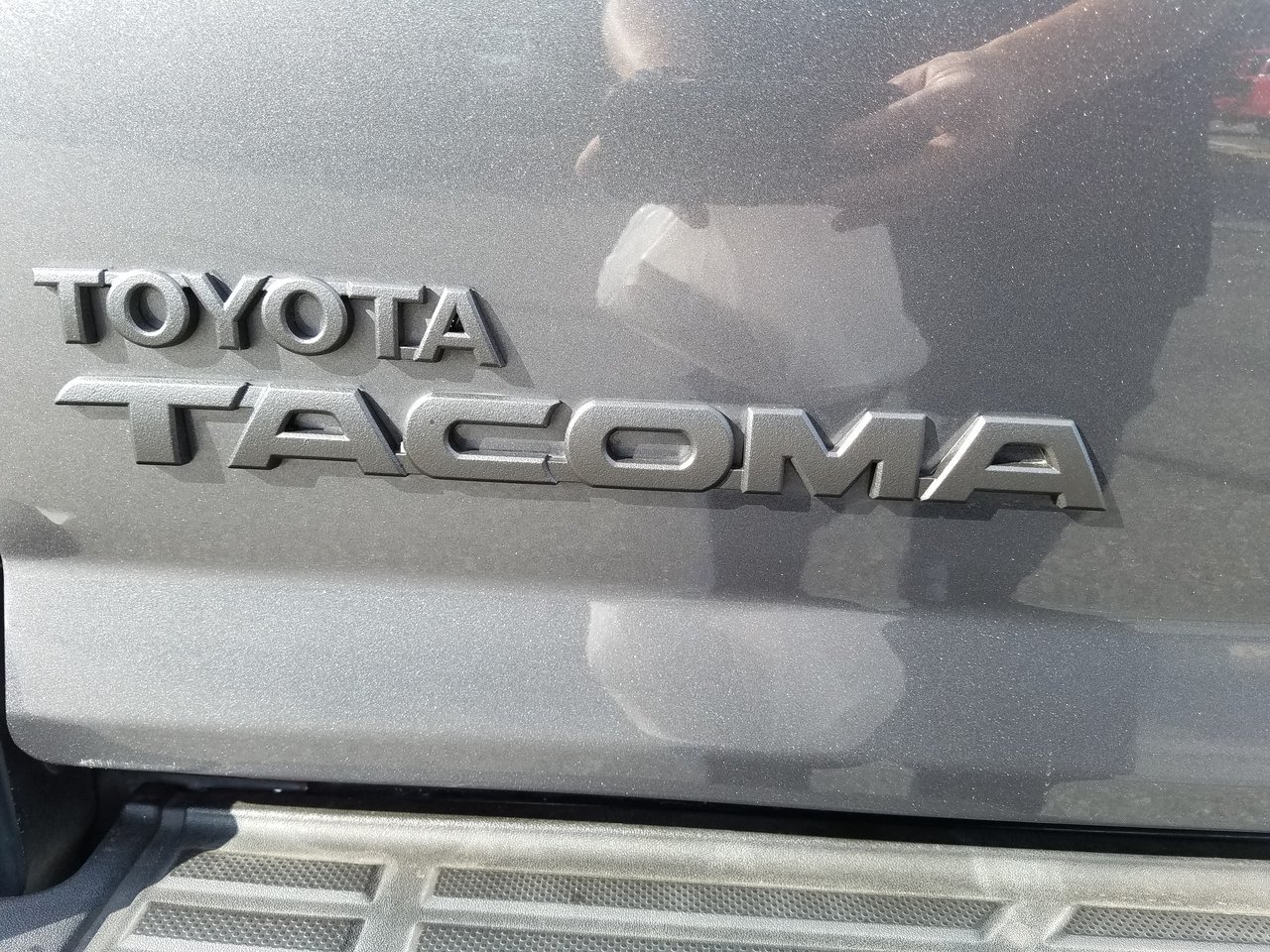

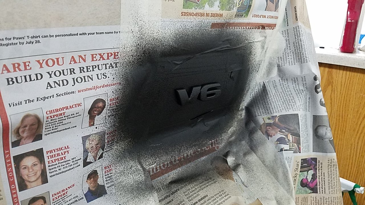

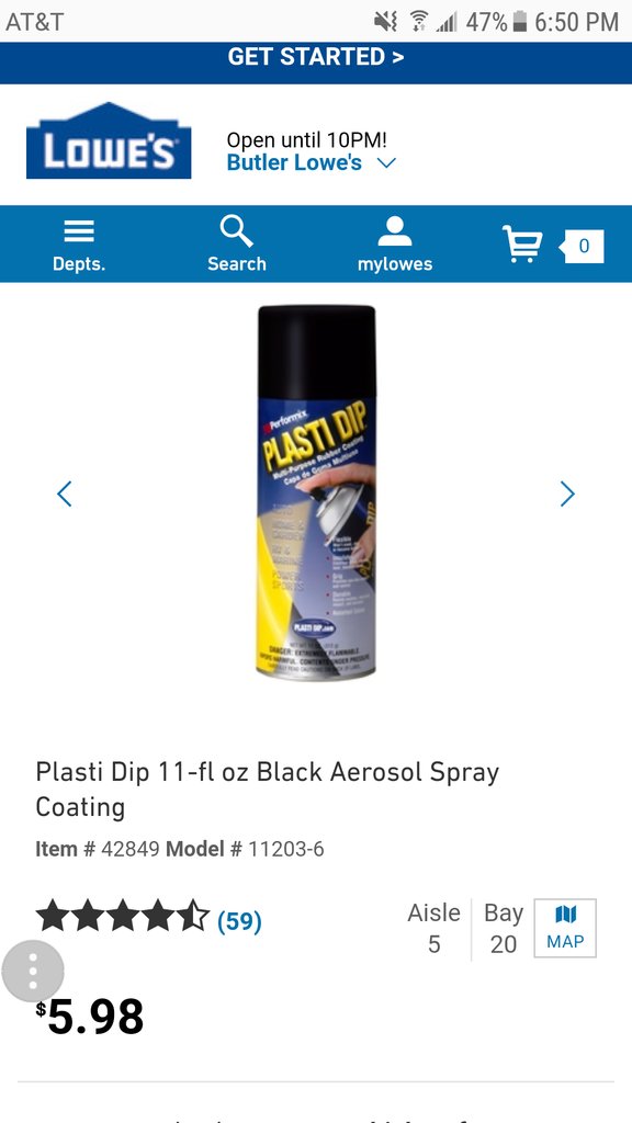

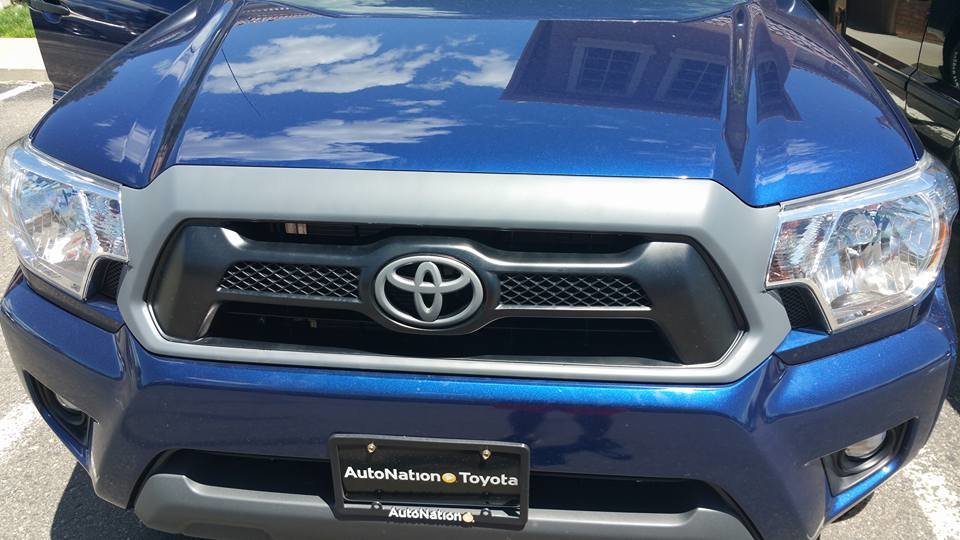

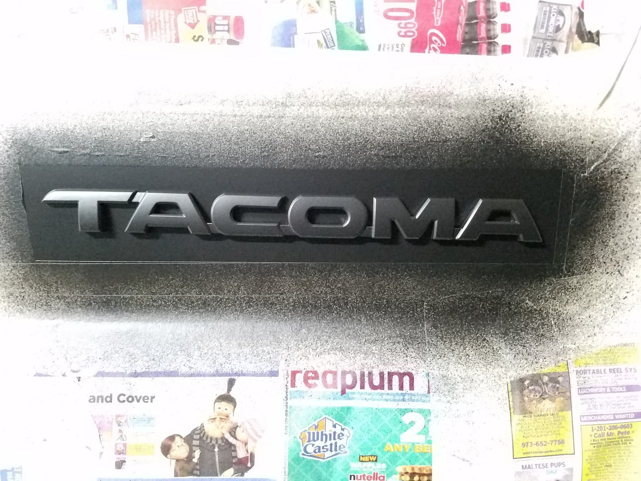

    Saw many videos on Youtube of many people plasti dipping their Tacoma logos. Decided to try it out. Very easy to do i must say. All you need is one can of Plasti Dip ( black.) Masking tape, newspapers to mask of the area around the area you are dipping ( spray,) and tooth picks to clean out the area in middle of certain letters. Make sure you clean your logos very well. I used qtips to clean the hard to reach areas. When applying most videos say apply 5 coats every 30 minutes which i did. And i must say they came out awesome. Looked for a blackout logo kit for my truck. Saw one for $129.00. Plasti Dip was $5.98. Plasti Dip was the way to go for sure . Attached is a short video of a person doing a logo on a vehicle.

    I ordered two cans to do this when they come hopefully this weekend. I bought gunmetal and dark grey not sure which I wanted to use for my badges on my black tacoma. I want a little bit of contrast between the badges and the truck but not a lot. What color is used here?

    Said black on the can part # 11203-6. But to me it looks like Matte black . Lowes has them in stock. And the gun metal gray also. Think about using the gun metal gray also in areas.

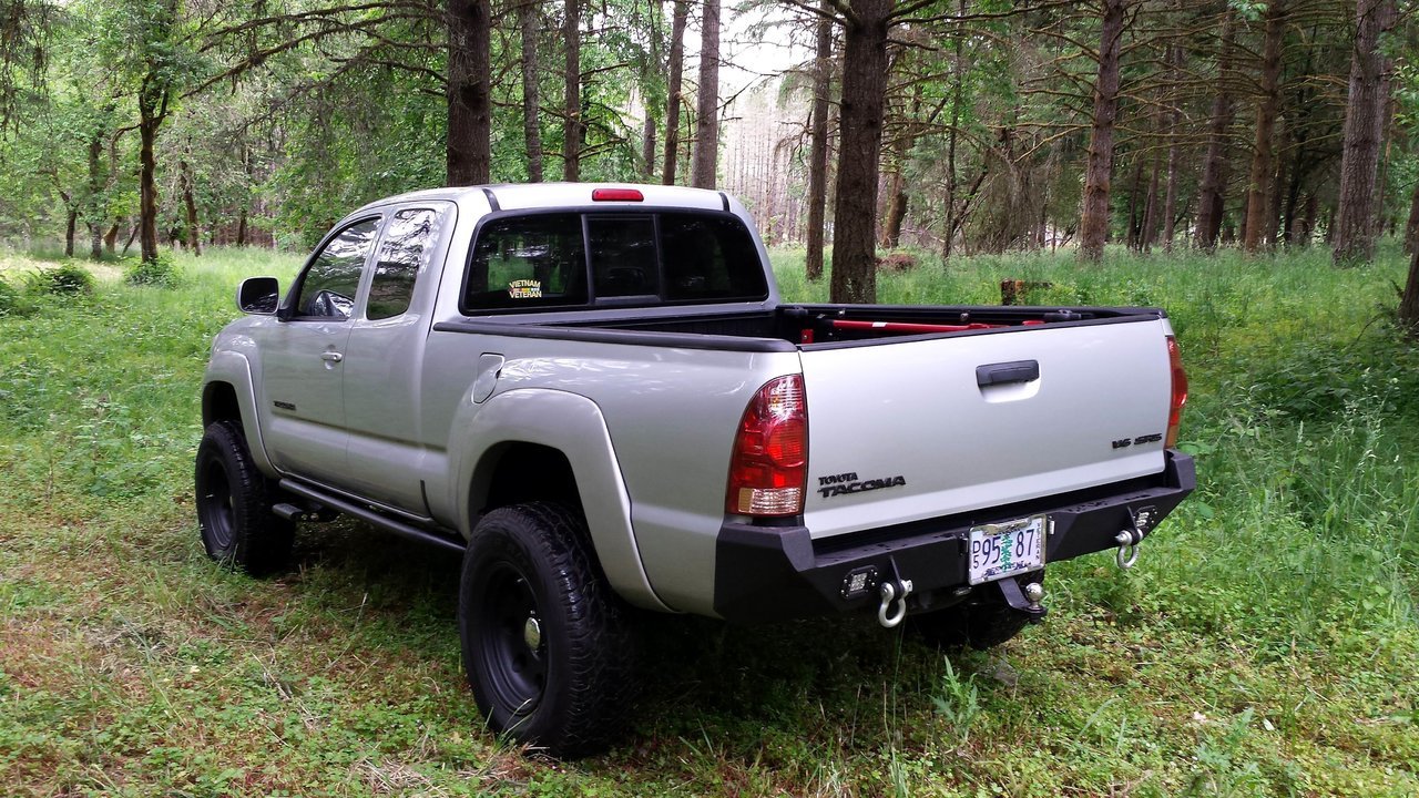

    I did mine about a year ago and they are still holding up pretty well.

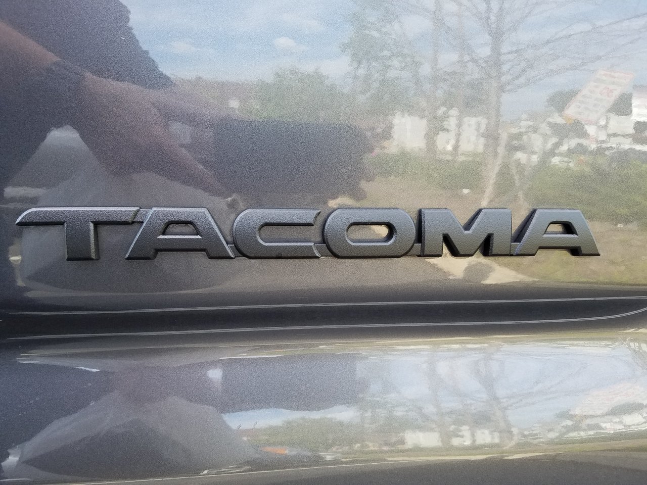

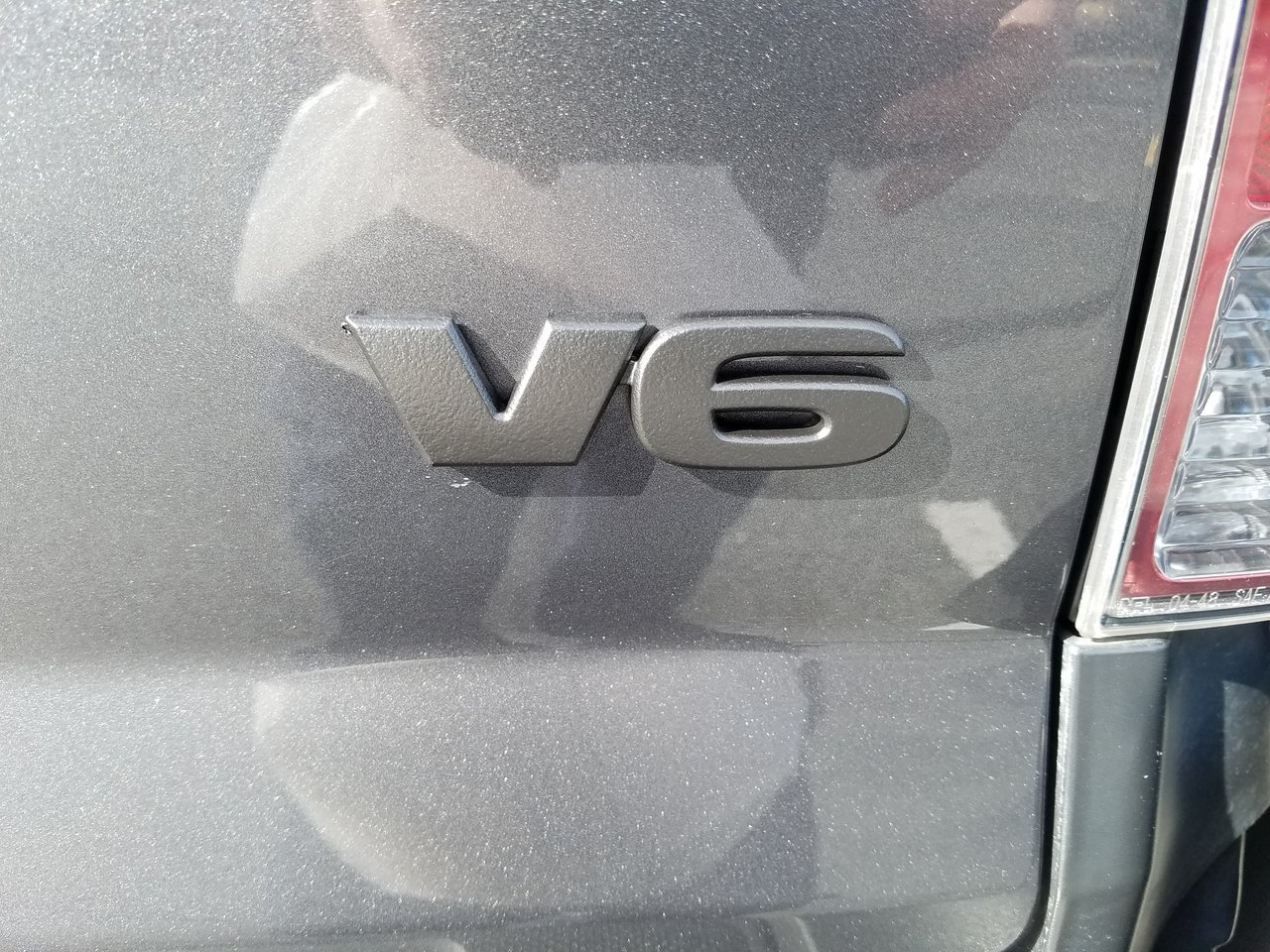

    It's gray. Tried to get a good picture to show the color. The masking color shows the color black better.

    Used the grey on mine (and grill surround and wheels) and love it. I kinda half assed it the first time around, so they're starting fade after a couple years.

    I am planning to do my badges after having great luck with my grill. How do you remove the overspray without removing it from the actual badge itself?
