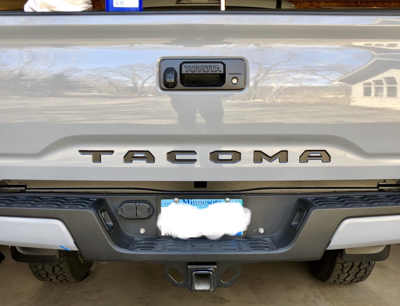

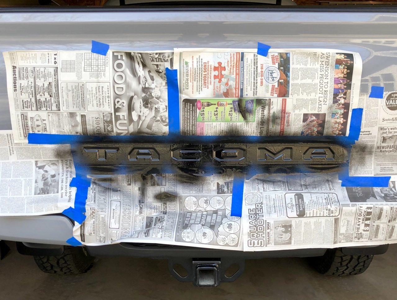

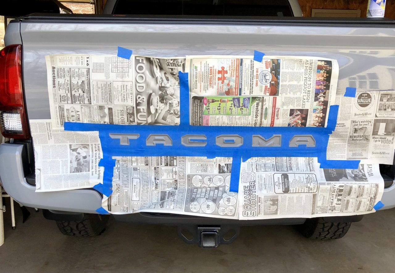

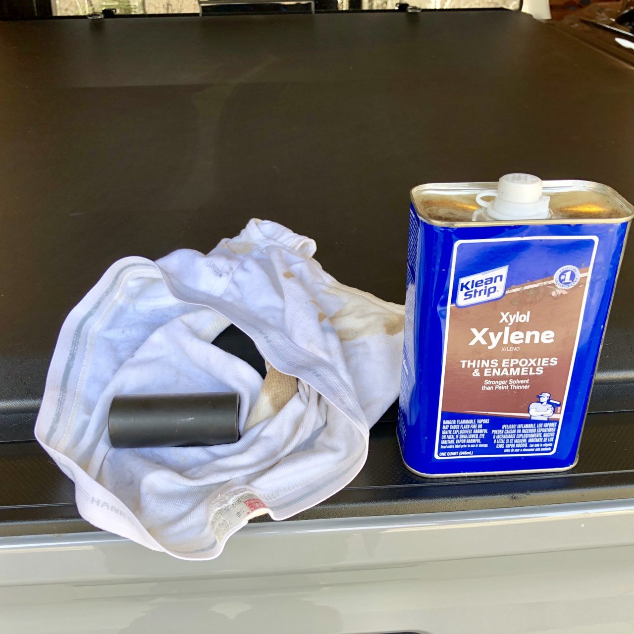

    This is the technique I used:
    1) Tape off as much as possible.
    2) Spray on Plasti-dip.
    3) Remove tape while Plasti-dip is still wet.
    4) Wrap a rag (no fiber) around a deep wall socket, soak the rag in Xylene.
    5) Wipe off excess Plasti-dip.
    Very easy job. As always, patience is the key.

    The difficult (patient) part is wiping off the excess Plasti-dip. Just go slow and use light pressure. Good catch, by the way, on the “Fruit of the Looms.” It was the only clean rag I had that didn’t have a nap.
