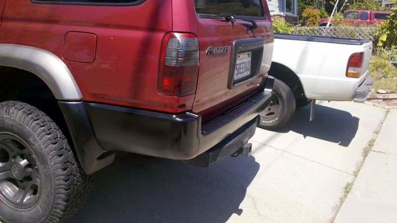

    Krylon gloss black, holding up strong 2 years later
    rear bumper has some scrapes but rocks will take off any coating. Just make sure you sand the chrome very well and use a self etching primer.
