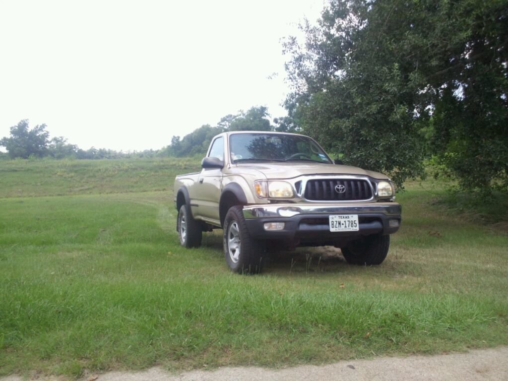

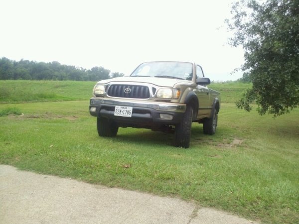

    i did it to my truck, a while back...but, one thing i did wrong was waited till the stuff was totally dry to take off my masking tape...seems like you're supposed to do that while it's still tacky...i kinda want to re do it later...this was when i first got the truck about 3 years ago, and most of it is gone by now
    before
    after

    I seriously see no difference between the 2 pics. Need help...

    haha, i don't either now, to be honest...it was a crap pic on both...
    anyway, it wound up going from all grey and crappy looking to actually a decent kinda matte/flat black color...i did like it while it was there, but like i said, since i peeled the tape off way after it was all dry, it started to peel the stuff off, and it didn't last very long...
    also, i noticed the bit on top of the filler neck goes quick if ya spill gas on it...
