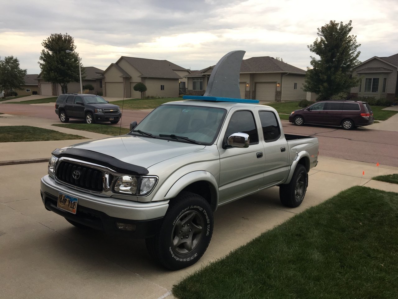

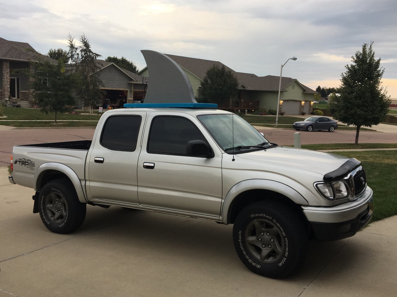

  16. Sep 17, 2017 at 6:22 PM
    #16
    Double Deuce
    Double Deuce [OP] Well-Known Member
    Dec 1, 2016
    #203789
    201
    JJ
    Sioux Falls South Dakota
    Double Cab 02 TRD
    pics of the truck. One from each side. To my eye, there is no question the Black looks better.
    By the way, don't mind the shark fin...thats from a beach themed golf tourney.bedliner 4.jpgbedliner 5.jpg
