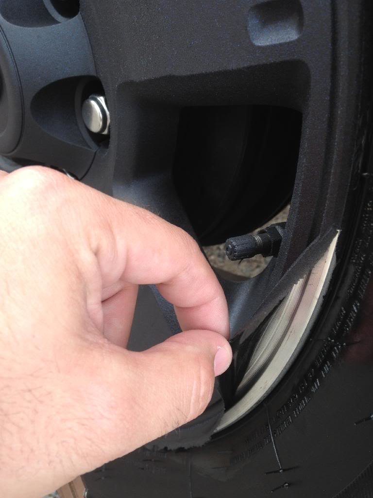

    Has any one had dipped wheels peel after car wash? I dipped my wheels a month ago and had the car washed at the dealership last week and no problems. Today took it to a local car wash and it started to peel. Not just one wheel all of them kinda bummed.

  2. Apr 12, 2014 at 9:47 AM
    StealthTaco
    StealthTaco www.ecgfabrication.com
    Jun 6, 2013
    #105727
    964
    Alec
    NC
    05 Black Tacoma TRD Sport 6-speed
    How many coats did you use? On my last car I used 3 coats on the wheels, the next day I hit them with a power washer and nothing happened.
    Also, did you clean off the wheel fairly well before spraying?

    I did 3 coats of flat black 2 coats of blue metalizer and 2 coats of gloss and yea they were cleaned before... Don't understand why the were all good last week and then this week they got messed up.

    The only thing I can think of is that a rock chip or something started a tiny peel that you didn't see then the high pressure water jets from the car wash made it a lot worse. Plasti dip typically holds up well if it starts to peel...game over. Based on personal experience I'd redo the whole wheel

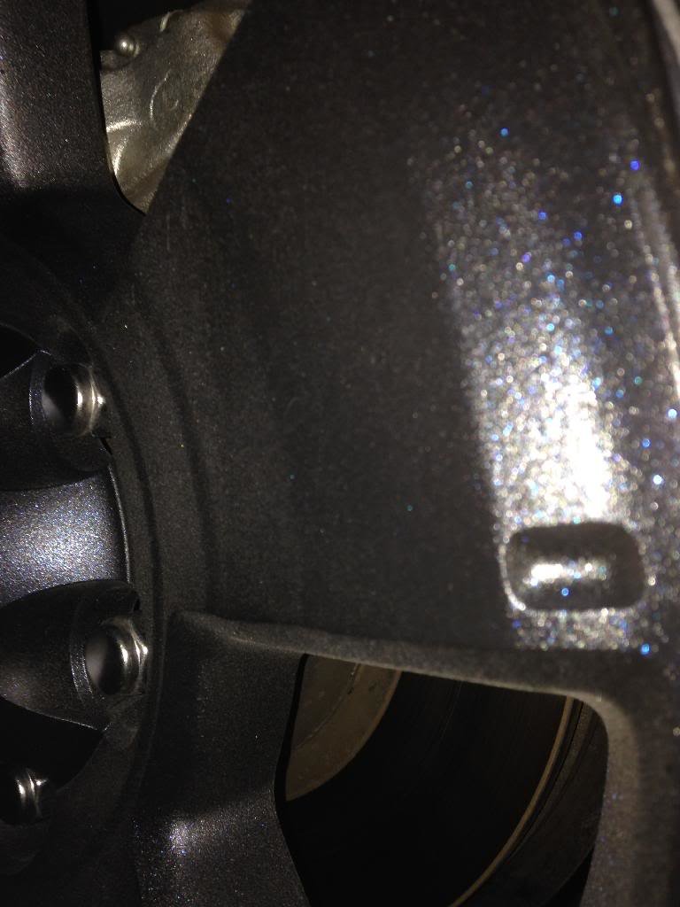

    I did not sand before dipping... Maybe that could cause it. I wish it was just one wheel I wouldn't be so bummed but all 4 shitty. I was thinking about painting them but not sure if I can get the same finish I got with the plasti dip. I would like to keep the blue metallic flake. Hmmm...

    You shouldn't have to sand before using plasti dip, I never have.
    However, you should protect from the overspray between the rim and tires with post-it notes or tape

    In the OP's case, it appears the tire shine stuff on the rubber is working under the dip and breaking/has broken the bond of the dip to the rims.
    I would've cleaned the rims with a solvent, let dry and then spray the dip.
    ... I think he has a bonding issue going on at the seam/rim edge as it's not happening anywhere else..

    I appreciate all the feed back. I think I'll redip tomorrow I'll try sanding and I'll make sure I tape off the tire as well. Hopefully it will go better the next time I'll keep you all posted.

    That's another good thought I will make sure I clean the wheel as well as the tire to make sure I have a nice clean surface to dip. I have noticed a couple of thin spots by the lugs that peel right off... I'm going to make sure I do 4 or 5 thick coats of black and then still do the other colors after to get the same as before.

    I could clearly see the dip start peeling while it was going thur the tunnel at the car wash not saying the the tire shine from previous applications could have worked its way under the dip
