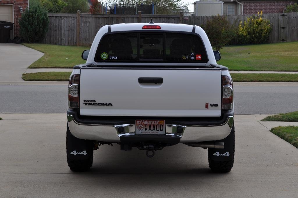

    That truck is filthy. Wash it once in a while.. and do the undercarriage too.
    j/k :)
    I'm amazed as to how clean your undercarriage is. You're a sick man! ;)
