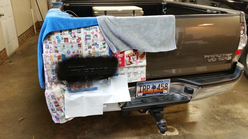

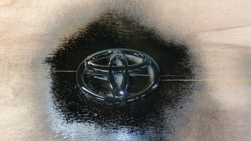

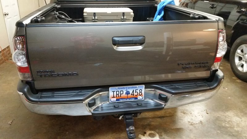

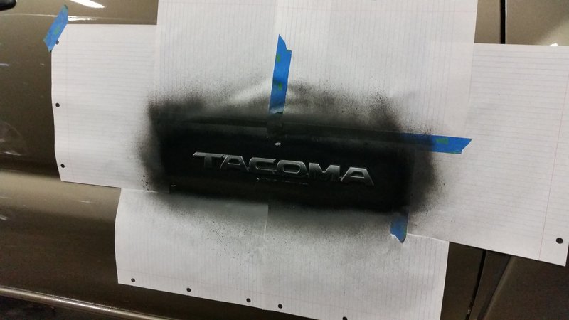

    Just some updates 20151024_115846.jpg 20151024_121106.jpg 20151024_201626.jpg 20151024_201717.jpg 20151024_201739.jpg

    Well done, man. Very clean.

    I have always de-badged all of my vehicles, and I was a bit skeptical, but this came out pretty nice! Still prefere de-badge, but if you gonna have 'em, this would for sure be the way to go! Nice work!

    Are you guys pulling the emblems off, plastic dipping then putting them back on? What are you using when putting them back on? Doesn't seem like masking would be very clean...

    Many guys leave them on and do it. Overspray onto the paint will just peel off, so no worries there; however, you still want to keep the spray line close, to avoid it all peeling off at once.
    Some guys have used toothpicks to lightly 'carve out' the inside gaps of the letters and/or carve out the outline of everything.
    It's doable either way - just depends on what you are comfortable with. Doing it on the truck saves time, but is a bit more difficult to get perfect - but plenty of guys have done it with great results!

    You be careful with those Chemical Guys microfiber towels!!!

    Derp the bumper too :thumbsup:

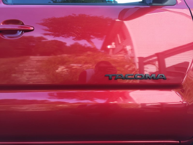

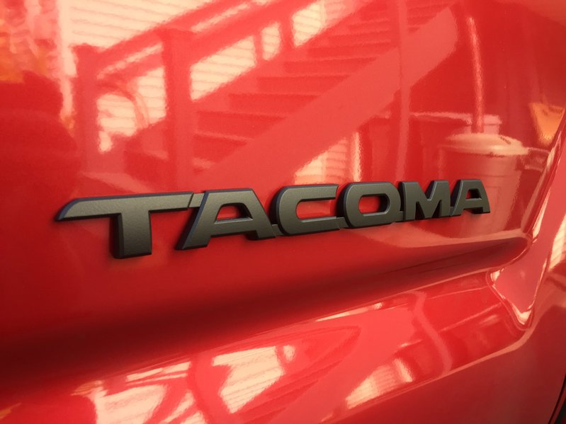

    Think it looks awesome on the red. Super easy to do.

    Wow that looks really good on red! I like mine but it doesn't look as good on Pyrite
