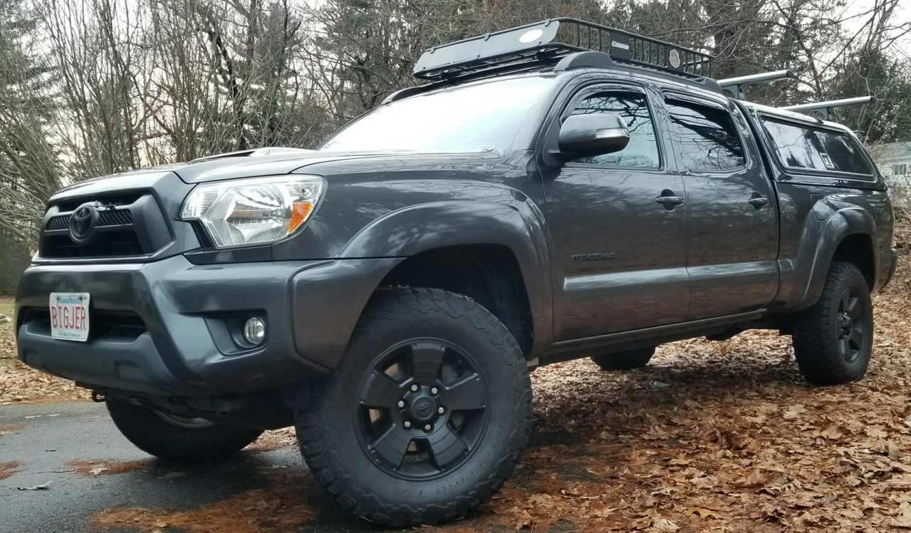

    I do it once every 2 years. I put on 5-6 light coats for an even coating. I live in MA and have zero pitting or rust on my TRD sport rims. It is one of the main reasons why I did it in the first place. 6 years old and look brand new. The great thing is, you can peel it right off afterwards if necessary.

    Nope, I used the black. I wanted to "murder" out my chrome TRD wheels since my truck was MGM color

    Car washes through golden nozzle is fine. I go through it at least once a week. I used four cans, but bought a fifth just in case. I did 5-6 light coats to make sure it was even and not runny. I would just take off all of my wheels, having the entire truck on jack stands, place them on the grass (knowing that I will mow up any overspray, ) and I put playing cards in between the outer rim and the tire (so it doesn't get on the tire and give it a clean edge). It is ok the get in on the tire put I just wanted to make it look clean.

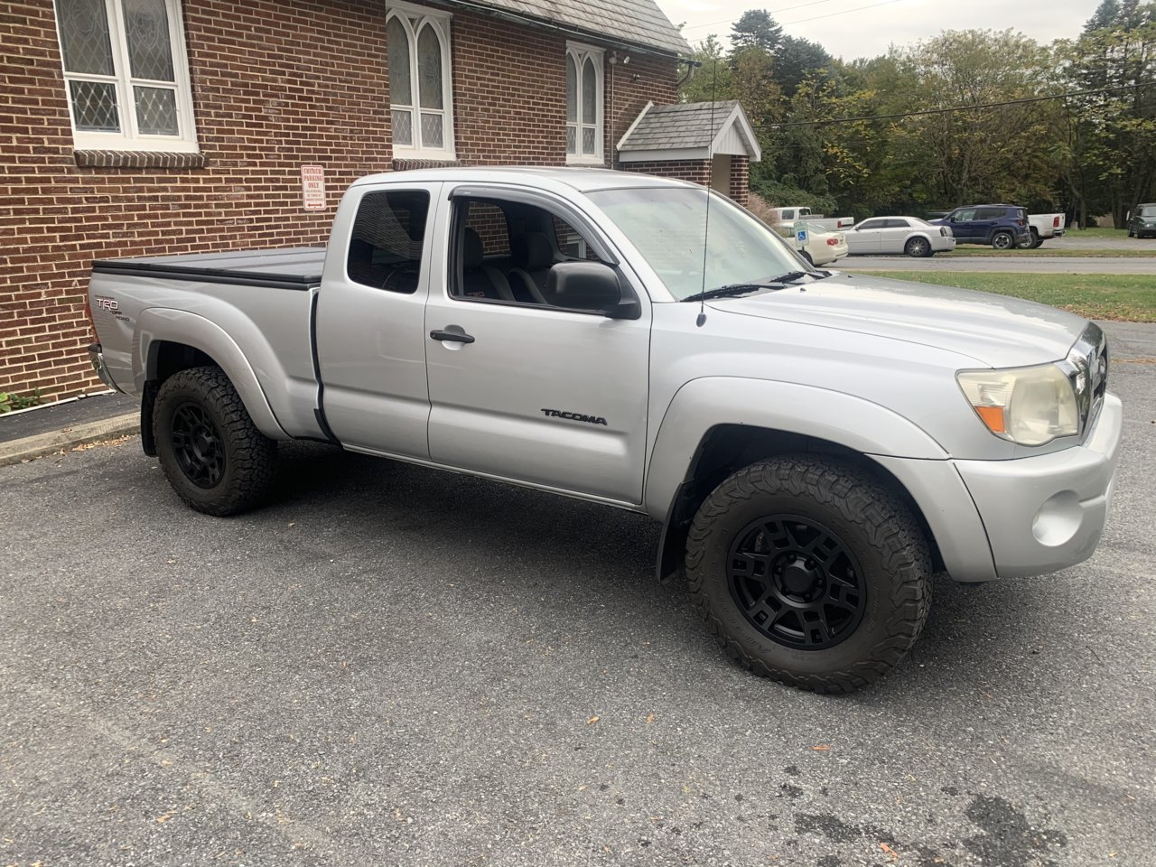

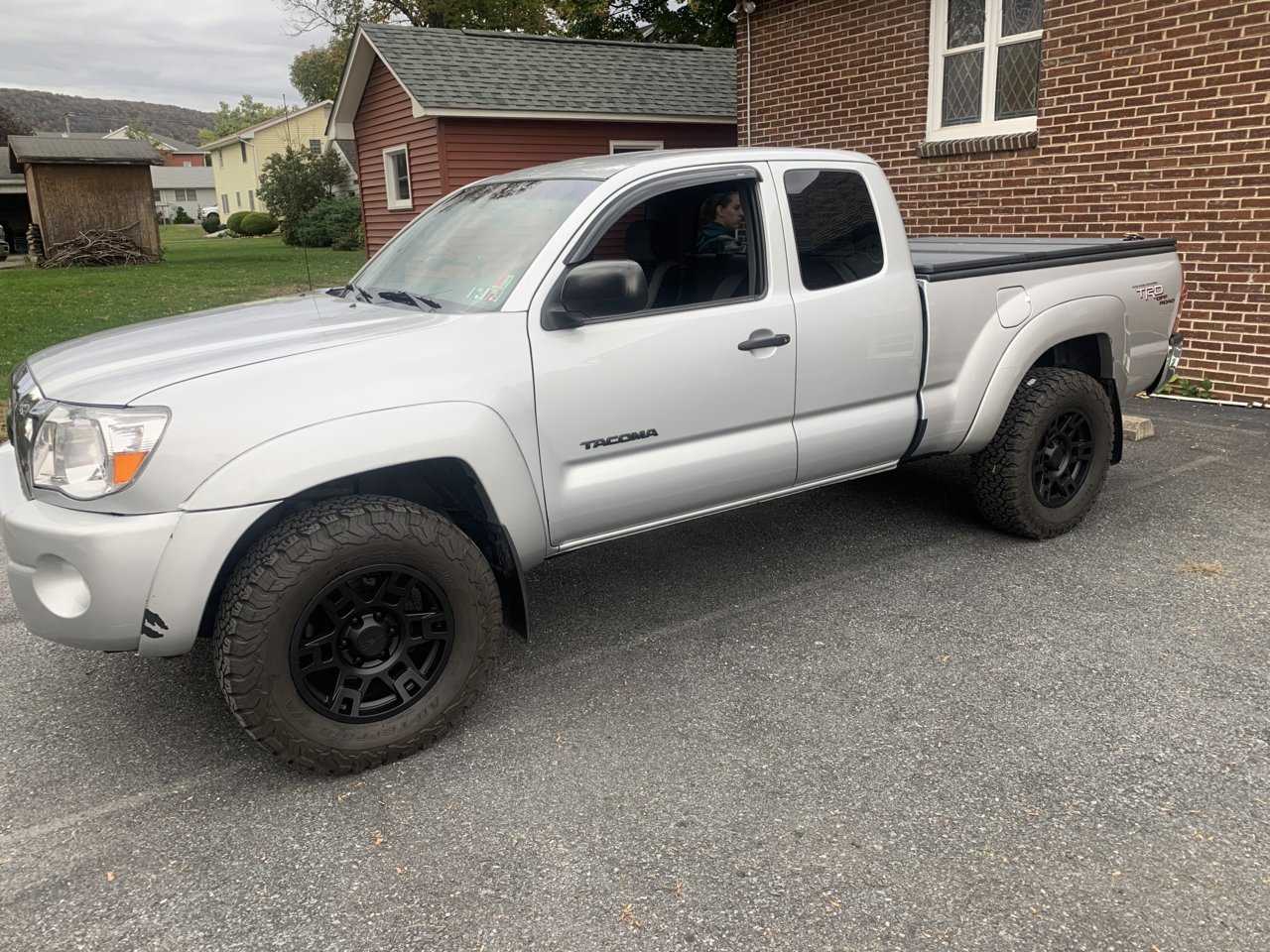

    @crashngiggles so I did my rims and emblems to , they turned out great I think !
    Thanks for your input and wisdom, I also sprayed over the center caps (I tried to get them off but wasn’t successful ) . I didn’t take the wheels off the truck, just taped and masked around them and wrapped newspaper around my drums and discs . I painted a few coats then rolled the truck forward a 1/2 wheel turn and sprayed. Few more coats then rolled the truck forward a 1/4 turn of the rim .
    I ran out of time but I want to try to “trace” out and cut out the red trd in the center caps .

    They look great! Super easy right? They will last about 2 years before you will start to see some peeling. Then when you are ready to redo them, take a very good pressure washer to them to get off as much as the old stuff as possible and them repeat the coating process again.

    Yep it was easy , the plastidip is very forgiving and the nozzle on the can works good . I tried the playing card between the tire and rim but it didn’t slide in between. So I just used newspaper and masking tape .
