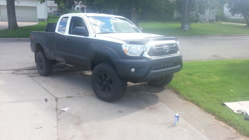

    Traded the 2015 TRD Pro 6spd Supercharged on a PowerWagon and could not be happier. My 2011 Tacoma with the TX Baja package (Added by me) is still treating me great. My 1985 Toyota never skips a beat.
    time wise i spent about 6 hours including washing it, quick wax job, and then i cleaned the surface with invisble glass spray can cleaner
    i used 18 cans (discount by the dozen online) cost about $130
    bought 24 but 6 were red. bed has 5 coats but i ran short on the cab and only did 3 coats, thats why the bumper never got finished
    i would rather buy it by the gallon and spray it from gravity or can feed gun but i cant get the water out of my cheap compressor even with twin filter/seperators i just gave up. then one bursted a diaphram and i ditched the whole setup

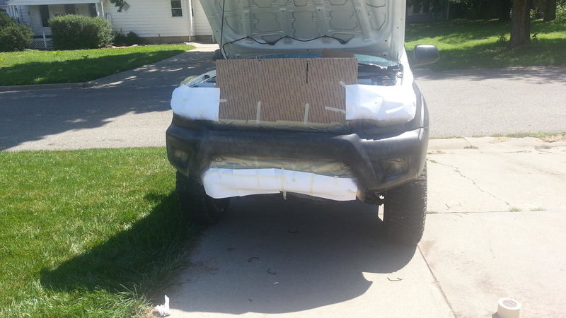

    i plan to dip the front bumper at least. still undecided on the hood. i just have to get more material :)
    and yes one thing im learning with my no regrets lifestyle is sometimes it pays off in stress later if i take a few precautions along the way... like putting my seatbelt on :) changing the drivetrain fluids and greasing things :) ive always been good about the oil etc. but im getting alot better about fixing things BEFORE they break.. unless we are talking about the 81. i preffer to see how far it will go broke before i fix it. then it gets a round of repairs and hammerd on some more.

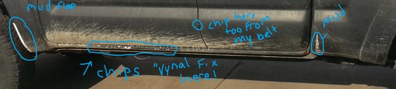

    I plastidipped my rocker-panels and fenders... used 8-10 cans too; so, it wasn't light
    Every time I or someone else whacks their boot against it, it peels up in that area; and I have to touch it up
    I can't imagine how often you're going to be touching this up; and unless you take a lot of time to perfectly blend it; how patchy it will eventually look

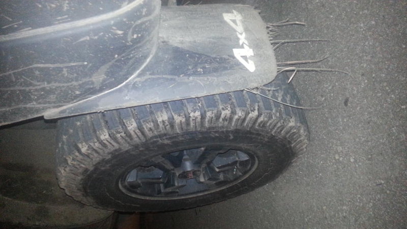

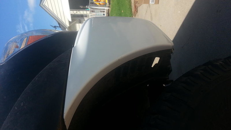

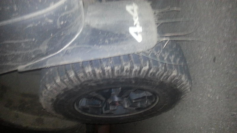

    i have not touched it up at all yet, and yes thats a good point right on the door sill it rubbed off on mine too, the solution i was thinking (brainstorming here so laugh away) is putting the thicker coat on the cab, then in the high traffic area where my boods etc rub i want to get like 4 inch vynal (the kind that comes on a roll on ebay and ricers use for rally stripes) and applying it over the dip on the rocker, super cheap and tough, and theres no compound curves so should be easy to put it on without bubbles, and with the plasti dip layer the vynal wont be hard to peel off in the future. hell the vynal will probably pull the dipp off with it!
    the white on the back of the fender flare is where my mud flaps were.. they pissed me off so they went, and like i said i havent touche it up yet.. been right at 6k miles and 4 months

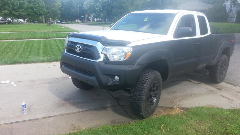

    its funny you say that. i splashed a little gas all down the side in a line with my busted gas can and :eek::eek::eek: for a minute, thought for sure it would run off but i :cool: left it bee and it dried out just fine. there is one spot about the size of a fingernail right under my drivers window where something i spit out or dripped on it who knows made a small droop mark i though it was like a bird poop shadow (dont know how else to describe it) but its barely noticable at all now that whatever it was the color has blended back in,
    the body shop manager at toyota was very nice older man and he was pretty worked up stressing that he couldnt get the marks from what looked like they sprayed the truck with armoural then tried to spread it off but when i went back (they forgot to fix the frame) it was normal looking not sure what they did. i told him its fine i just use regular water and soap in the pressure washer to clean it i dont scrub it or wax it or anything like that
    and thanks about the pic.. thats my super duper "paint" skills coming out :) it get the job done

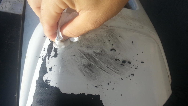

    these pictures show the thin issue I talked about, it couldn't peel off.
    today I tested the wd40 theory and
    A PAPER TOWEL AND WD40 ARE THE EASIEST WAY TO REMOVE PLASTI DIP that wont peel off!
    spray the wd40 on the dip generously and let soak for a few minutes then scrub away with a rag, once the big stuff is gone I spreayed wd40 on the rag and it wiped the residue clean off. then I washed the wd40 off with soap and water.
    then I resprayed the truck.

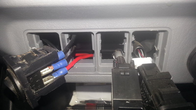

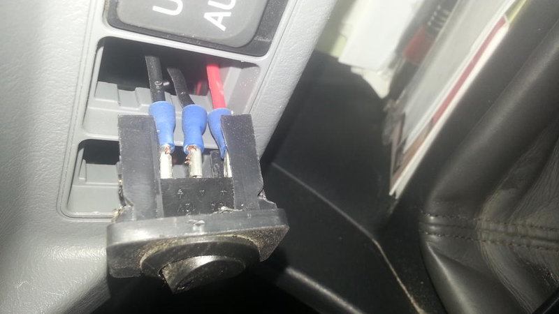

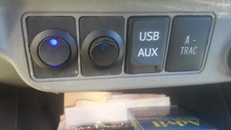

    I also rewired and fixed the switches for my rigid light and took a pic of how the switches fit in the cut blanks
