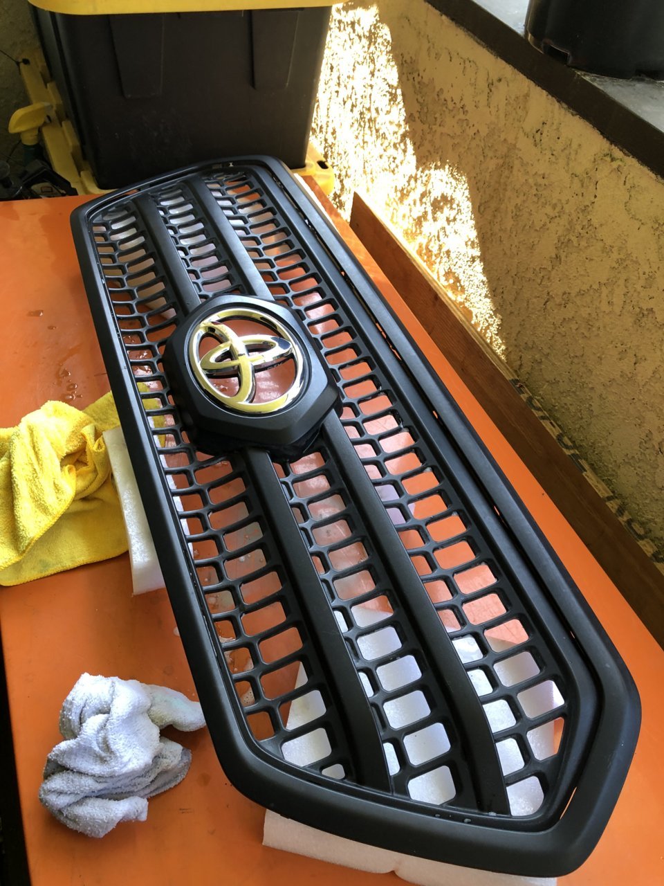

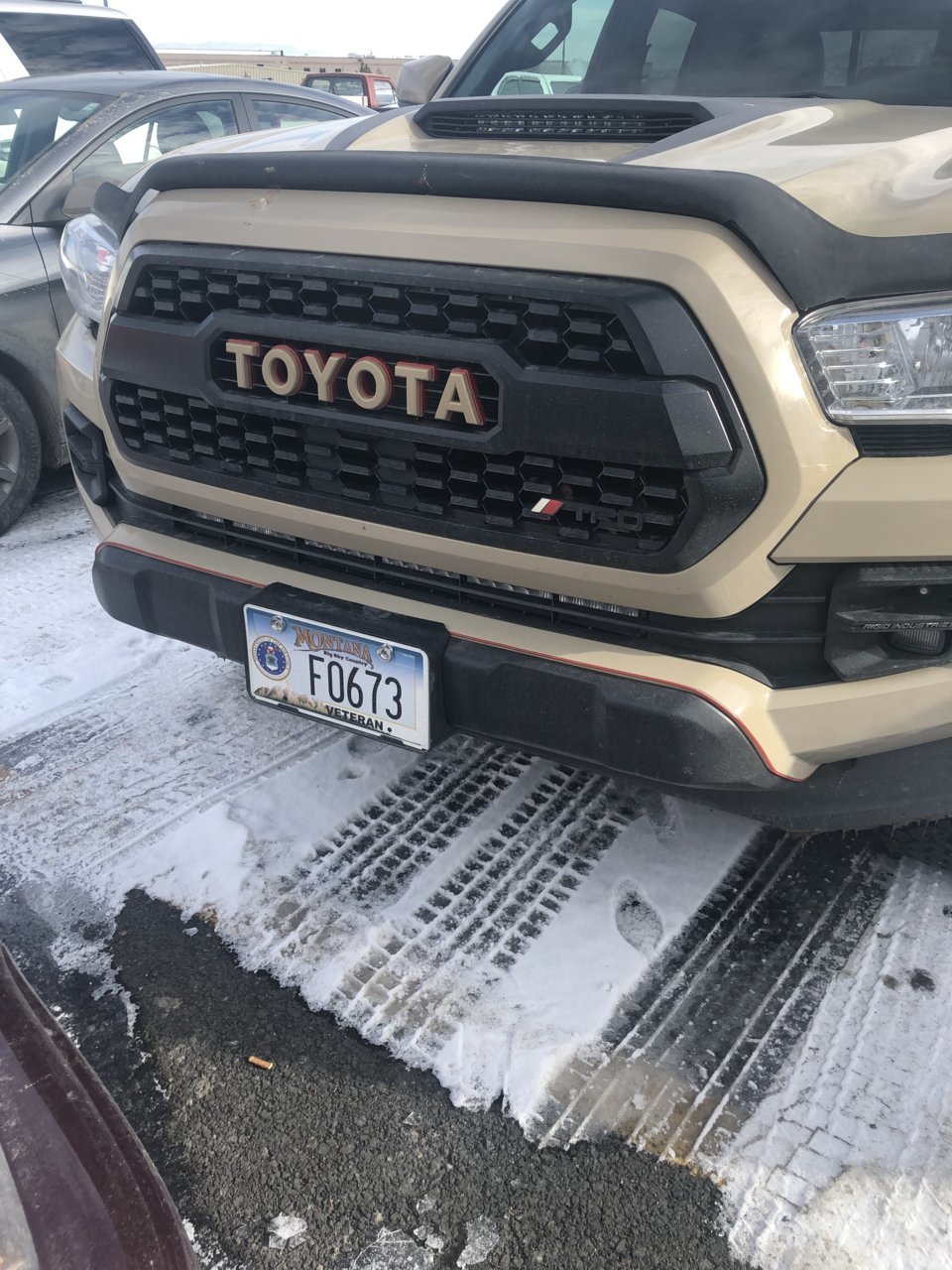

    I'd do plasti dip, just clean it with soapy water and then do a quick wipe down with alcohol. I did my grill 2 years ago and still looks like I did it yesterday. I also used the whole can on the grill. it's 5 bucks for the can and doesn't take too long either. use that or bedliner and it will hold up great

    This is pretty cool. I have the same one that is all chrome and I hate it but don't want to spend a couple hundred on a brand new grill. How easy was taking it off and putting it back on?
  12. Jun 10, 2019 at 1:08 PM
    Wengel21
    Wengel21 Well-Known Member
    Jun 6, 2017
    #220898
    346
    Ben
    SoCal
    2017 DC LB TRD OR
    To take the grill off the truck less that 5 mins and 4 fasteners (2-10 mil screws and 2- pin fasteners) and then to remove the grill from the outer frame maybe about 10 mins, the clips can be a pain in the but, but take your times maybe heat them up with a hair dryer so they're not too rigid. I pull off my grill yesterday to put on a bootleg OEM pro grill, took me less that 10 mins. not hard at all. unscrew all the screws and pop out all the tab clips and you're done.
    I was in the same boat as you, I didn't want to spend a ton on a new grill and wanted to save up money for a new one. Plastidip was perfect.

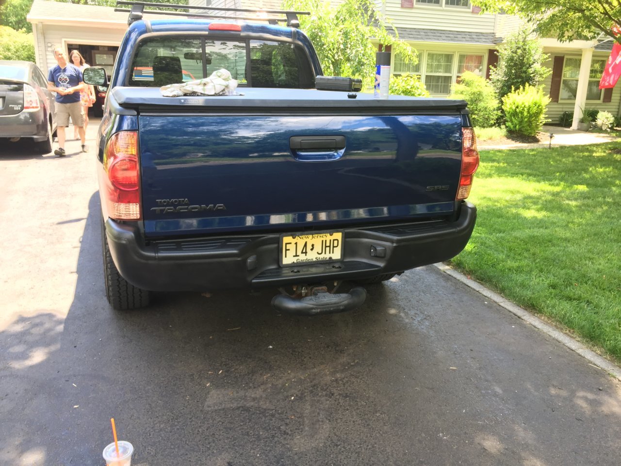

    I just plasti dipped my rear bumper and badges. I took the plastic off the bumper and cleaned it real good with tire polish and kept the bumper on the truck. Turned out great
