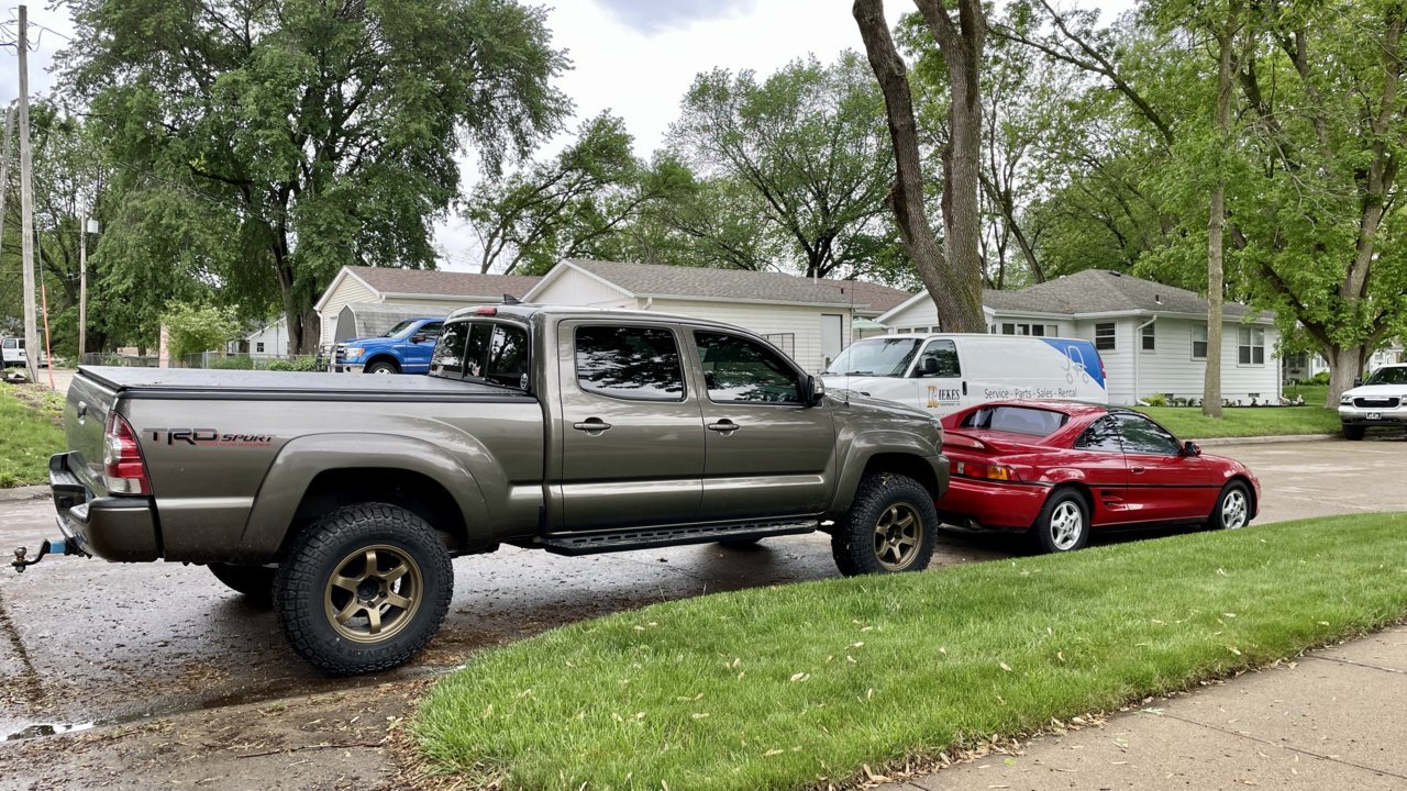

    There are so many variables with any paint or coating to be durable. If proper prep is done plasti-dip will last many years and hold up to quite a bit of abuse. Just the same, if prep isn't taken into consideration even powder coat will not last long. I had new tires put on a couple months ago on my dipped wheels and they only damaged one area on the outer edge of the lip of one wheel (on the right rear) about the size of a dime and you can hardly even see it since the "rim protector" of tire that overlaps the lip pretty much covers it up. If hammer on/lip mounted wheel weights are used then yes it will be damaged. But that goes for ANY coating whether it is plasti-dip, paint, powder coat or factory coated wheels. You can request the tech to use sticky weights to avoid that from happening so all the balancing is done on the barrel of the wheel behind the face. This is the first time I actually put time into prep work and read how to properly apply it. I have used dip in the past and experienced exactly what you are referring to with fade and peeling over time.
    Mine have been holding strong for 3 years with no noticeable fade or additional damage. I have used all sorts of wheel/tire cleaners, degreasers, my pressure washer, car wash pressure washers and drive through touchless washes. I did however use the plast-dip "satinizer" clear coat which advertises that it adds UV protection, so that probably plays a role as well. If I remember right I have 2 coats black, 4 or 5 coats bronze/gold and 2 or 3 coats of satinizer clear coat.
    EDIT: My truck has never been garaged so what you see in this picture is the result of 3 years of use and never being out of the outdoor environment.
    If you check out DipYourCar.com they have TONS of colors!!! They also have kits for wheels, their recommendation is one can per wheel. I would highly suggest getting a couple cans of clear coat as well since it will help protect against color fade from UV or harsh cleaners. Check out some of their tutorial videos as well, it helped me out a lot and I though I knew how to prep and spray dip. lol

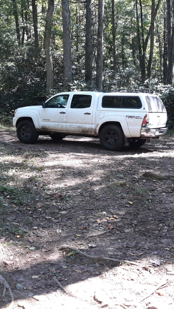

    I wanted black wheels but couldn't commit to spending crazy money on a new set yet so plastidip is working for me for now
