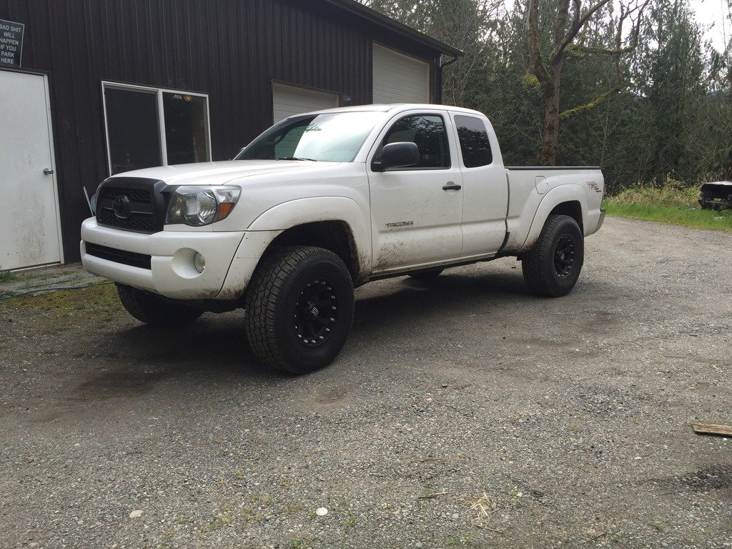

    I just derped the whole grill. Removed it first of course.
    If you decide to dip he emblems just tape two - three inches outside of the emblems and let it dry completely before you peel it off. If done correctly the dip will stick to the emblems and separate at the seams between them and the body panel

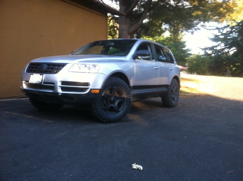

    Also if you're looking to do clean sharp lines make sure you paint everywhere but the edge of the tape line first, it's important for the plastidip to still be wet when you peel the tape off for a clean line
    my old Touareg was dipped from the rocker panels down, the mirrors, wheels, grill and rear emblems
