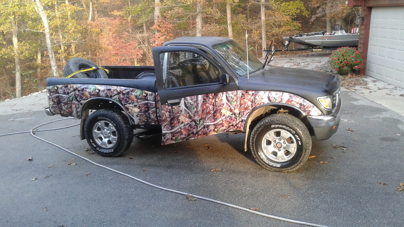

    This isnt herculiner but ist rust oleum bedliner. Everything you see black is the bedliner. Two coats of bedliner and two coats of glossy clear coat keeps it looking shiny after the painting. Looks great and works great!!
