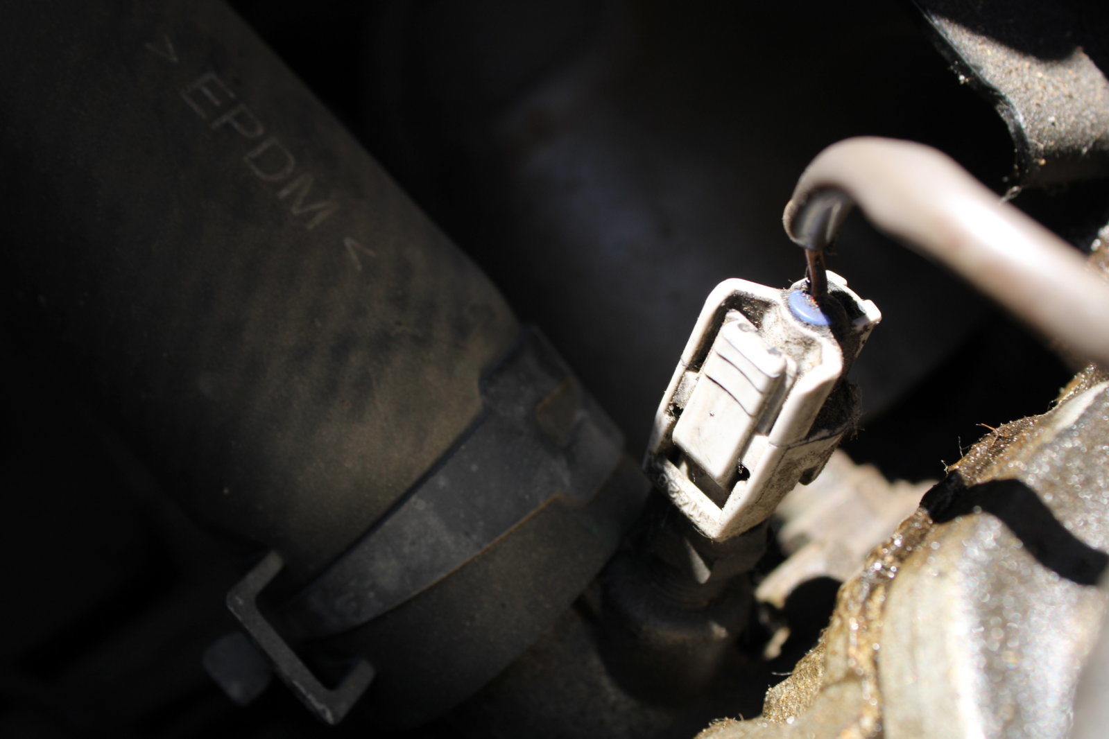

    I need a little help. I am terrible mechanic. Attached is photo of plastic wire connector from the top of coolant temp sending unit or sensor ( the front one) What is the trick for un attaching this thing from the sensor before I attempt to replace the unit? IMG_0240.jpg

    Squeeze the tab near the top where the wire comes out

    22 SR5 DCSB 2.7L
