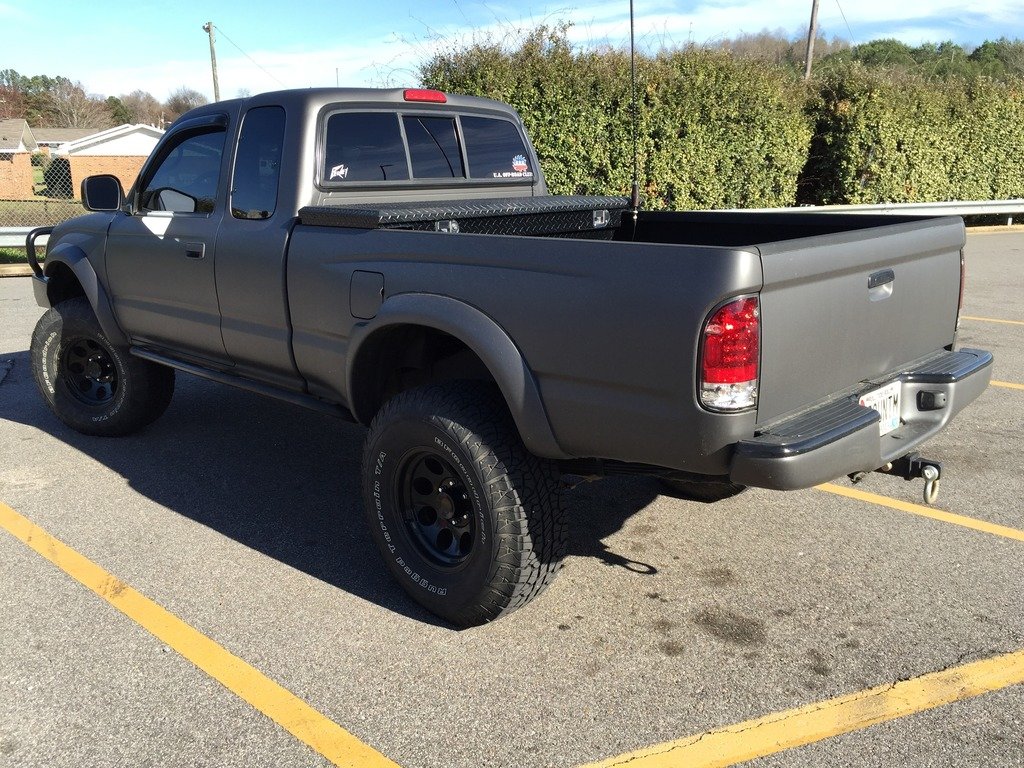

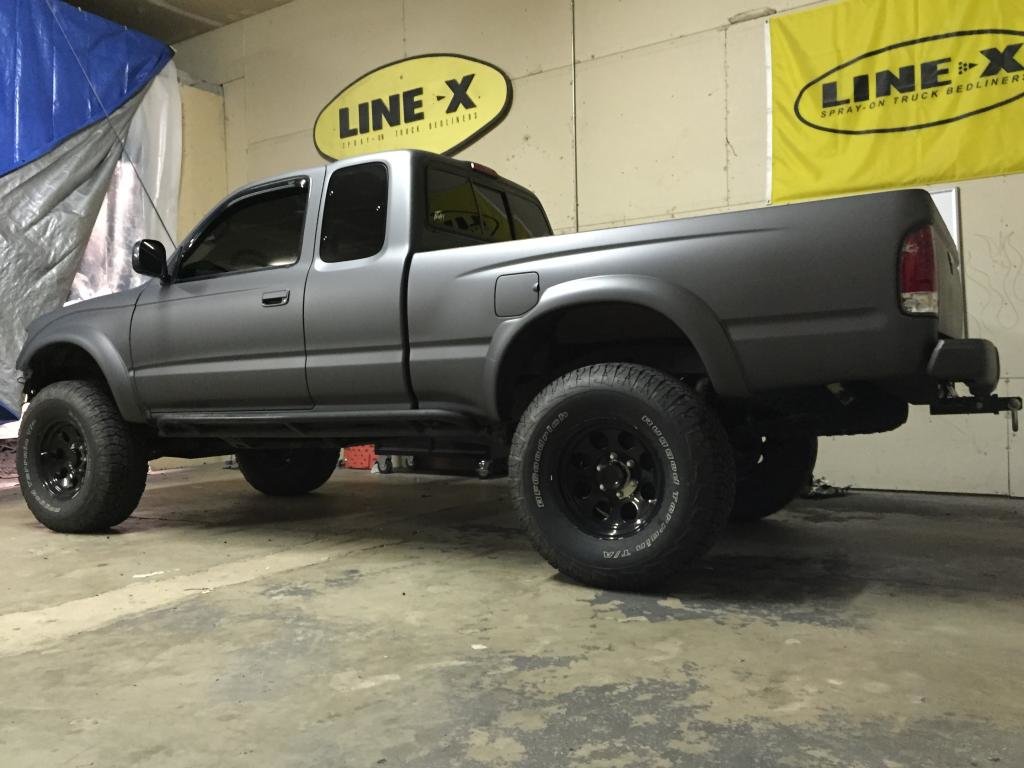

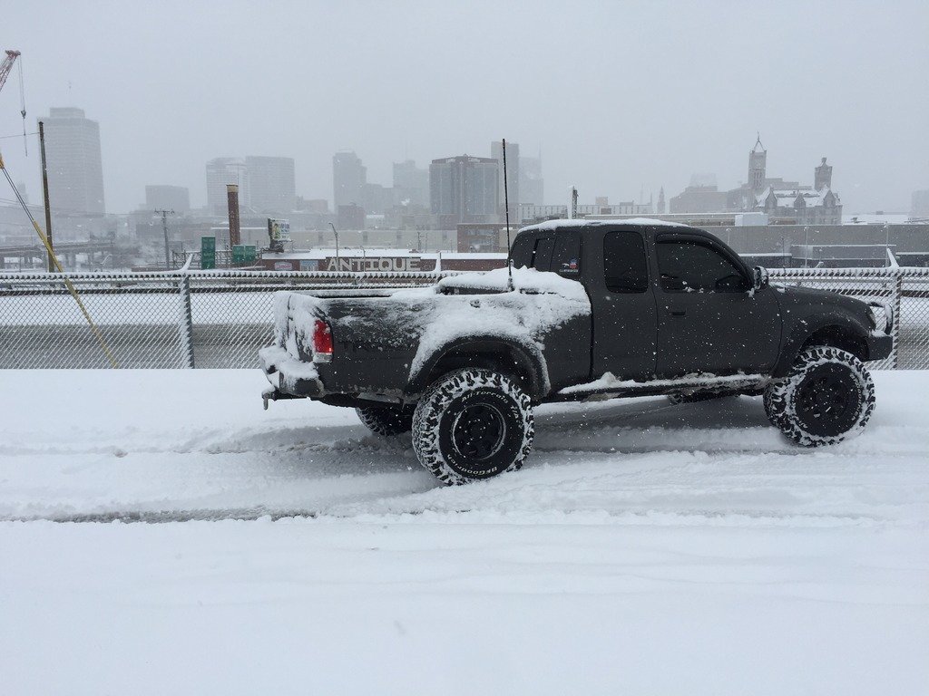

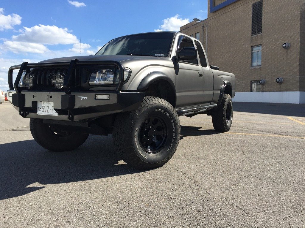

    The anthracite is a nice color in the sun, and has more of an aircraft carrier color when it's cloudy. I'm biased to this color, but here are some pics of the anthracite.

    thunderone, is that a professionally done plastidip job? that looks incredible!!!
    i know this is a recent post, and not sure how long you've had it on, but how long do you expect it to last for you?

    It's supposed to last 3-5 years. But already being a matte color odds are it won't fade much. This hood has been through I don't know how many of the beat the crud out of your car type car washes. It's whatever dark grey color they have in the rattle cans, 3-5 coats.

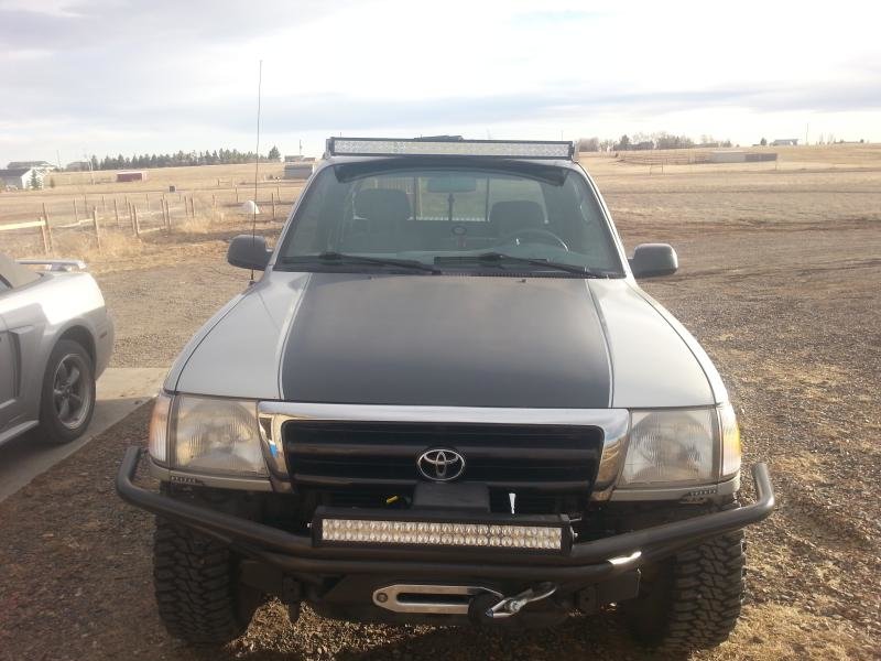

    I've did my front bumper and bug shield with plasti dip and they turned out great, but I didn't like them on the flares. I had plasti dip on the flares for a few months and they looked awful because of all the rock chips and chemicals they put on the roads here. I just redid them with krylon paint. Looks way better IMO.

    Sorry for the dirty pics....the bug shield has been on since last June. The others were just done within a month

    Did it myself :) it has been almost exactly one year since it has been applied. Other than a few rock chips and a couple of spots where it is raising (easily repairable with paint thinner and some spare paint leftover and a small brush), it has held up great. You can use turtle wax ICE or a synthetic wax and it will continue to repel water for a long time. Been six months since I applied wax, still beads water.
