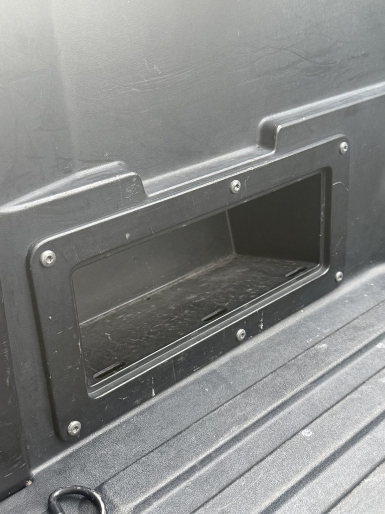

    Trying to find the plastic door that goes on the bed compartment.Have no idea of name/description.Hopefully this picture uploads .

    Junk yard or order from Toyota if available

    Or make one.

    Or replace it with one of those locking doors. You can get the more secure assemblies that drop down and give you more storage area or there are cheap Chinese doors on ebay and Amazon that retain your stock cubbie, just replace the front.

    The std cubbie covers are a joke IMO, easily stolen, not secure and way overpriced for what your getting.
    These are super easy to make, I used 1/4" marine grade textured HDPE, some alum and a lock set. Probably cost about $30 to make both of them.
    A single slot is required for the lock. I filled the other unused holes with silicone and sealed the whole assy into the bed with silicone.
    I've had these on both cubbies for about 4 years now and they look the same as when they were installed, the marine grade plastic isn't affected by UV like the std version.
