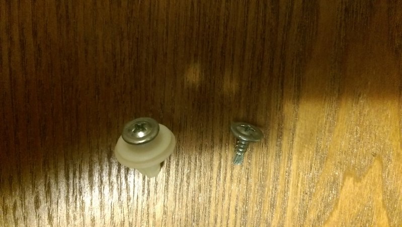

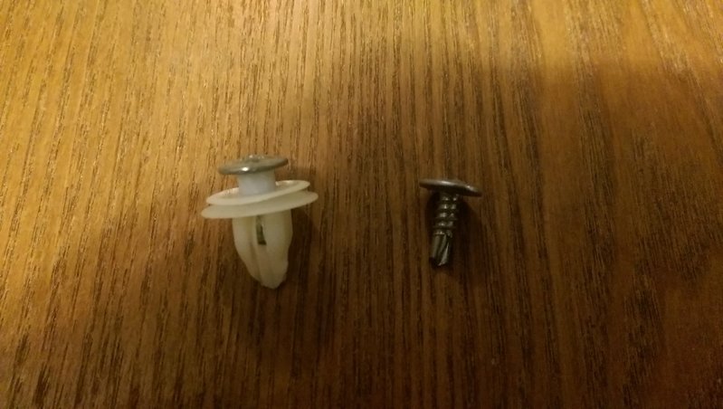

    I don't know if it helps anyone else but I thought I'd post this. I seem to break one of those plastic rivet / clips every time I pop a panel off, especially when it's cold out. While reupholstering the seat backs on my Access cab, I busted like 4 of them. It was really cold out and after hours when I put it all back together. Plus, I'm getting tired of spending money on these things. This time, I took the broken ones and secured them lightly with a pair of pliers. I drilled a small hole in them and ran a self tapping screw for metal studs into them. Voila. They are stronger than before and slide on and off like the unbroken ones. Hopefully this helps someone out. I'll be doing this from now on.IMAG0877.jpg

    I popped my back panel off again, broke two more. Ran a screw into them too. The ones I fixed with a 3¢ screw; still solid. Although, I am gonna keep you in mind Chris. Thanks for offering that up. I'll be in touch.
