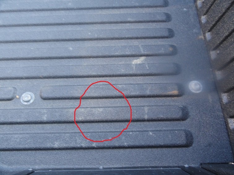

    Hello all. Yes I got a plastic bed line-xd. My snowmobile tracks are spiked and ruined my truck bed from the beginning. Also, I had paint marks all over it when I bought it from the first owner three years ago.
    As the bed flexes, I hear a weird noise. I am able to jump on both sides of the bed (near the rear, between the where the last and 2nd to last bolts are) and it just click crack noise.
    This is driving me insane. Brought it to line-x. They torqued the bolts down. The noise went slightly away. But is now back again.
    I am told it is because the "line-x doesn't allow the bed to flex the way it wants to." Is this true?
    Driving me insane.:mad:

    That is where I can jump and here it make the cracking like sound.

    Is there a possibility the bed is cracked? Have you looked at it from the bottom?

    ^This. There are molded reinforcement ribs on the underside of the bed. If the ribs are cracked at that location, it could cause the sound.

    Update: My OCD self examined the underbelly of the bed. No cracks, actually in really good condition if you ask me for the weather condition and year of the truck.
    I have no idea guys, I regret at this point getting it line xd, not sure why the line x would do this, or what has happened.
    What can I do to get this remedied, do I need to go to the stealership now??:mad: I wish I had some of you guys who lived near by to help my newbie ass out
