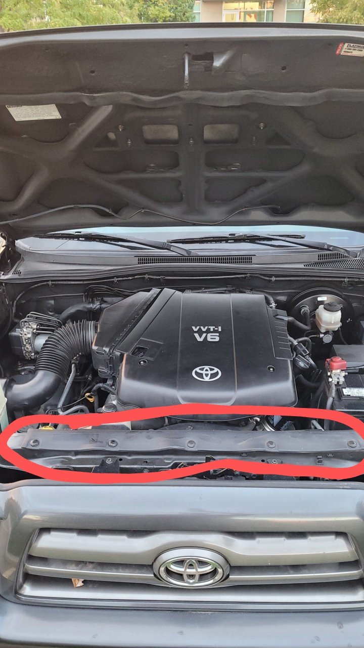

    This part on my truck has gone 'wavey'. Assuming others have the same issue? Anyone know the part number? 16631112121896436787768807301973~2.jpg

    Never saw that happen before, did your truck overheat in the past? I wouldn’t worry too much about replacing it

    Part number is on the bottom side

    No, never over heated. I'm the original owner. Maybe just getting a few wrinkles with age. Purlely cosmetic reasons for wanting to replace it, as long as part cost is reasonable.

    Thanks. I'll pull it off and have a look.

    Here, save you some time
    53292-04020

    I have that part off right now as I just replaced the water pump and radiator. It looks good without it, and I like that I can see between the condenser and radiator - I would have seen the plastic bag stuck on the outgoing radiator that was somehow sucked in there. I am inclined to leave it off.
    Edit: now that I think about it, I believe there is a second cover going over the opening. Regardless, engine bay looks good to me without those parts.

    Note the adjacent wavy/warped rubber seal on the hood's underside, which reminds me of this thread from last year: https://www.tacomaworld.com/threads/adhesive-for-reattaching-rubber-hood-seal.743308/
    From the little bit that I can tell in the pic for a 12 year old Canadian truck your engine bay looks pretty mint, so I'm curious if you treat your truck with any type of rust inhibitor like Fluid Film, etc.? Reason I ask is if you check out that thread I referenced it appeared as if the Fluid Film potentially caused the OP's seal to warp, so I'm wondering if you possibly have something similar going on here? :notsure:

    Great call! Sprayed annually at Krown. Funny, both parts you marked are the only ones that show any type of damage. If caused by the Krown spray, which I suspect it is based on the other link you provided, it's a minor issue relative to the rust protection benefit.
