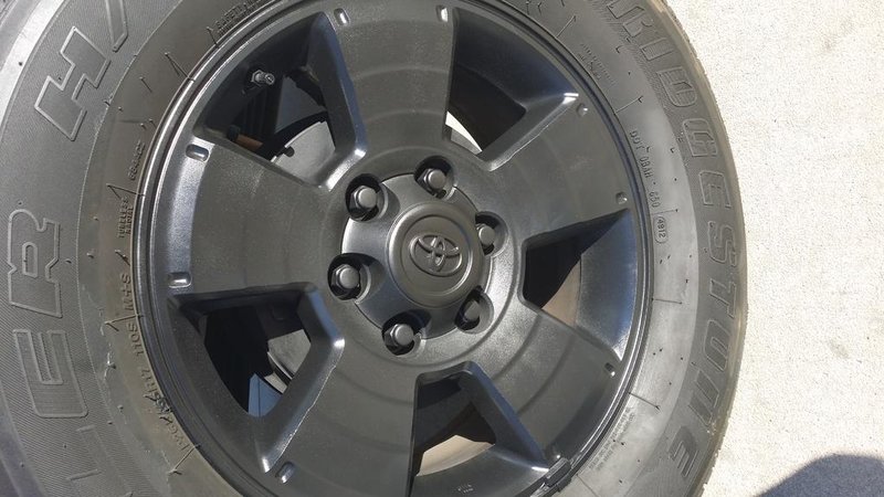

    Hey guys so I derp'd my rims, but I really want to have the chrome Toyota logo show through. My problem is that everytime I try to peel the chrome off the logo, some of the derp comes of in places that I don't want (eg. the holes in between the toyota logo) and I keep having to respray and try again.
    I have tried a toothpick and xacto knife but it just doesn't seem to help in the smaller holes in between the logo.
    Anyone have any luck with this? Thanks!

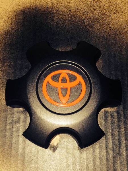

    Hope this image works....Anyways the plastic logo tabs will break off but the logo can simply be glued back on. Just did mine last week.
