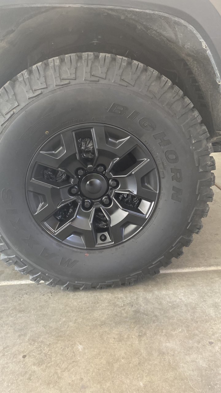

    Did u leave wheels on if so did u use cards to block the tires and trash brakes for brakes I have seen it done that way before

    I did this while the wheels were off when a shop was installing my lift and I did use a deck of cards with 1 can of dip per wheel.

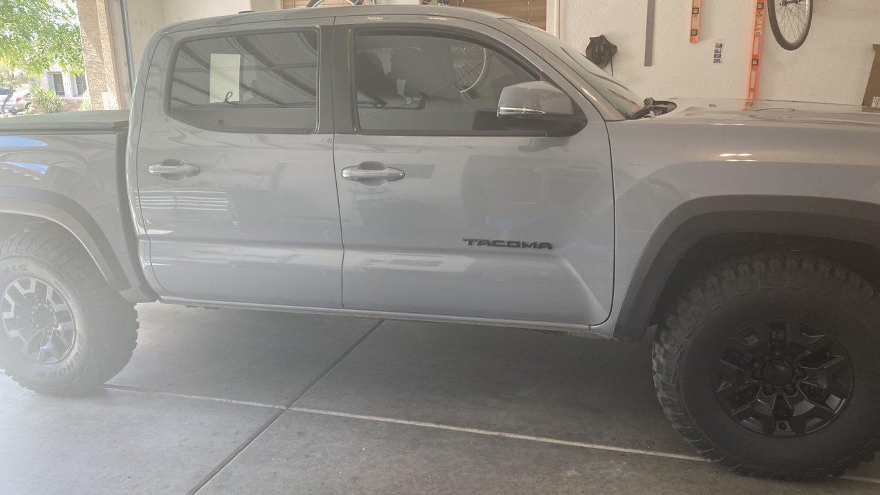

    I just did mine today too. Very very happy with the results
    Thats how i did it. Trash bags behind the wheel and cards around the rim to block overspray

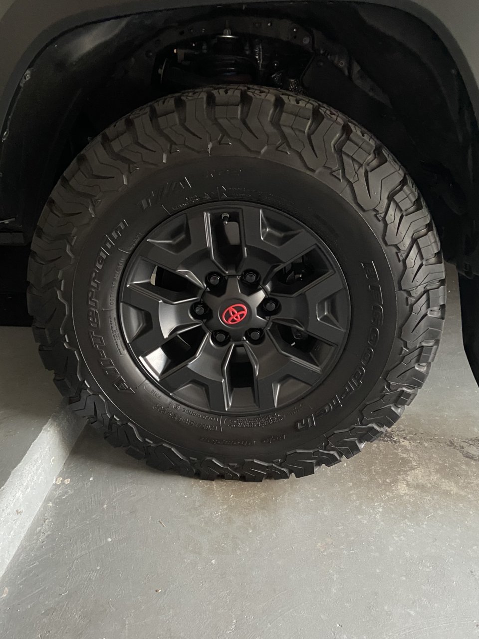

    So far holding up well.

    How did you get the emblem red ? That looks unreal

    Red plastidip. I had about 4 coats of black and was bored so tried about 6 coats of red. They pop out of the centers so pretty easy to do.

    Was going to powder coat so tried this first to see if I liked it. Wish a little bit glossier but probably gonna leave like this. As long as do t peel off.
    shane100700 and GillyLink like this.

    Did mine with plastic bags behind the wheel and 3x5 cards.
