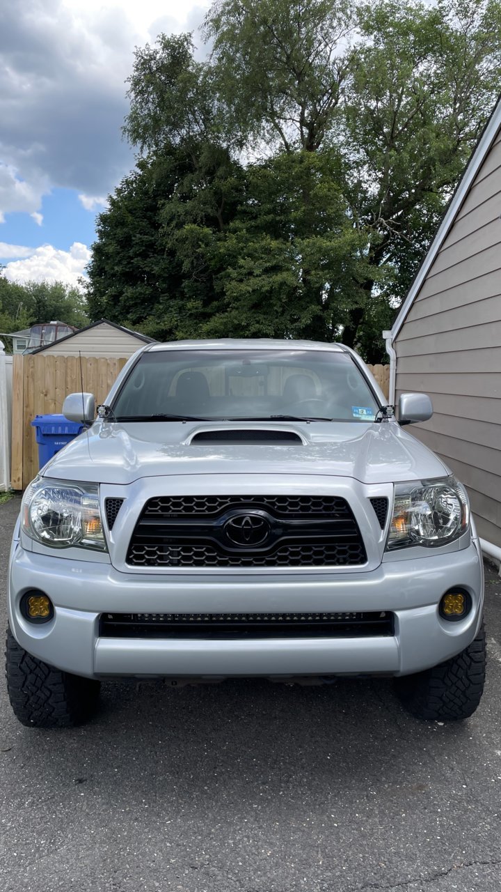

    baja squadron pros
    I tried plasti dipping my emblem and idid get alot of little chips from the road. The plastic chrome is a wierd surface to adhere to. You could always find a black or non painted grill on ebay or Amazon pretty reasonably. I hate chrome so i got a color matched grille and painted the emblem with duplicolor black and cleared over it0EBEE194-5FC6-422F-8087-B63CF3EC3EDE.jpg
