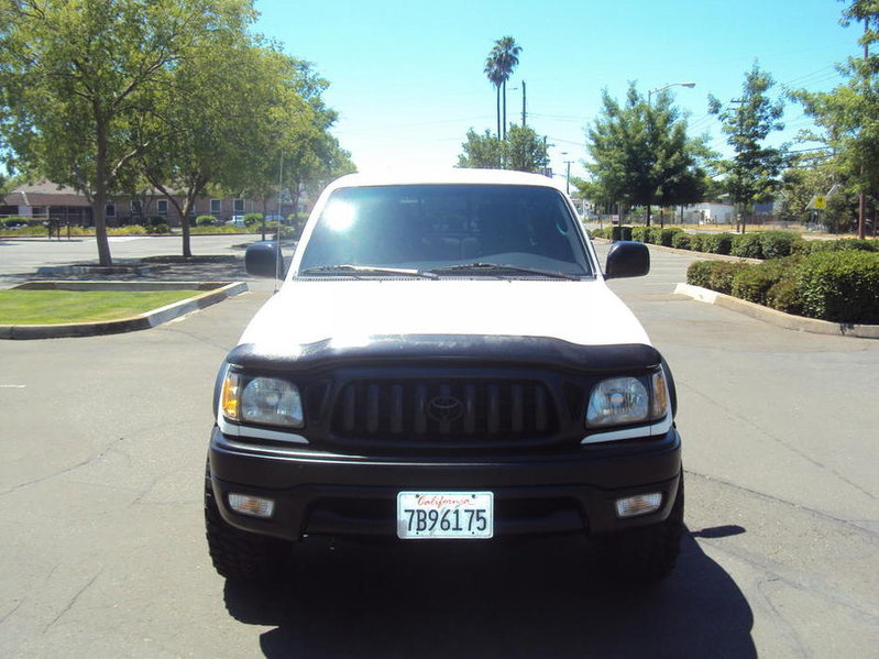

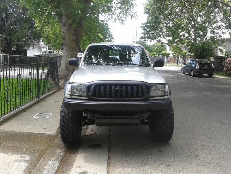

    Too many, See Build
    bedliner :cool:
    Did it to both my trucks

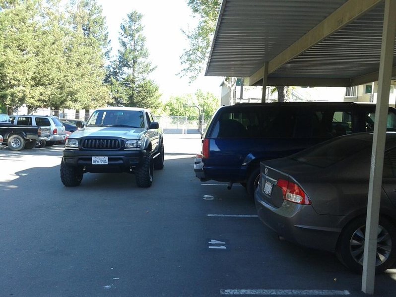

    no no no...I had that drop in bedliner in both the pee-runner and the new truck (silver one). here's what I did with the trucks
    pee-runner (white one) :
    I had originally sprayed it with that undercoating stuff (grill, bumpers, and flares). big mistake because the finish was horrible. I ended up spraying over it with bedliner, then with satin black. Held up great for the 8 months that I had the truck. My only problem was that I masked everything and sprayed things while they were on the truck so i had some overspray :(
    On the 4x4 (silver truck):
    I took everythin off except the bumpers and sprayed with bedliner. Well, a couple of wheeling trips and it started chipping, mostly the front. The flares were great, had no issues at all. So what I decided to do was sand a bit, re-spray the front and rear bumpers with plastidip, then bedliner, then sating black. It has held up great so far. No chips at all. I now havea trail gear front bumper and that i just sprayed with bedliner, then satin black so it matches everything. Its really not hard at all to take off the flares, and it reduces the chances of overspray.
