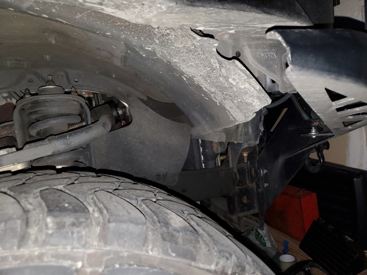

    No problems. Here is a quick pic of mine.

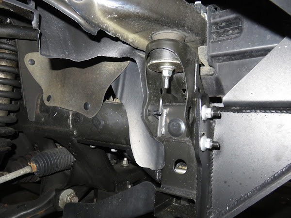

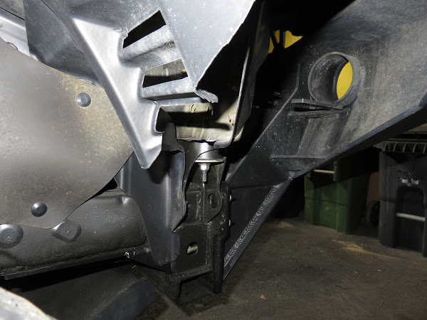

    Trim it to the profile of the radiator/headlight support, then secure it to the body mount bracket with a large plastic washer and push-clip:
    g8MTTPilBkdtC-BtttD-7wjarwkkhmLFNXcHYtL8_908faf71866dbf2a6d355d3e579b435a2ec7f69e.jpg XcVjZZZ9fyGrij5UQq6OYRE2Hnwk4kg0Adw9OEhZ_af9eada3b4ed691665a4d0922ad39df6b1d68dee.jpg
    Tucking the liner into the plate bumper also works. However, it will rub off the powder coat on the contact edge down to bare metal.
