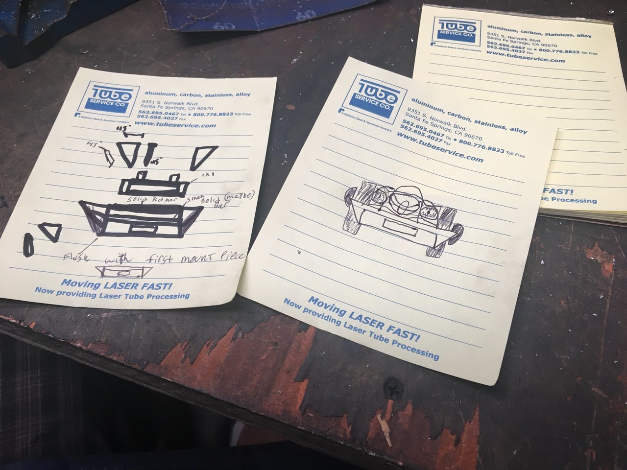

    My attempt at throwing ideas around to how I could build a bumper with tubes and then just use sheet metal to fill it in and have it sent out for sand blasting and powder coat,
    I really have no idea what I'm doing, I'll start measuring at lunch and maybe start the first part, please If someone has a idea of who would sell one for a good price still let me know ,

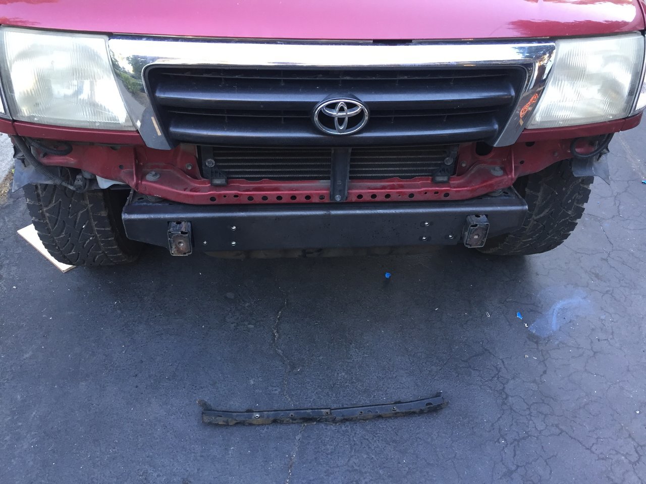

    I don't have a pic of the rear but here's what it looks like mounted, fits right over the frame and comes with mounting bracket for the skid plate.

    Interesting idea to have the frame rails go through the mounting plate, those rails on my truck where you took off the bash bar, mine are bent I wonder if that would still work or if it's to tweaked I might as well build my own that'll fit with my taco'd taco

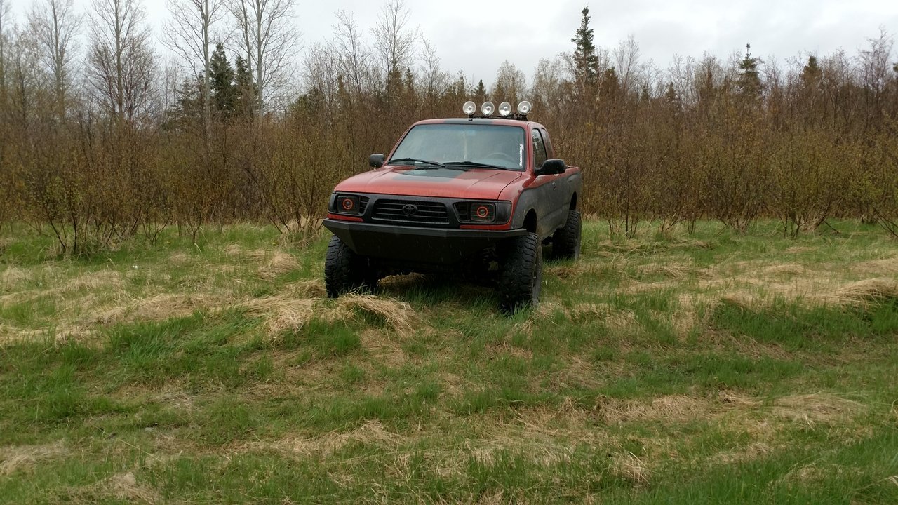

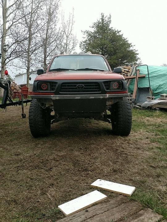

    All the pics I have were in the link above, I started out with building a shelf, all my plate was cut out with a cutting disc and slowly ground down to a straight line with a flap disc, it took forever!

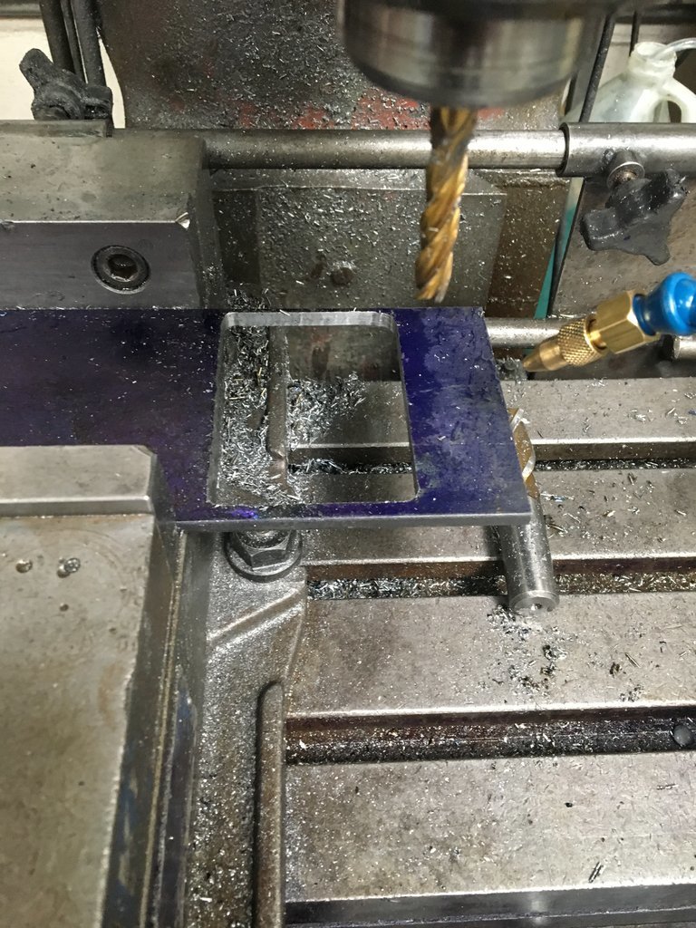

    IMG_0949.jpg For me the worst part is i can't just run out and check if my piece I've made fits right then and there, I gotta wait till lunch to make changes, I got exited and whent to buy a rifle before I started this project :infantry:
    I have finished on both ends, I'm going to see if Im god and cut it correct the first time in about an hour ​

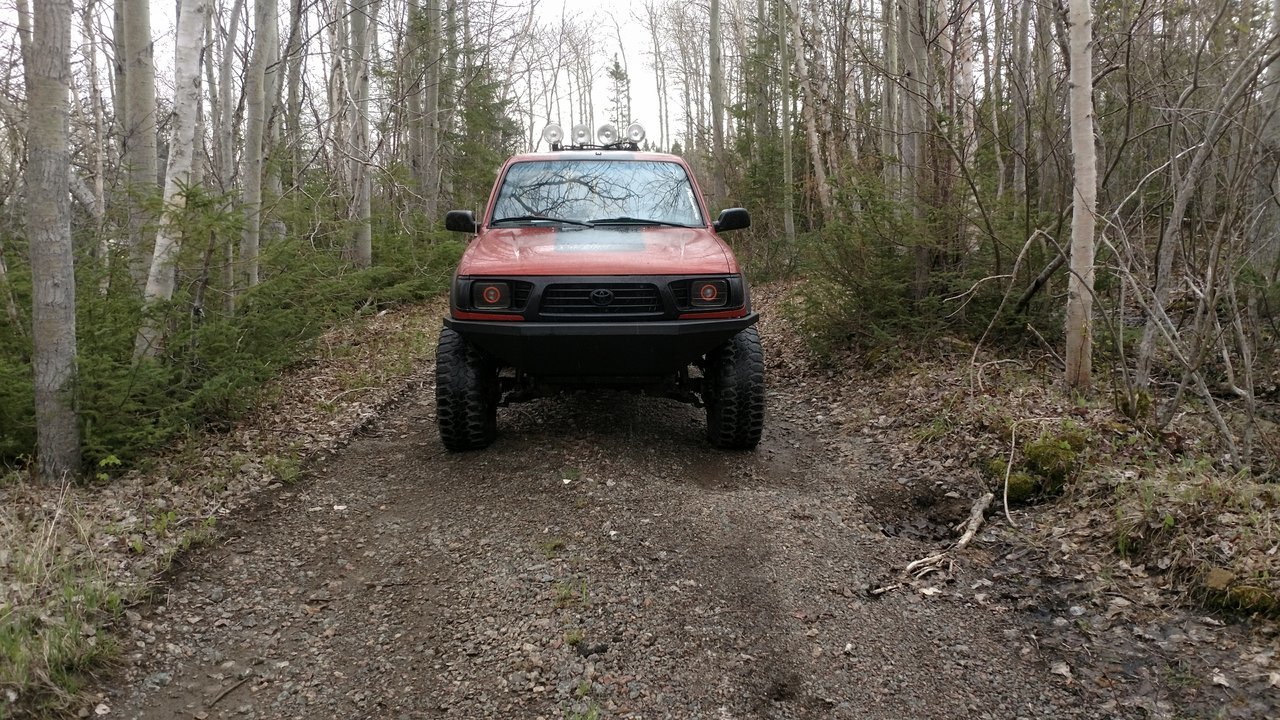

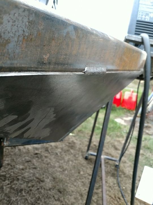

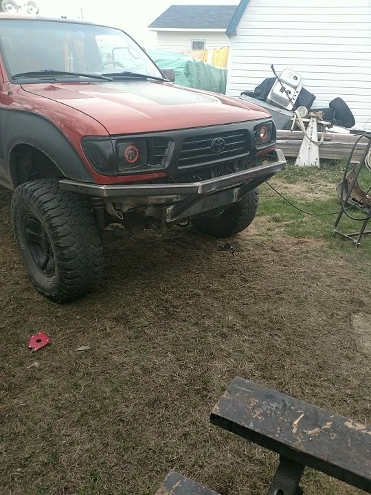

    if it gives you any ideas o started off making a frame out of 2x2 3/16" first with 1/4" mounts. i plated over after with the plating flush to edge. i left room for winch plate when i get one.
