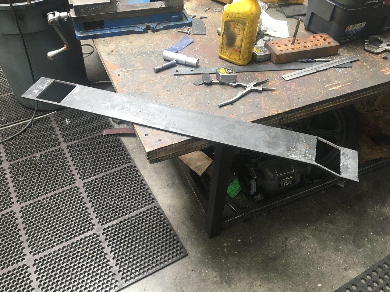

    Fucken so close to being perfect then the drill decides to tweak my whole piece IMG_0957.jpg

    Ah, that sucks. You gonna just straighten it out right? Doesn't look bent enough to cause structural integrity issues when you bend it back.

    Nah I just threw it at the floor and it straightened itself out it's just the fact it broke my second drill and I still need to cut more I think, I'll wait till I can moc it up to destroy more shit, I'm welding this onto my frame and boxing it around the rails, this is going to be the strongest part of the truck, it'll rip the frame out from under the cab before it crunches..... hopefully

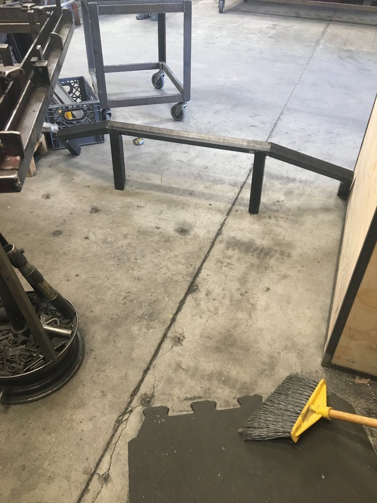

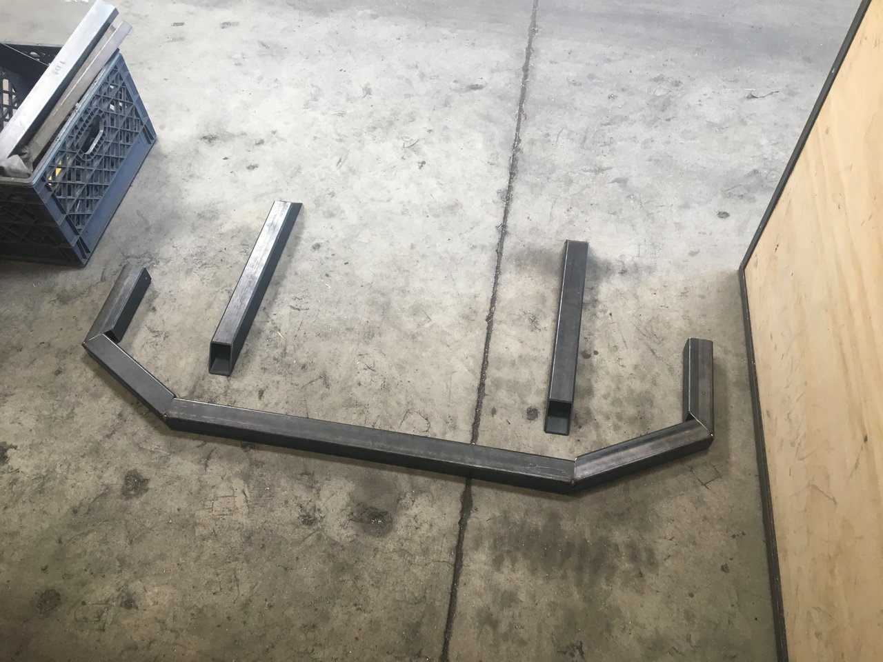

    IMG_0967.jpg Started welding, will see if it fits at home and if 45 degree angles are to much for the plate to the new bumper bar IMG_0968.jpg

    Pretty sure I figured out the angles I only asked cause I was at work bored waiting to go measure

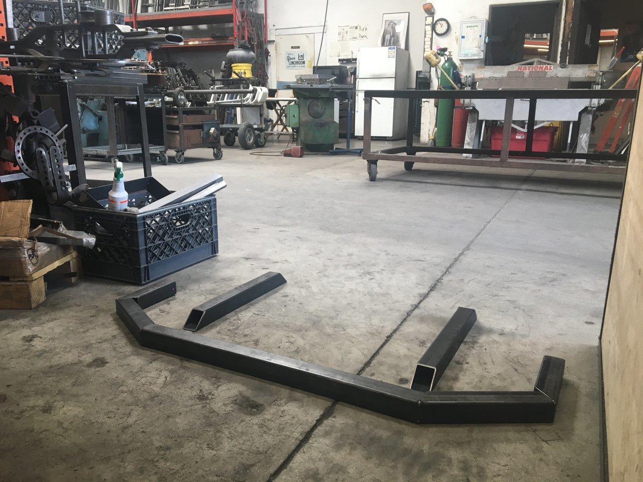

    Fox 2.5’s up front, icon 2.0 rear shocks, stock leafs, !Meso map and dome lights make all the difference in the world!
    Whent home and nothing really lined up correctly as would be expected from not running out to take measurements and fitment, so I made a new one with longer sides and shorter mounting points
    Going to see how it works right now,
