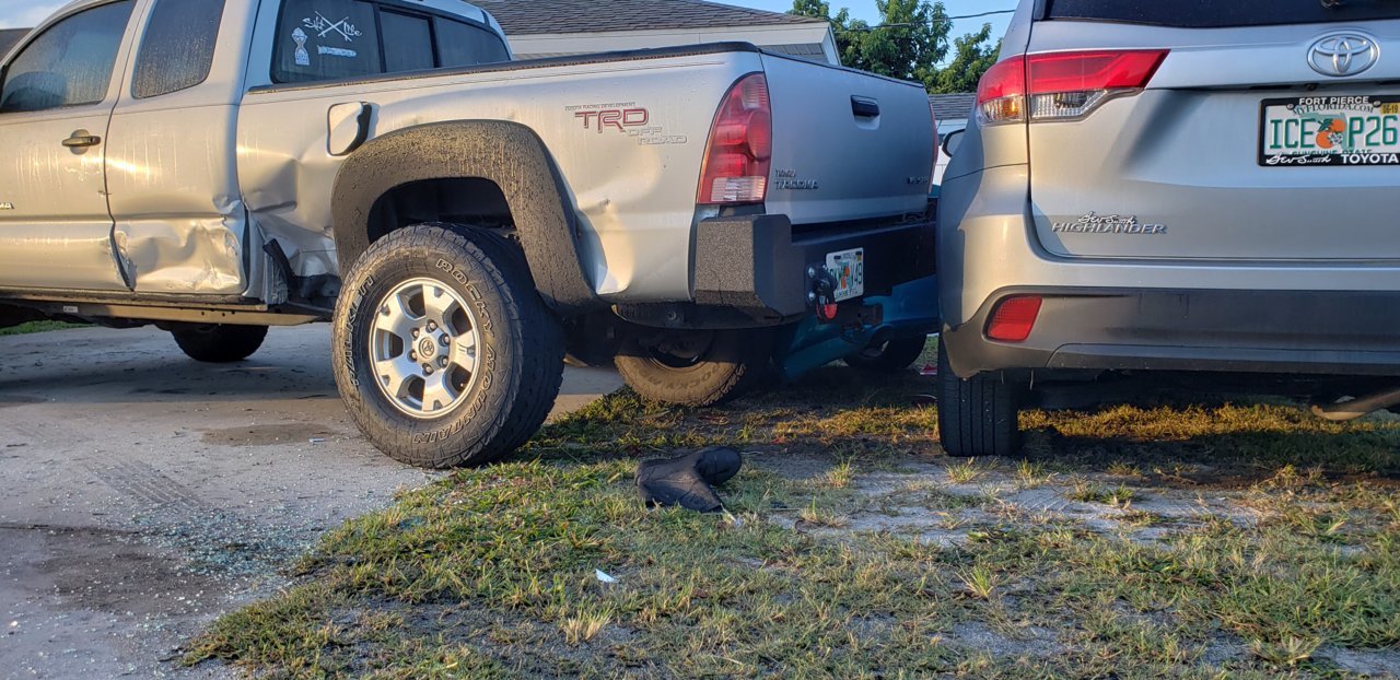

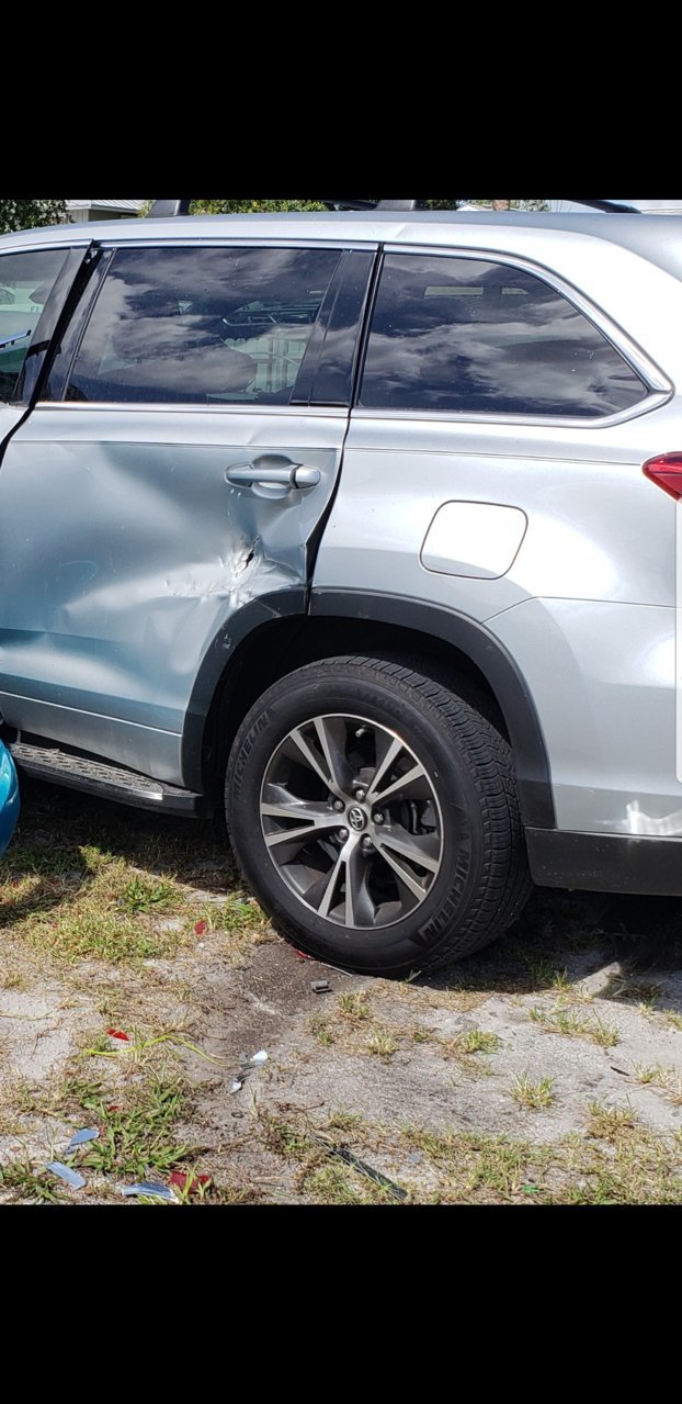

    Well just found this thread and am kinda happy I did. Had a 2006 4x4 Offroad ACLB Manual for a long time. Loved that truck to death until a drunk driver hit it at 60 while it was parked in my driveway. May she rest in-piece.
    3 weeks BEFORE this happened I installed a Body Armor 4x4 Black Steel Bumper.
    No photo of the bumper later, but I can attest there was barely a scratch and no dents whatsoever. Crumpled the side of my inlaws car.
    If the photo is confusing, the drunk hit my left side and slammed my taco into my wife's car (cant see it) and then into my in-laws highlander.
