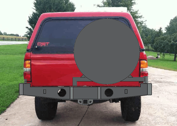

    Here it is boys! The tire carrier. This was a quick mock up. It will have a latch on the left end, 1000 lb spindle hinge on the right. Will fit a 35" tire or bigger if you're a badass. I'm a little concerned about covering up the taillights.

    What if you located the left side latch no further out to the left than the left side of the tire is. That would make the arc smaller and maybe less annoying to swing out when needed. To follow the closer to the passenger side theme offset the whole unit to the right. This might combat the infamous Tacoma lean, make for a smaller swing out arc, slightly less material usage, less cantilevered weight on your hinge and give better visibility in the rear view mirror.

    Might need to revise this over a beer this weekend...
    I like where you're going, but the main issue is the tailgate would hit the bumper if there was any sort of raised latch or bracket on the bumper between the raised ends. Maybe if I do a drop-in hinge pin so there's just a hole you drop the pin into on the top of the bumper. Hmmm...

    I was thinking a vertical spring loaded pin as well.
    Beer always gets the creative juices flowing, after all it made Bud wiser. haha

    sorry... wasn't on to defend my previous post but yes.. just the outside edges but I am totally in love with the second bumper!!!! that looks great!

    Here's the design that xcmtb83 headed toward. It would use a spring pin on the left directly into the bumper. Simpler and could be done for $275 probably.
    33" tire.
