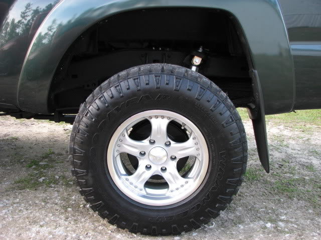

    Looks great... but I have access to the plating cheaper than even buying the paint. Like I said, the paint will only last so long anyways.
