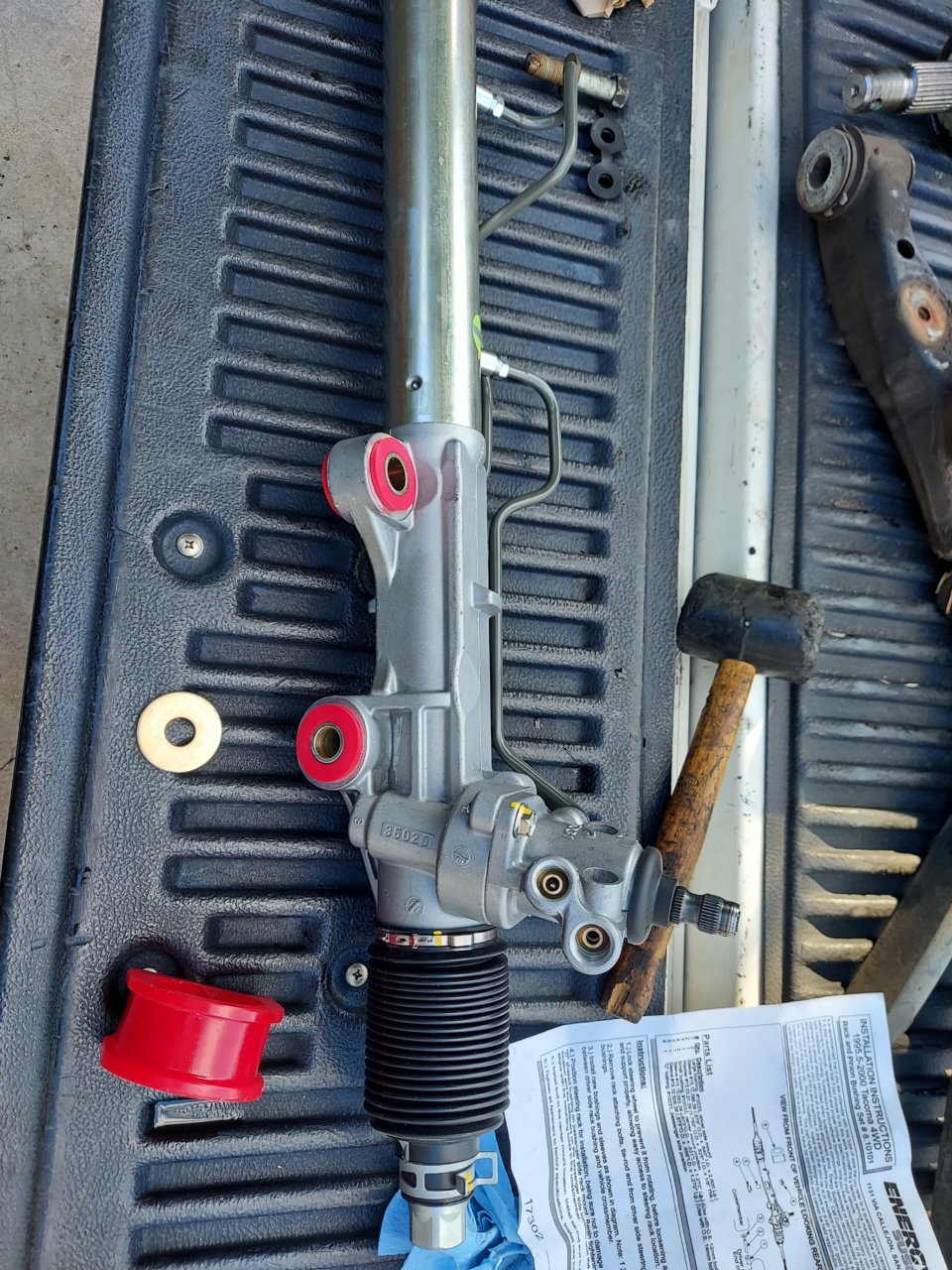

    I installed a new oem rack for a TW member and the rack was moving like a full inch side to side. The last 2 racks I've recommended the energy suspension steering rack bushings. Cheap and they really make the rack stay still during operation.
    Either video tape it or have someone watch the rack under the truck while you turn the steering wheel back and forth. If the whole rack moves replace with the energy suspension kit.

    It is a cheap chinese rack I ordered off ebay,it came with with all the bushings you are showing in last pic.I know I get what I pay for,but at the time didn't have $500 to drop on a rack.The rack is not moving,I will make a video of where I'm turning with my hand.I also put a new rag joint assembly when I installed the rack in.The one pictured also.
